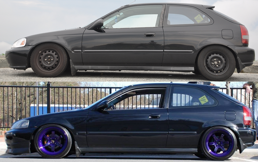

I always find it difficult to envison what a certain drop stated in inches comes down to (lol) in actual height to the poster stating it. In my experience (EDM hatches) our stock Honda's come -after all this time- with different stock heigths ánd they are rather high: my two EK hatches easily came with 'three fingers' or 2.2" fendergaps.
Originally Posted by B serious
... I would recommend 500LB springs at the least, up front
I'm sporting GC coils, hats, bumpstops and OTS Yellows with standard rates 325 up front and 'one finger' or .8" fendergap with a 195/50/15 and new tires (.2" higher grooves compared to old). I think I have one inch free travel to the bumpstop. Definitely not hitting shock towers. I imagine worst scenario I'm touching the bumstops in fast or tight turns.
Stock
Lowered to 'one finger' (the EK Vic)
Stock
You lowered the car what looks to be 1.5 to 2". If you left the stock bumpstop in the stock location, you'd be riding on it.
You switched to an extended hat with, I assume a shortened bumpstop? It had to be shortened to put you at 1" of free travel, unless the hat extends further than I remember.
Your UCA hasn't hit the tower likely because you just haven't hit a bump large enough...yet.
Its been a while since I worked on an EK. On my DC2 ITR, there did not appear to be anywhere near the amount of room you're describing.

It's a one-inch GC extended top hat and GC bumpstop (think it's 5cms long).

You lowered the car what looks to be 1.5 to 2". If you left the stock bumpstop in the stock location, you'd be riding on it. You switched to an extended hat with, I assume a shortened bumpstop? It had to be shortened to put you at 1" of free travel, unless the hat extends further than I remember. Your UCA hasn't hit the tower likely because you just haven't hit a bump large enough...yet. Its been a while since I worked on an EK. On my DC2 ITR, there did not appear to be anywhere near the amount of room you're describing.
So I got round to taking a look at the amount of free damper travel. It looks to me to be 0.8 to 1 inch. Bumpstops are GCs 2 or 2,2 inch length. Viewers may remark the bumpstops seem ridden on, this would have been true in my previous setup with same ride height, stock top hats and lowering springs.
