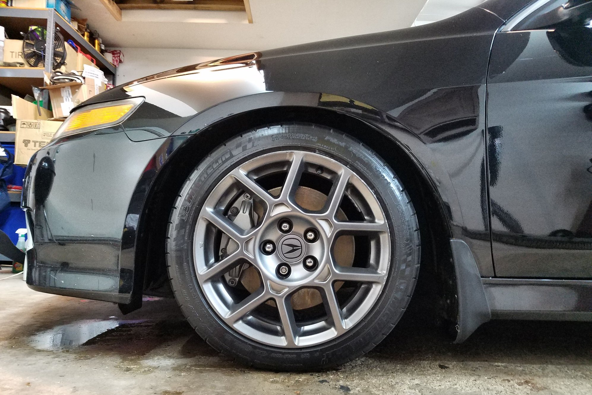

Mine is my DD as well. About 13.25" from hub centre to fender lip. So...I guess its probably pretty dang low (for a 1G TSX).

No worries. I've been on track twice in this car, once completely stock, with b.s. used car lot tires on it (SCCA track night), the other at a time attack with the Flexes and same Chinese tires. Tires were awful, and I ruined them. Despite being basically unmodded, the TSX feels much stiffer than the fairly well modded EG coupe I used to have. I wanted a daily I could occasionally track, and this car I think will fit the bill nicely.
Do you have a build thread? What callipers are those?

No build thread. Its modded a little bit. I kinda want to buy a ASP3 trans for it in summer.
The calipers are JDM legend (similar to Acura RL), with 12.8" Nissan 350Z rotors.
They're great cars. Mine has like 166K in those photos (and currently)
