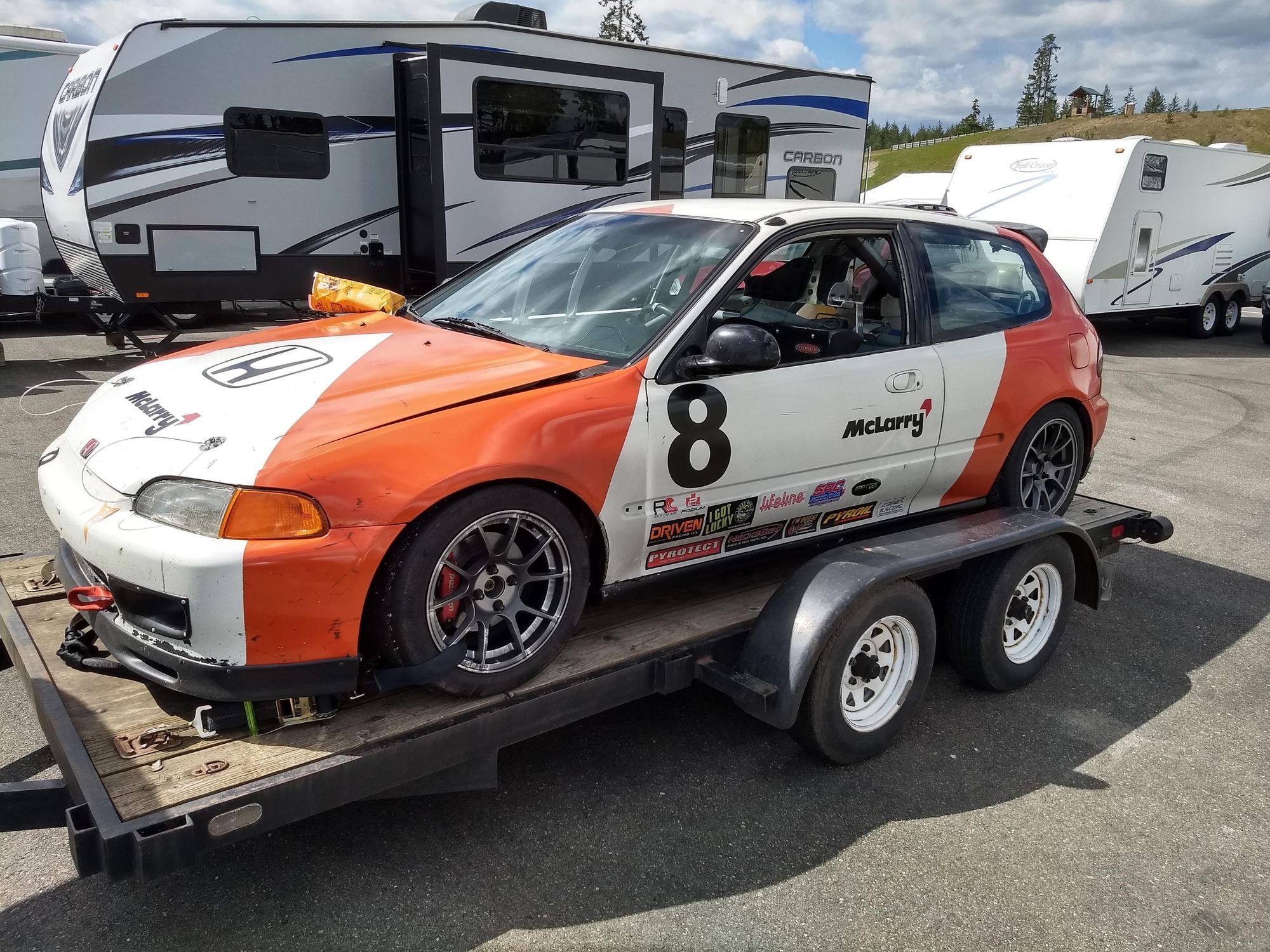

This is a 14' x 6' steel trailer with a wood deck. I keep thinking I should weight it, but probably less than 1,200 lbs. It would be easy to add a tire rack to the front. The trailer has two 2x10 by 14' runners down both sides and 3/4" treated plywood in the middle. 3,500 lbs, 4" drop axles, 6' ramps. I had it made by a trailer fabrication company in the Portland Oregon area. Cost was about $1,200 (20 years ago).
I currently tow it with a Honda Pilot (17 mpg with car in tow). Have towed it with a few Pathfinders, a Frontier, Dakota R/T, and a Hyundai minivan.

Have you replaced the wood deck at all in 20 years? If not, that makes me want to consider the wood deck for the weight. Nice to see how the EG fits on a 14 foot trailer too, thanks! I think I will go with a 16 to fit the tire/fuel rack and have enough length to fab up the roof top tent rack.

I have replaced the plywood once. The 2x10's are original and still in good shape. They are pressure treated douglas fir.
I do run Air-Lift helper springs in the Pilot. Makes a huge difference.

That's good to know, I may just opt for the solid wood deck, the wood looks pretty good after 20 years. Do you store it outside? The one I am looking at is about 2080#s before adding the racks so probably ~2380 unloaded once I fab up the racks. The 4.7 4runner is good for 7K capacity so once its loaded with everything I should be around 5900-6000#s.

Yes, it has been stored outside for all those years. Some winters I have thrown a tarp over it, but probably only 3 or 4 winters that I have done that.
