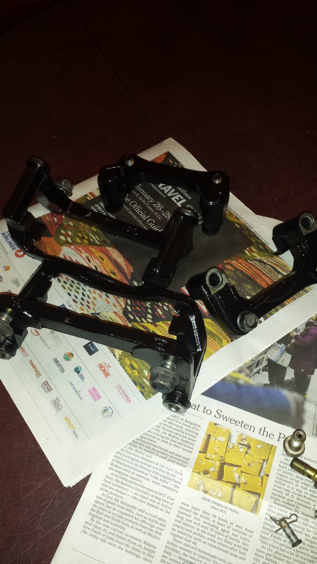

finally got it off. 2 days of on and off hammering finally broke it free. slowly making some progress..going to order a new rack and some other misc parts this week.
got these bushings installed and replaced the inner cage cage on the shifter (didnt get pics of that )
finishing up painting of the calipers and brackets
