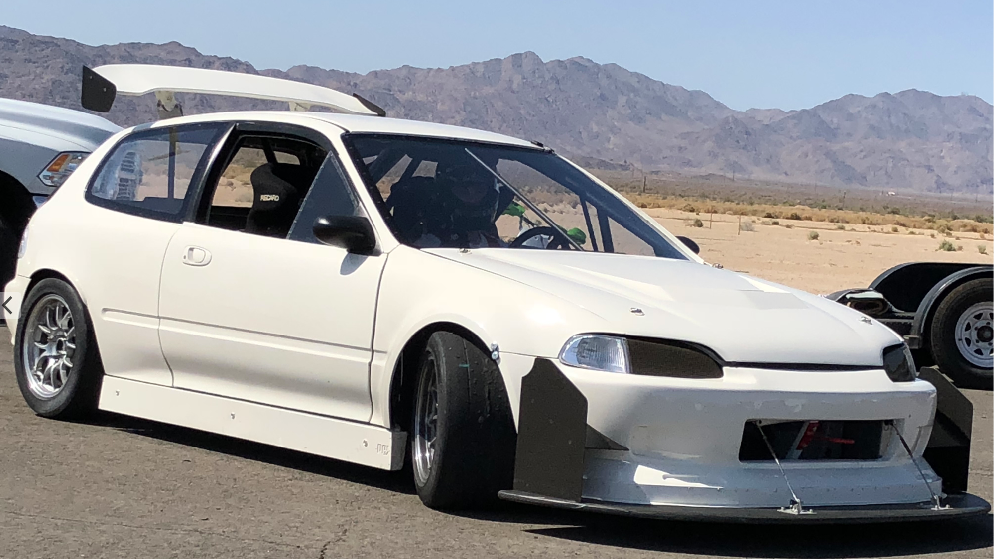

Looking for replacement Wheels for my EG race car. Currently has 949 Racing Wheels... 15x8 +36 on Rear and 15x10 +25 on Front. 949 did not make 15x10s on their latest production run and the 15x9s wont hold the 275/35/15 and the 15x11 are too wide. I was told Jongbloed Racing made similar sizes but when I contacted Phil's Tire Shop (I guess the exclusive dealer) they are not available from them. Wanted to get four fronts and four rears, but am at a dead end on finding anyone that makes these sizes. I guess I could consider customs but that would be an arm and a leg. Any advice or guidance greatly appreciated.... especially if you know where to locate up to four 949 Racing 15x10 +25 wheels. I included a pic of the car. It is a blast to drive on the track. Has a K20 swap and was set up with no expense spared. Bought it from a friend as is sits.

the konig dial in and the advanti storm both come in 15x9, a lot of 15x10's have dried up it seems.
hard to tell from the pic, but what tires are you using? and whats the rest of the setup suspension/power wise. maybe its an opportunity to try a slightly different setup

Running Hoosiers R7's 275/35/15 on front and 225/45/15 on back. Has coil overs with super stiff springs. Has a k20 swap and dynoed around 237hp and drives likes its on rails. The previous owner spent a ton of time dialing it in so was hoping to leverage off his work. The fronts have 10mm spacers (probably for clearance of the Wilwood bog brake kit) , the rear has 3mm spacers.
I'm relatively new to the Honda world so any advice is much appreciated.
