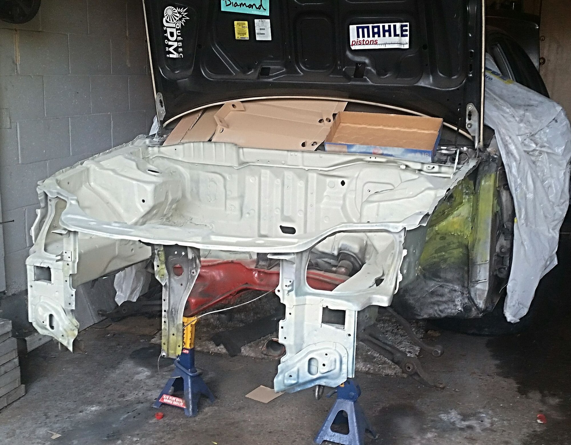

Firewall welded up!
The custom engine mount bracket

finally decided everything didn't need to be 100% straight as it was gonna screw up the paint sooner or later probably. rust removal has been done
​​​​​​​and the car is started too be reinforced and ready for paint
​​​​​​​​​​​​​​ Epoxy primered
Getting ready to filler
Bed linered
1 by 1 square tubing for reinforcement
Bondo in the bay
The tubing will be shaped like a fender brace I'll show completion soon

Quick update shall be finished the bay anytime now.
getting the engine back in and building backwards.
​​​​​​​and thank you! Are you dealing with rust like this also? Averyvm
Bed lined
Got the full fender brace welded on
I painted over the bed liner with a high durable rust paint too help also
Both sides of the car shall not flex anymore
More protection in a accident now too.
