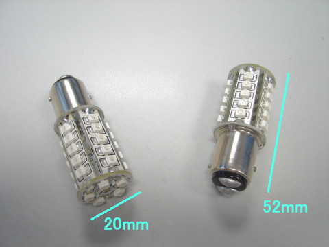

Anyone here used 'em or had a pair in the past. Few weeks ago, walking around SEMA, noticed a a bunch of Tawi Co. carrying these on their booths. Curious if anyone here has purchase any? If so, did the harness & plug burnout on you?
Here's a sample pic of what I'm talking about!

The wiring and harness should not be an issue, since LED's normally draw quite a bit less current than standard incandescents. The main problem with LED drop-in bulbs is that they do not disperse light in the same manner as the incandescent that they're replacing, so the normally do not properly illuminate the reflector. These appear to address that issue to a certain degree by placing the LED's in a cylindrical pattern as well as at the top of the bulb, but I'm still not certain they'll perform as well as a regular 1157 or 1156.

i have all LED bulbs in my EG.i had to go through quite a few sets to find ones that were brighter than stock,but i finally did.later i'll post info on the companies i found to have the brightest bulbs.

I've used several types of led bulbs and the tower units work the best... I'm currently using these bulbs and I'm happy with the output..
and it looked like this installed:
*daytime with running lights on and taken from a camera phone*
Each bulb will act differently depending on the housing, bulb design and the reflectors... MOST led's will get sun washed (over powered by direct sunlight), this is always an important thing to remember...
