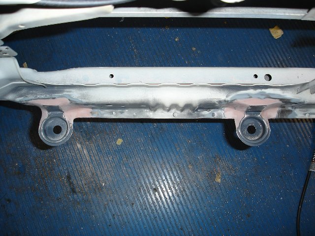

here's some good pics for the tranny mount that needs to be removed and how to install the new mount
dropping the motor
So you removed the B/D/H, cut the tranny mount, installed the new mounts, and dropped the motor.
What's next?

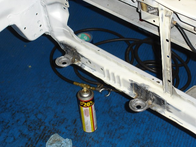

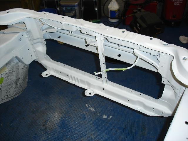

Well, before dropping the engine, most people relocated the radiator
[/QUOTE]

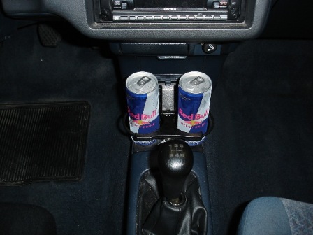

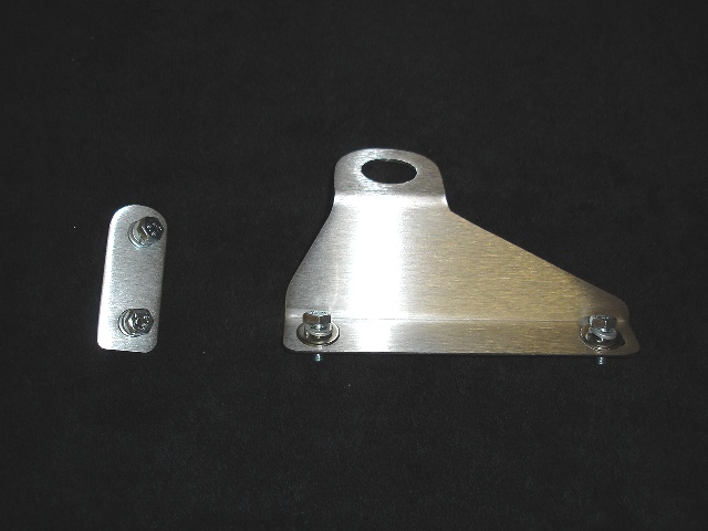

This is the shifter KIT I am using, from Karcepts.com
Shifter modifications (dimensions to cut will be provided in manual)
Simple template provided to help out
Grind the longer straight areas
Dremel the tight spots
Rear mount
Attaching rear mount
Attach cables to shifter, then attach shifter to mount w/ provided hardware
Cable cover plate
Attached cable cover plate
Damn, that's tight!
Like a glove...
Cable mounting bracket provided w/ rsx cables
You can pick up tapped holes in the bottom of the EG/DC crossmembers to mount the cable bracket (w/ EK crossmember, you will route cables above crossmember and not need anything but maybe a few tie wraps)
It's like Honda planned the cable routing this way.
Tons of clearance...
Finished product
Poor man's race car... Passenger gets the shaft... Pic was actually taken to show the centered shifter shaft (car is in neutral).
Red Bull anyone?
[/QUOTE]
The shifter kit retails for $175
any questions, just ask.

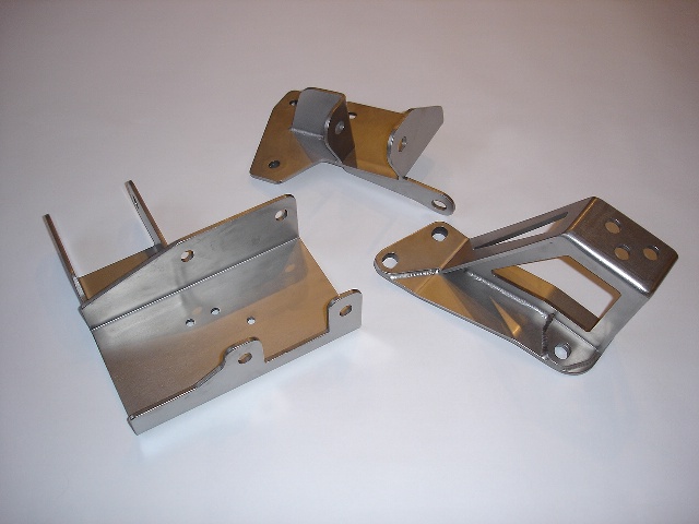

2)As far as which mounts to choose goes, which ones do you recommend and why? Making the motor sit as far and as high as possible is a concern, so which mounts do that the best?
hasport , hybrid racing and avid sell mounts. I cannot endorse one or the other for the a few reasons. These companies are sponsoring my car and my website so that would be kind of lame for me to come in here and do just that.
But I can say, that people that are using these mounts are satisfied. Since all the companies offer a lifetime warranty, there is really nothing to worry about as far as quality. Mounts play an important role but I understand your concern about clearance... but the angle of the axles is also very important. So you don;t want the motor to be too high. Clearance also depends on suspension and wheels so it all depends. I have seen good and bad clearance pics. That;s because some people like their cars dropped and some others don;t.
For my car, I am using hasport mounts because Brian G supported my website from day one, when I only had 10 users... lol So I felt that is the least I could do to express my gratitude for his help. On a CRX that a local guy donated to me, I might go with hybrid racing mounts so it doesn;t really matter as long as installation is easy and the material is good and the final outcome is acceptable.
I am also using stainless steel brackets for my hasport mounts. Not because the mild steel ones are not good enough... Just because I like the look of stainless steel. These brackets were also made by karcepts.com
So, yeah,, just do your research and get what you like best. These companies that sell these mounts have a huge liability in their hands... They would never risk selling mounts that would break on you while you are driving or something. Mounts do break though.. H22a, b series, K series have broken in the past and they were replaced ASAP.
