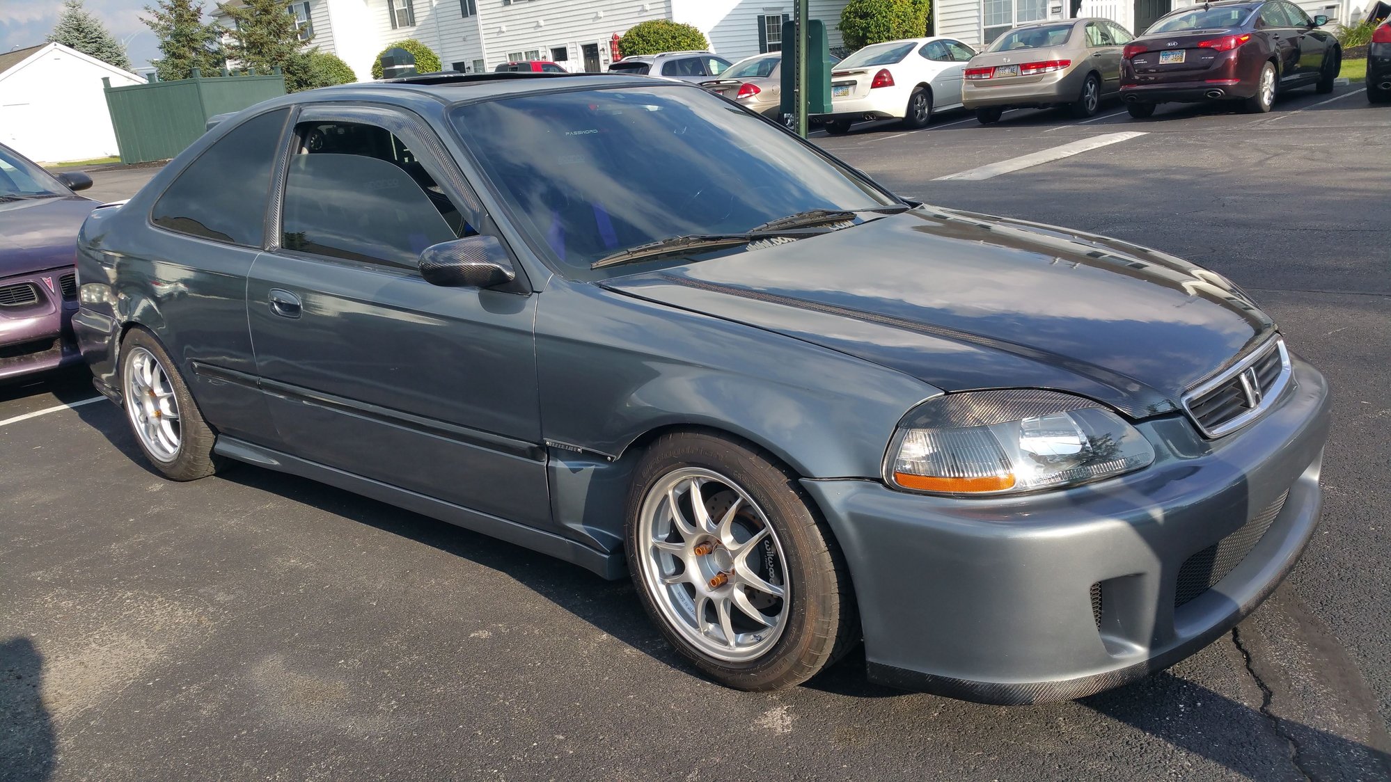

Hello, Ive been following the forum for a few years and been putting together a classy style civic build. We started with a Base 98 Civic ex D16y8 and transformed it into a very unique vehicle. The entire car was taken apart and put back together with replacing everything that was old and needed to be upgraded. I have only owned this car a little over a year and still haven't come close to having it finished. Well, here are some photos of the build, enjoy.

The doubled up tie bars in the rear looks silly.
What are the shoulder harness mounted to?

Blackworks Subframe brace with tie bar. The tie bar is more there for bling than anything. The Crow harnesses are mounted to a NRG Harness Bar.

Do not use those harnesses, you can be seriously injured or killed in even a low speed accident.
That harness bar is NOT designed to have harnesses mounted to it, and it will fold like a paperclip in an accident, and you will faceplant on that steering wheel.
Your factory 3 point belt is infinitely safer.
