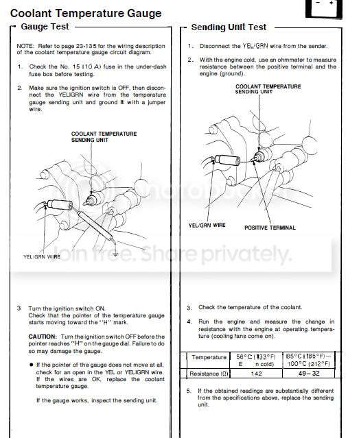

I recently swapped in 98 type r into my eg6 and the temp gauge doesn't work at all. The mph gauge works sometimes but it was acting up before the swap.
Should I just get a new gauge cluster or take it in to the shop?

Is your temp sending unit hooked up?
