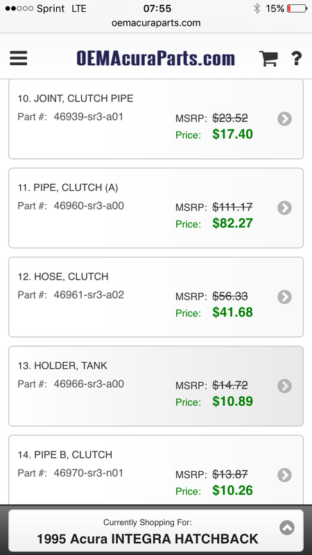

I'm looking to swap a OBDI B18C1 into my 1992 VX. Comparing the components of the clutch lines, I found only one difference in the two systems and that was the hard clutch slave line from the flexible line to the slave cylinder (#14).
Referencing the above diagram.

Since the SS clutch slave line is part #12, it should fit at least a 1992 Civic VX. However, looking at different Civic trim levels there is a different part number for #12.
For example a 1995 Honda Civic EX:
#12 - 46961-SR2-G01 <--Flexible clutch line.
So, while I don't understand what the difference is, there is something different. I would say find your trim level and compare the part number (#12) to that of the Integra (46961-SR3-A02) and if they match, purchase the SS clutch slave line.

The Integra and Type R both share the same part number for #12. I'm not sure why JHPUSA lists the SS clutch line as being different.
Try writing them an email or just give 'em a call.

How can a clutch slave line be chassis specific when it has nothing to do with the chassis? You've got an ITR engine in your EG. You should be able to use an ITR clutch slave line.
The only two factors are part numbers #19 and #14. That's what the line connects to. And since #14 is the line on the transmission you should already have that ITR part. That leaves only #19 to be different.
Compare you Civic's part number to that of an ITR, I'm sure they'll match.
As I said before, my VX and a 1995 GSR both share the same part number for the clutch slave line. For $30, I'd buy it.
