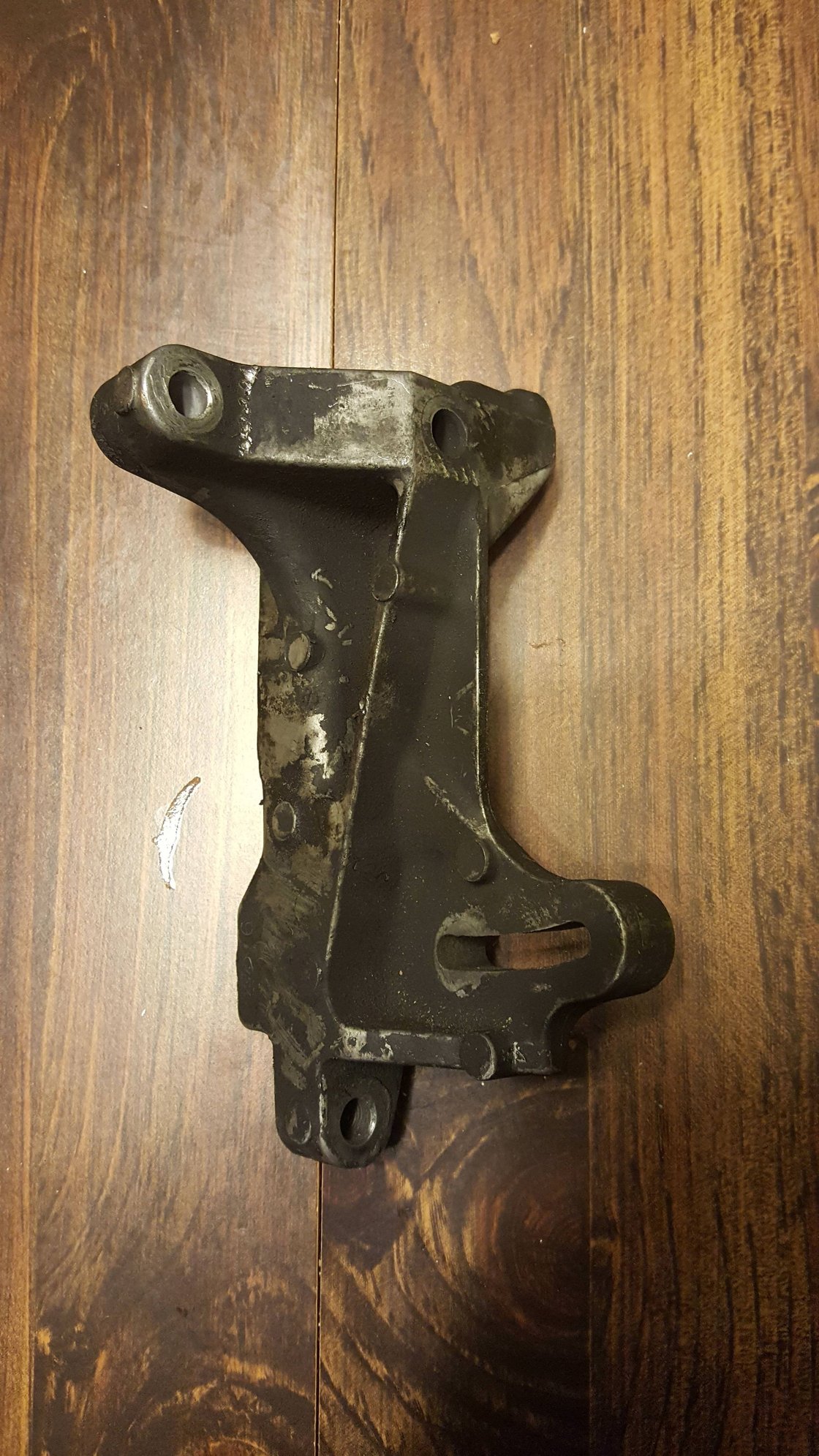

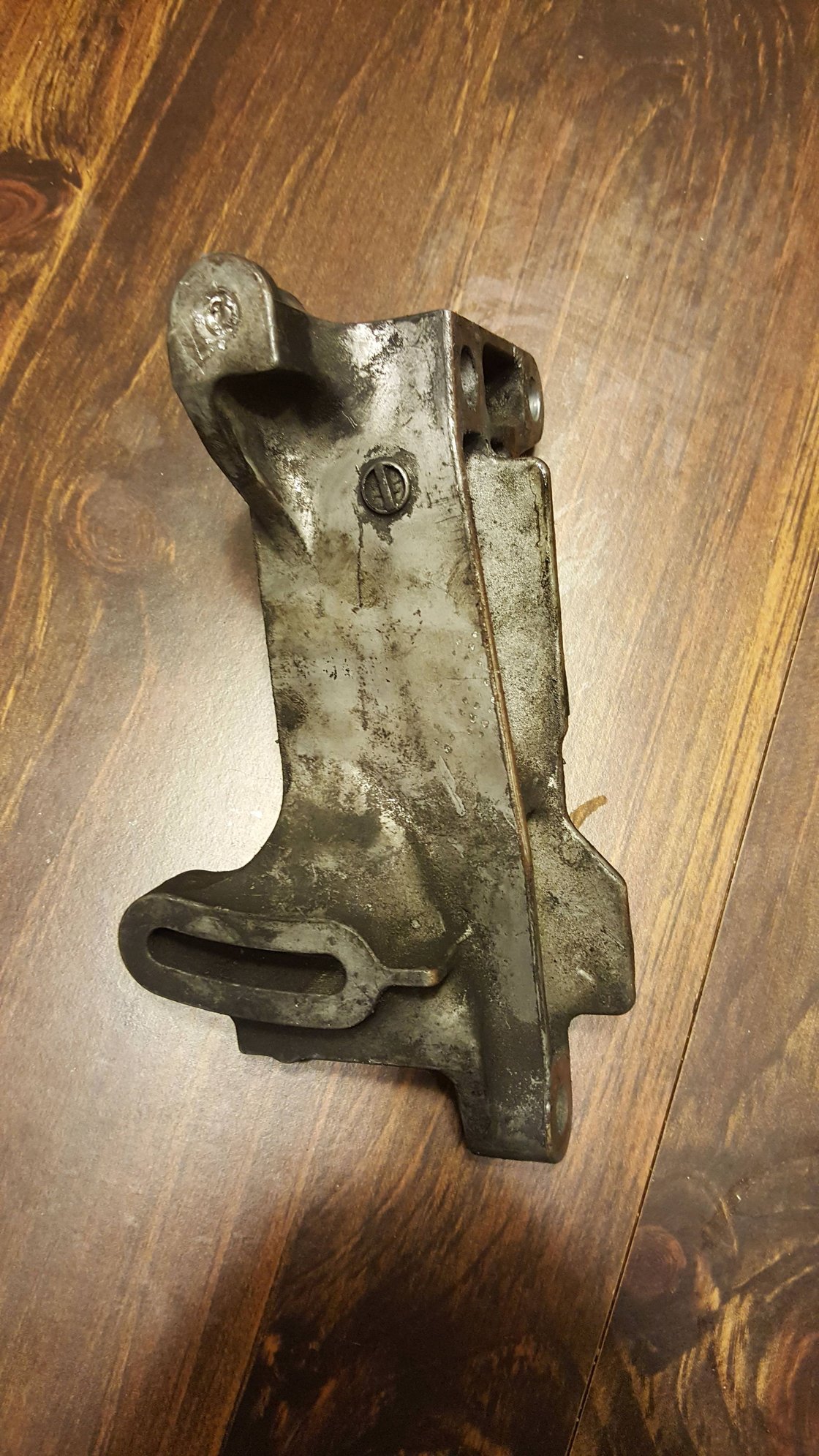

I need help identifying what power steering pump bracket I have. A bolt sheared off in it, and subsequently, the bolt extraction tool broke off in the sheared bolt. So I'm pretty well f**ked.
I have a 2000 Civic coupe with a 97 B18B1 LS swap. Previous owner did the swap, looks like they used the power steering pump that came with the Civic and found a bracket that fit the B18B1 to allow both to work together. Thing is, I've been Googling for a week, searching these forums, searching other forums, and I can't find this damn power steering pump bracket. The pictures reflect the orientation that it is mounted on the engine.
I'm either finding the B series power steering brackets that are two pieces, or D series brackets that are one piece, but have one bolt hole at the top and two at the bottom by the curved slot.
I'm guessing I can't just pull a D series bracket and mount it to a B series motor.

That is a 1997-2001 CRV P/S bracket... part number 56997-P3F-000.
