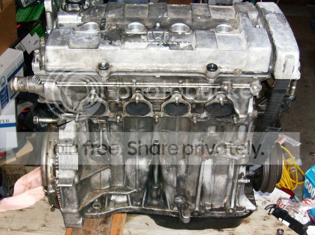

Hello, im michael and im 16.
This is my first swap, i bought my 97 honda civic ek, about a year ago.
And now im looking for more power so i found a 94 ls b18a1 cheap so i thought i would give a swap a try.
Im new to honda's so any help or tips on what to do and what not to do will help alot,
Thanks
this is the block.
Modified by B18a1 97 Ek at 9:00 PM 9/4/2008

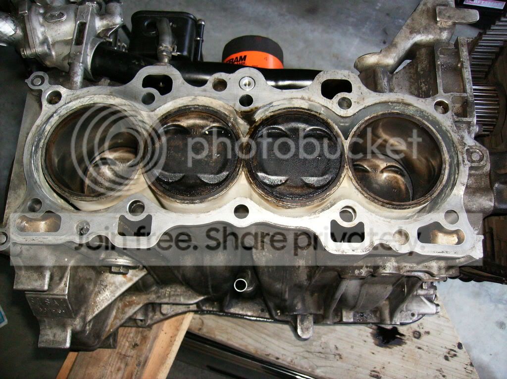

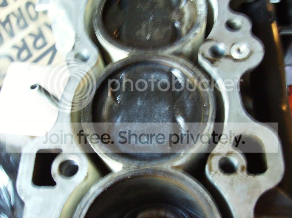

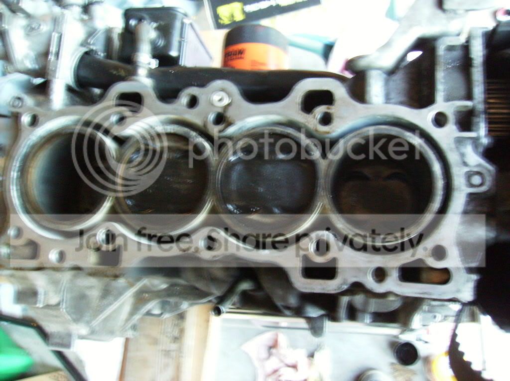

Ok, well i finaly got my pic's up... so tell me what you guys think. I was told this ls has about 100k on it, and for that matter do you think its in ok shape?...
Also the head gasket went out of it before i got it.. is that a big problem?

have the head and block checked

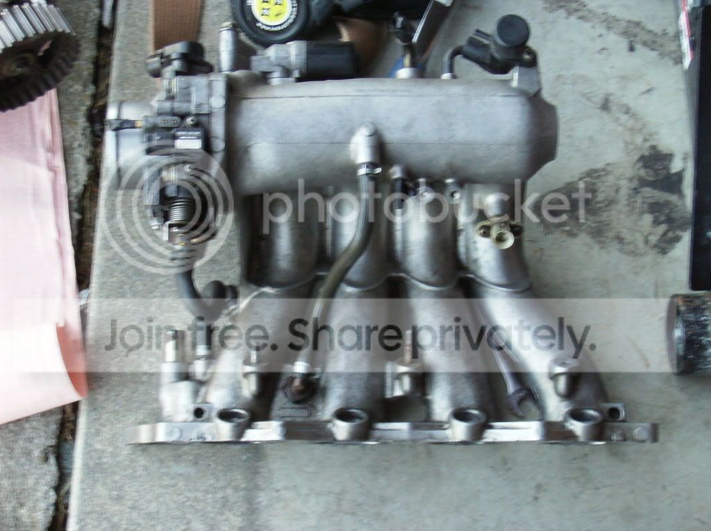

and that white sensor on the intake is the iat sensor

extend the iat and iavc sensor. Also you need to add a crank fluctuation sensor at the crank. since your keeping it obd2 there are few stupid sensors you have to leave.

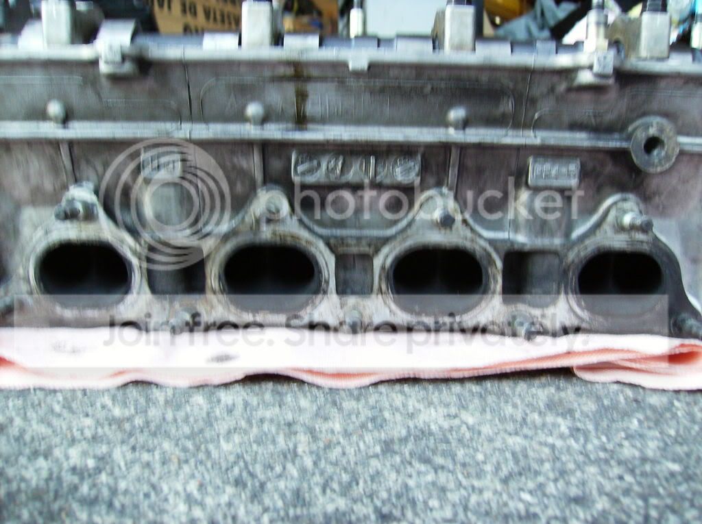

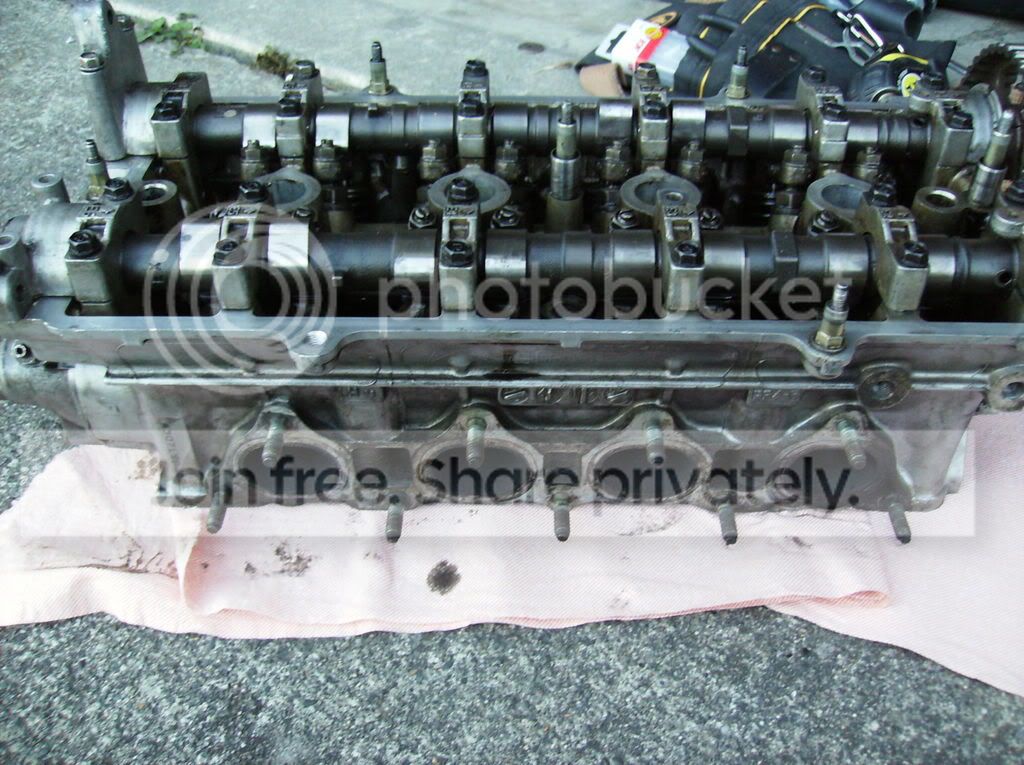

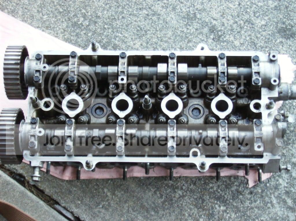

I was checking out my head, and i found a broken bolt in the cam cap. So i think im going to get a new head, any suggestions on what kind i should get? B16? B18c or what u guys think.
Thanks

The head all torqued down. Getting close

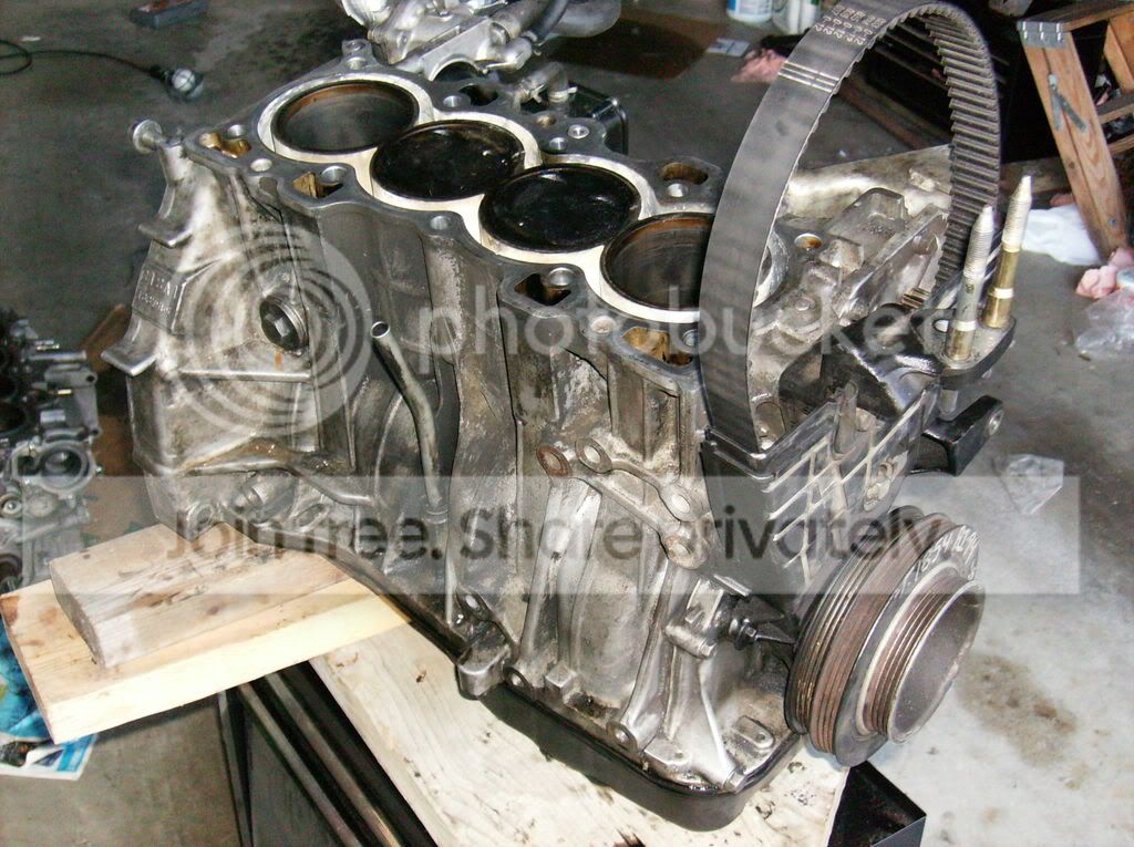

first get the motor and the head hot tanked, then i would have a machine shop at least re-hone the cylinders and get new bearings becasue that block looks beat, and also have the head gone through. have them replace valve seals and if you can afford it have them reseat the valves too. This should all be pretty cheap and will save you time and money later.
