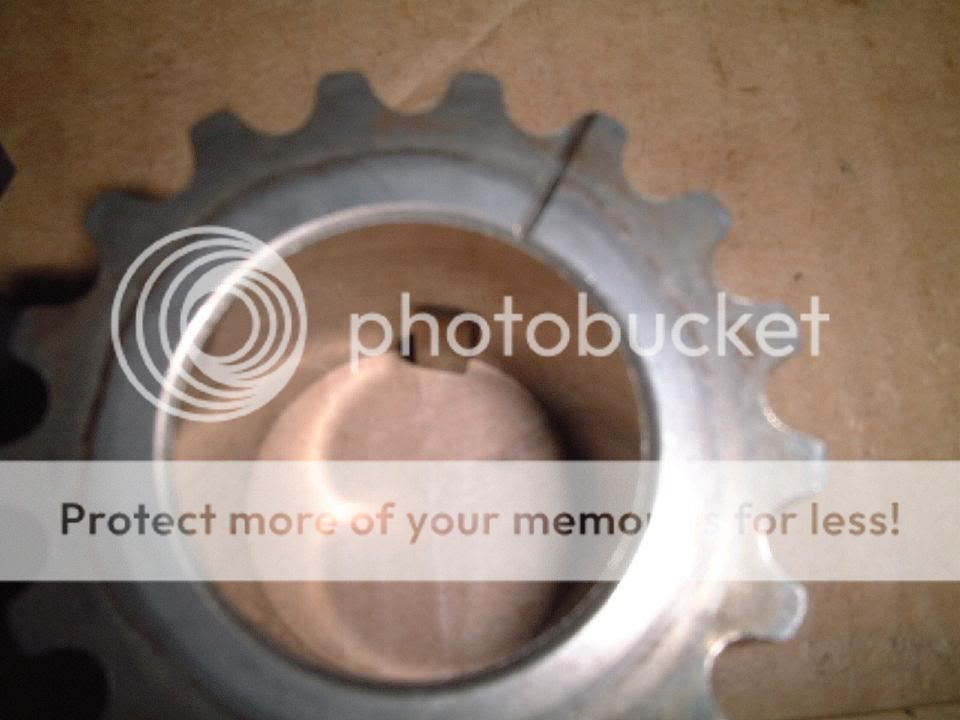

heres the two crank gears, notice one has teeth so the CKF sensor can read the crank fluctuation helps prevent detonation better
heres the jdm crank gear, notice the key is welded to the gear, you'll need a new key

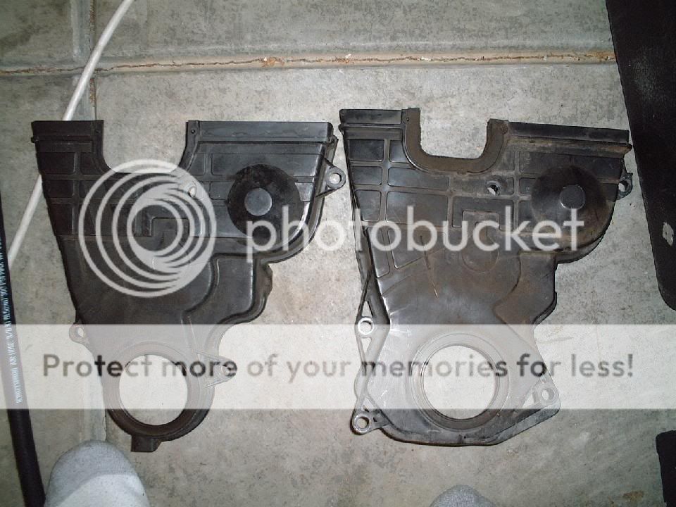

here you can see the difference between usdm and jdm lower timing belt covers, I think the jdm is equivalent to an obdI lower timing belt cover. The jdm unit is on the left
