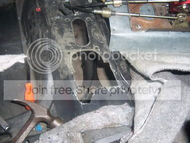

here ya go: here my eg sedan;

get your center console out, HOOK UP THE LINKAGE on the tranny, and place it where you want, on the exhaust tunnel any way! thats how i determined where to cut. . move the shifter from side to side to be sure the bulky thing won't hit the console, my nuespeed shifter kit, pictured above hit my console, good thing i don't use one any way!
