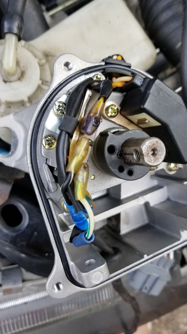

Opened the distributor and found this. Throwing Code 15. New distributor ordered.

On my ex-gf's turbocharged Civic EG coupe, I installed a MSD 6AL in it along with the SS blaster coil. MSD doesn't mention anything NOT hooking up the stock ignitor. Once I removed the stock ignitor, it cranked right up without issue. 3 months later, the damn SS blaster coil died while we were stopped at a traffic light. Had the car towed home and removed all the MSD crap off, reverted back to stock. Started right up. Honestly, I wouldn't touch any of MSD stuff ever again, not even their spark plug wires. THEY ARE GARBAGE.
I can see the butt splice connector in the pic. Make sure you solder the wire back and cover with heatshrink tubing. Get some NGK spark plug wires. Always had great results with them.
From what I recall, JDM H22s are internal coils. Just double-check for the correct ignition spark plug wires.
