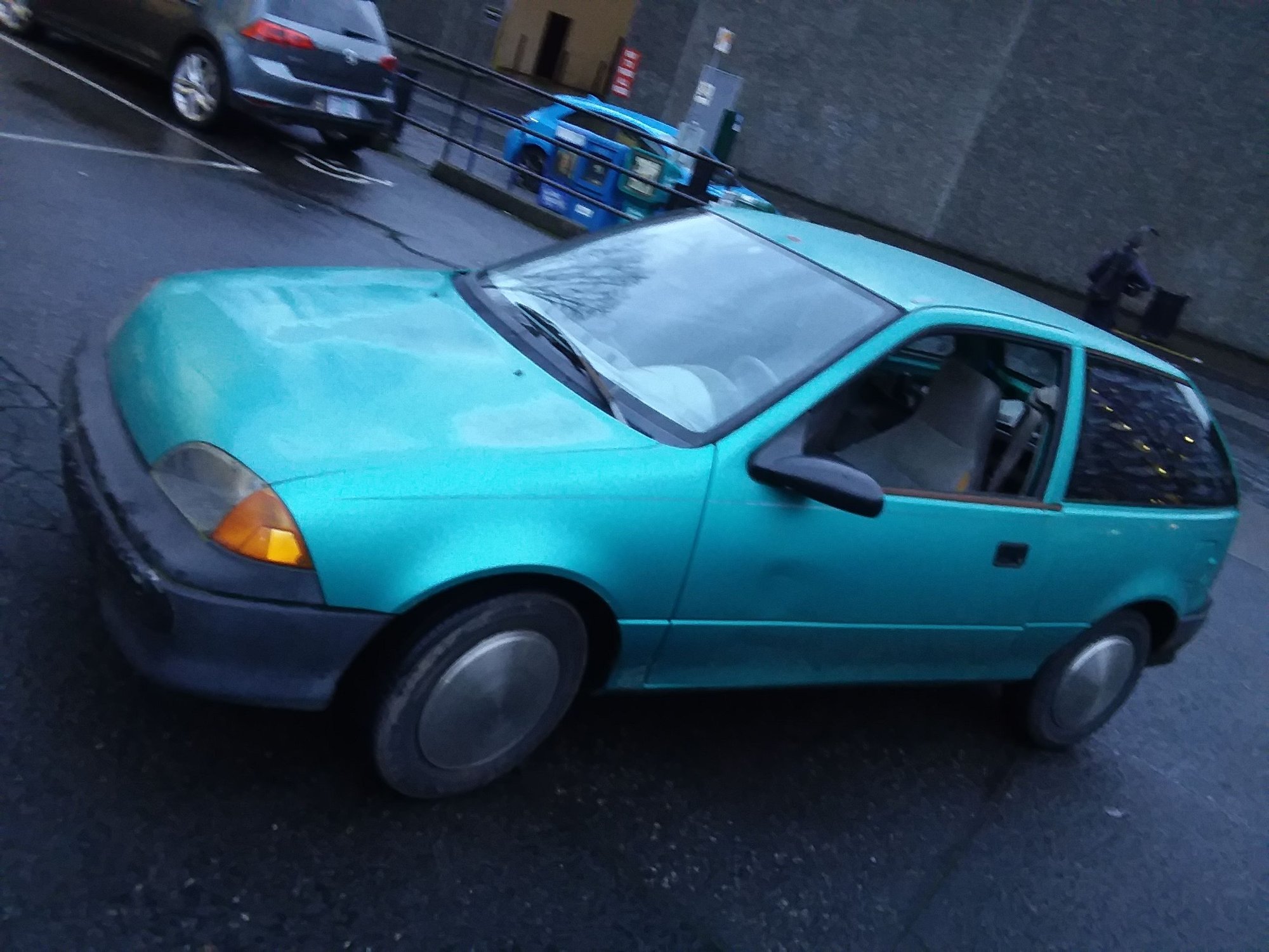

So I bought a 500$ Geo to drive while I swap out the y8/b7 for a G23. Car is turning out to be a solid daily so of course I'm thinking of ways to ruin it. This thing weighs 700lbs less than my Eg and I will have a leftover minime looking for a home... The primary limiting factor would sheer physical size of D engine/trans, particularly the overall length vs width of engine bay. The chassis does come in certain trims with a 4 cyl which gives me hope that I can just haul out the wire feed and cutoff wheels without resorting to a custom subframe type of deal like that B18 guy.
Any thoughts or input welcome.
I'm assuming I could get the Honda to Suzuki drive lines grafted somewhere?
What could I do about an inline fuel pump? The Geo is TBI but I doubt it will have the appropriate fuel pressure.

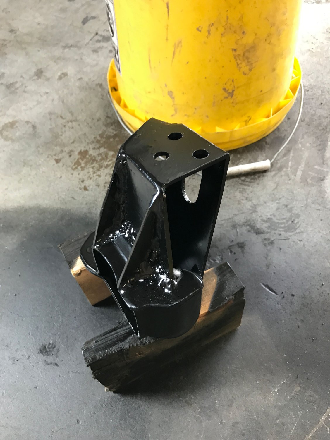

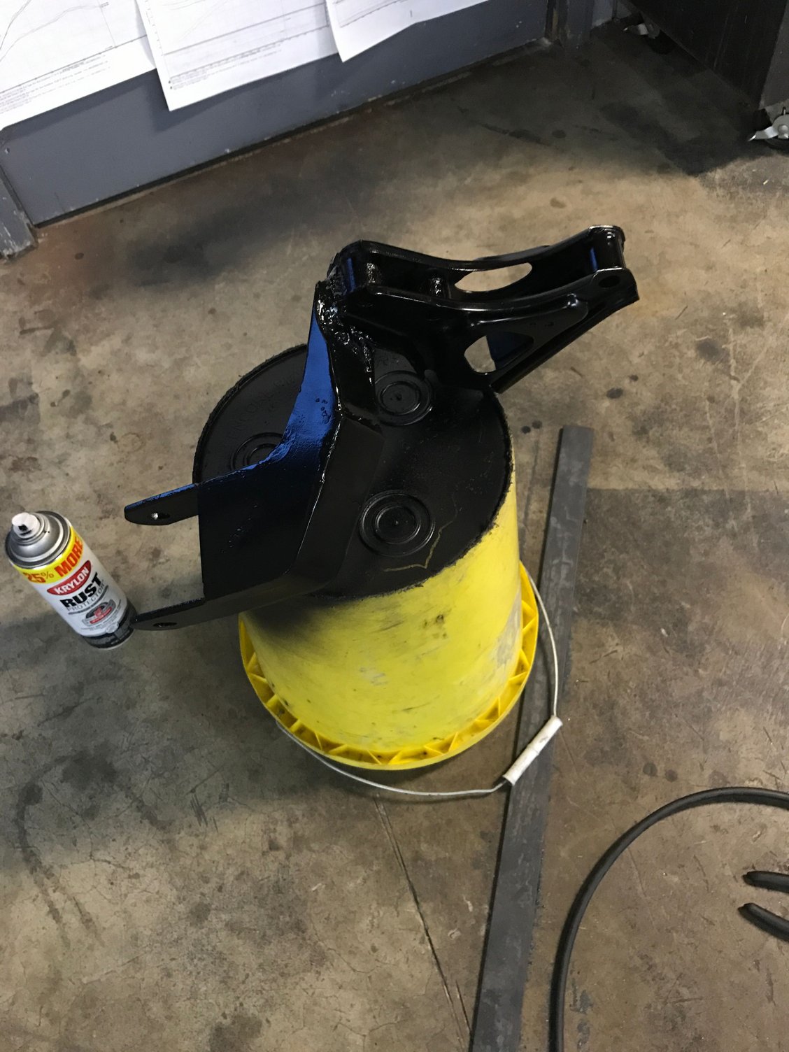

As it would turn out the engine bay clears by 3+" in width and some minor sheet metal massaging will clear manifolds, all of this depending upon axle angles of course. Not too worried about hood clearance.
It's not hard to triangulate mount brackets up with a wire feed and cutoff wheels, just need to scotchbrite and cold galvanize/paint.
