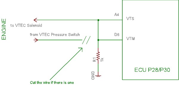

You can try this one:
Cut the VTM Line (if there is one) and connect the VTM wire running to the ECU with the VTS wire. Add to this junction a 1k resistor to ground. (A screw near the ECU).
Here's a shematic:
I've done this some times in hybrid's and in my self made vtec controller. Works fine for me/us.
Doc
