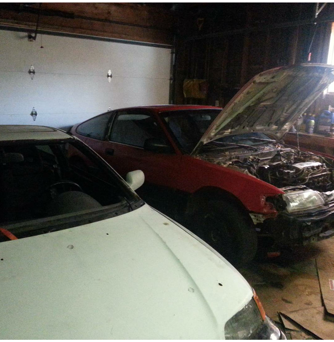

So to start off. It had been a while sense I'd had a project car and I didn't have a lot of money to throw at buying a car to start with. Plus I've always wanted to be able to take a car that was on the verge of death.. rotting away never to be seen again and restore it to it's long forgotten glory. That being said my gf was not half as happy as I excitedly showed up at the house with this gem now firmly in my possession
As you can see I had found myself quite the project to undertake. Which while that was exactly what I had been after I didn't realize what I had truely gotten myself into.

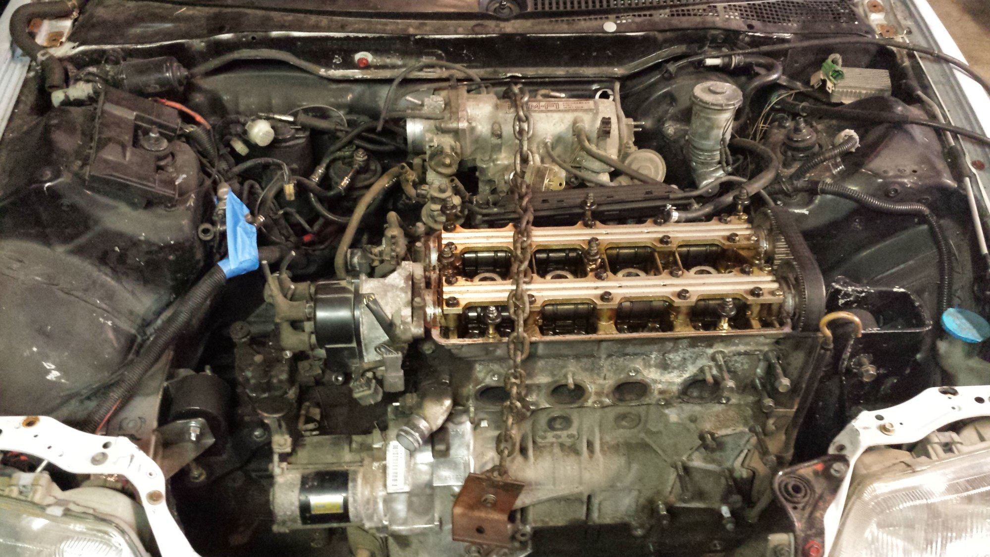

Opened up my timing case to find that the balancer shaft belt had been seriously neglected by the previous owner and this was the result.. luckily it didn't take the timing belt out with it

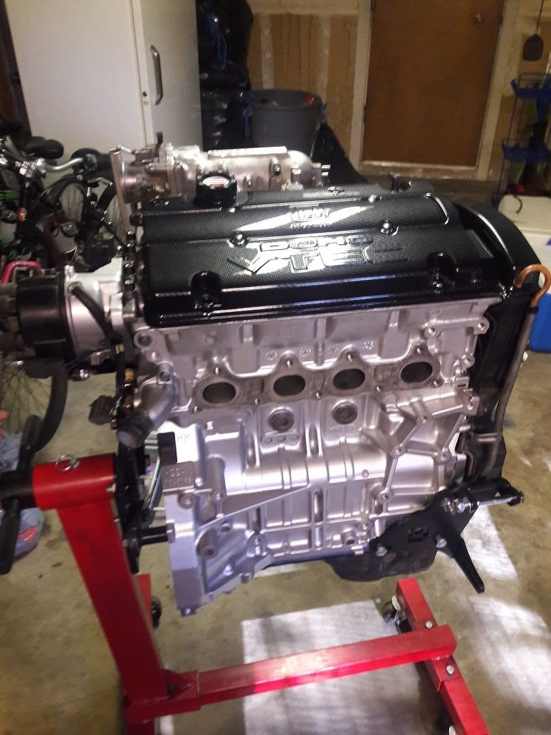

How the engine looked before i tore it apart
How it looks now that I've replaced EVERYTHING and cleaned/painted it.. much better
