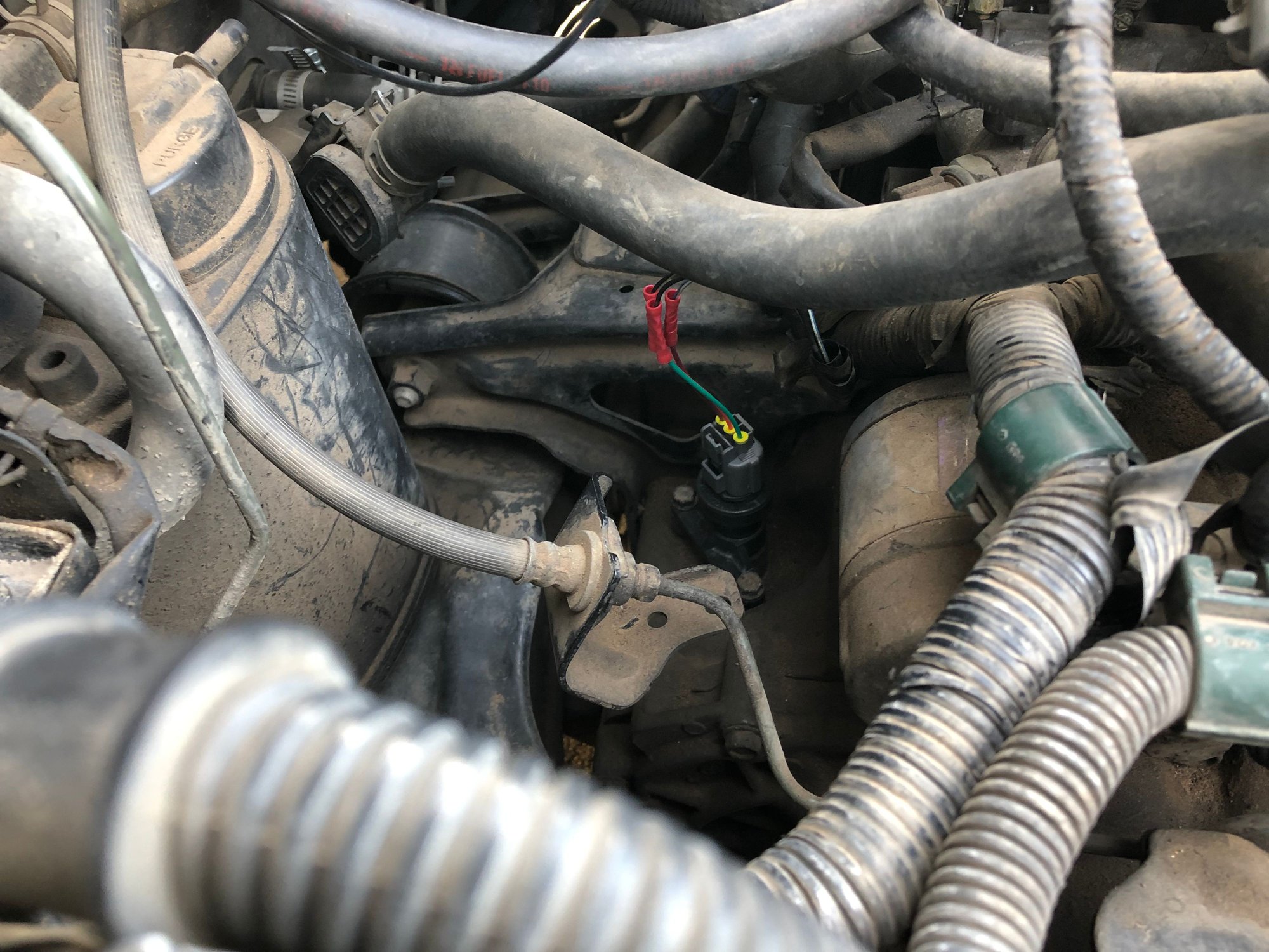

I replaced the speed sensor pigtail using your instructions. Speedometer works, odometer doesnít. Any suggestions? Where to check next? Wiring was reconnected exactly the same.

Speedometer went on the fritz again. I had an Si cluster get delivered today. Installed that and now the speedometer, odometer and trip meter all work,
but now my RPMs are reading about 1000 higher than actual number. VTEC is set to kick in at 4500, looks like 5500 on the Si Cluster. Shift light comes in at 7500 (I react slow, I need the extra 700 rpm), but itís kicking in at around 8500 on the Si cluster. RPMs sound normal, itís just reading wrong. Iím gonna do some research on the forums this week, but if any of you know the answer, please just let me know.
