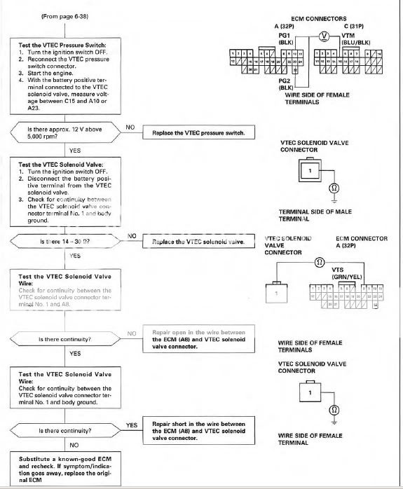

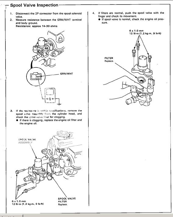

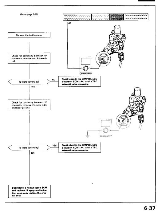

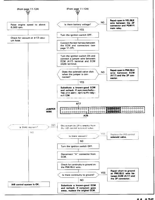

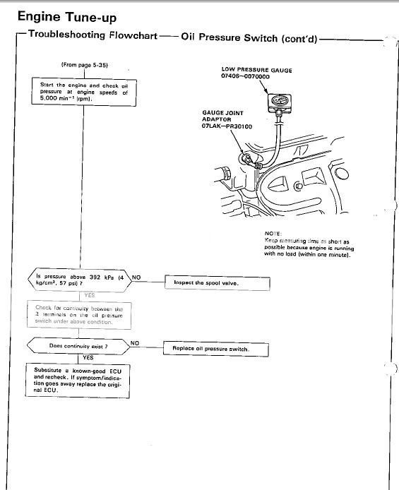

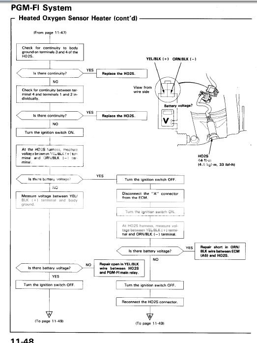

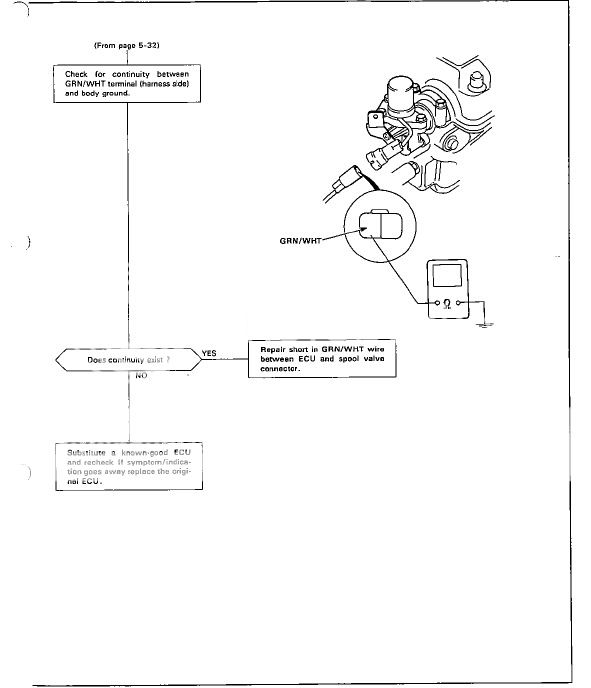

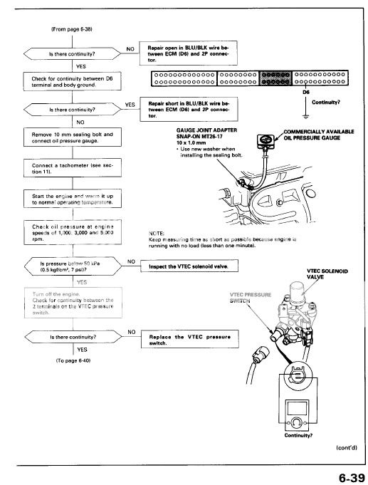

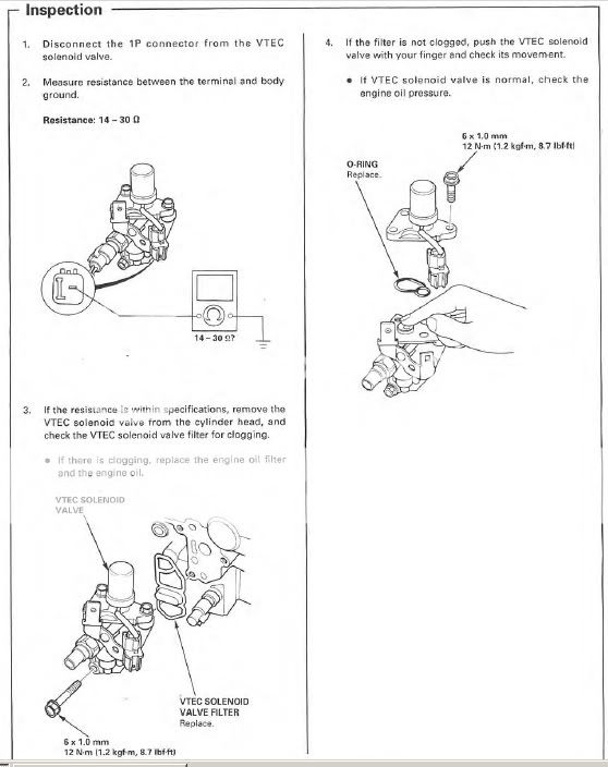

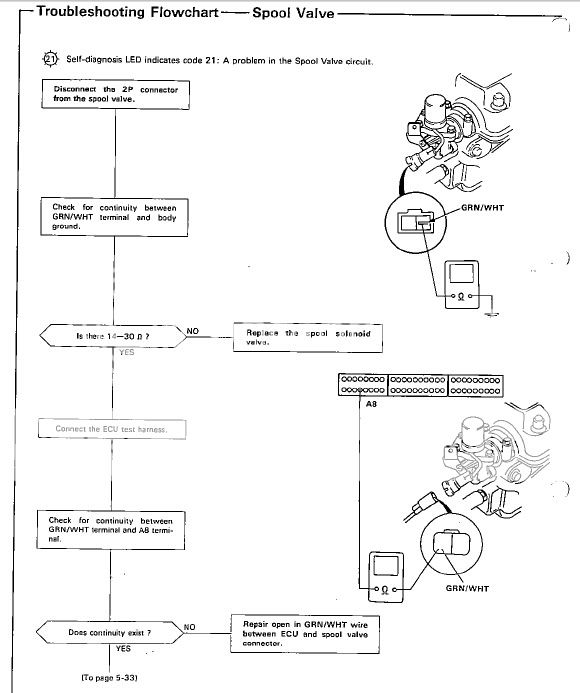

Courtesy of Honda Motors:
OBD0
OBD1
OBD2

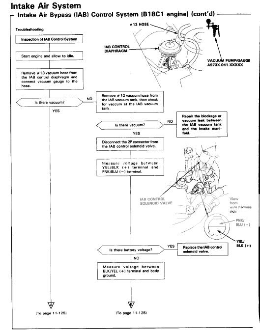

OBD1 IAB TROUBLE SHOOTING

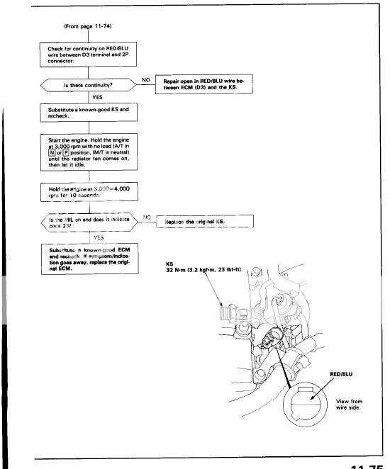

OBD1 KNOCK SENSOR

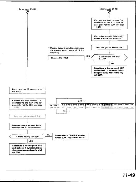

OBD1 Oxygen Sensor

Look at that - a systematic way of figuring out why VTEC doesn't work. After reading so many of these threads around here, I was beginning to think visual inspection followed by randomly replacing parts and hoping for the best was how it was done.
Good post.

I guess I will toss it out there as well for the JDM owners that do not have Vtec Pressure Switches and want to run USDM ECU's. Splice the Vtec Solenoid wire (Green wire with a yellow stripe) and Vtec Pressure Switch wire (Blue wire with a black stripe) together and this will fix it.

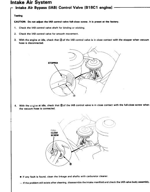

I'd love to see the IAB sheets for OBDI if you have them. Otherwise it's great!

added IAB trouble shooting, OBD1
Also is it possible to change the title to "My VTEC/IAB doesn't work" to reflect the updates?

added knock sensor and fixed the images i guess we todd did isn't up anymore, let me know if anyone wants anymore

very useful, Thanks! I just got a new multi-meter. so test the soleniod do I use DC or AC settings? is there a general rule of thumb where if there's X amount of wires then its a AC/DC?
Thanks! still new at this

What is the manual referring to when they say "connect the ECU test harness"??

when was the last time this thread was checked the pics are not loading.

pics are exactly what I need except they are too small for me to read

yea! fixed the pics, sorry took so long, I finally got some time and found that google picasa was shrinking the pics even when I linked them, so I tried photobucket and wala!
