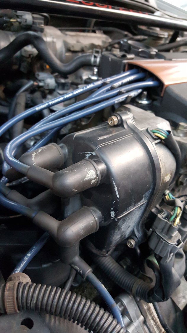

Speaking of, I need a new cap and rotor or just may replace the entire distributor but I can't remember what parts I used. I'd rather buy the parts before taking it apart to speed up the job so does anyone remember what they used for a 93 Jdm h22a converted to obd2 in an obd2 96 lude? Swapped oil pumps and my crank position sensor is located by the crank timing sprocket as well as a 2 plug dizzy, so it's a full obd2 conversion.
I wanna say I used the regular prelude dizzy since it's obd2 but it's been 5 years lol.
So you are using the TD-77U, distributor, so just purchase an external coil cap and rotor. Honda Oem part number for cap is 30102-PT3-A12 and the rotor is 30103-P08-003.

backinblue92's Avatar
Join Date: Feb 2010
Posts: 470
Default Re: Sputtering in low rpm after vtec engagement.
I believe this would be it then, this is one on my car. Damn stripped screws on the cap though that's why I considered just replacing the whole thing
No dont replace the whole thing you cant fit an 8mm socket on those bolts anymore to take the cap off? And yes thats a td77u external coil distributor.

The 8mm slips ever so slightly so it'll just round 'em off, I tried the philips, stripped the hole. I was apprehensive about using wd40 on them so close to electrical components. Not sure what would happen but it sounds like a bad idea.
Whatever. I'll just have to use a bolt extractor to get em off. Those bolts can't possibly be anything too "9 dollars per at Honda" special hahaha.
Well you could try wd-40 or liquid wrench and see what happens but if the 8mm slips over slighty maybe try an 8mm box end wrench and see if that does any good. I have had the same issue once I ended up just hammering on the 8mm socket over the bolts and it got all of them loose. The cap from Honda actually comes with those bolts so your good to go there.

Alright thanks man I'll give that a try, though like u said the Honda part comes with the bolts, so who cares if I destroy them as long as they come off. with smog due up in a month I need to get that cap replaced. I'm paranoid about CA smog now cuz my obd2 failed on HC's last time then I drove it hard and took it back and it passed with super low HC's. Lol

I had same problem with seized bolts on cap. I used dielectric grease on those threads and come off nice now.
