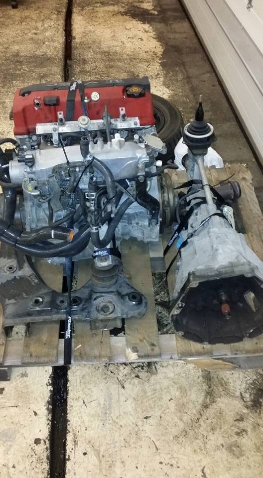

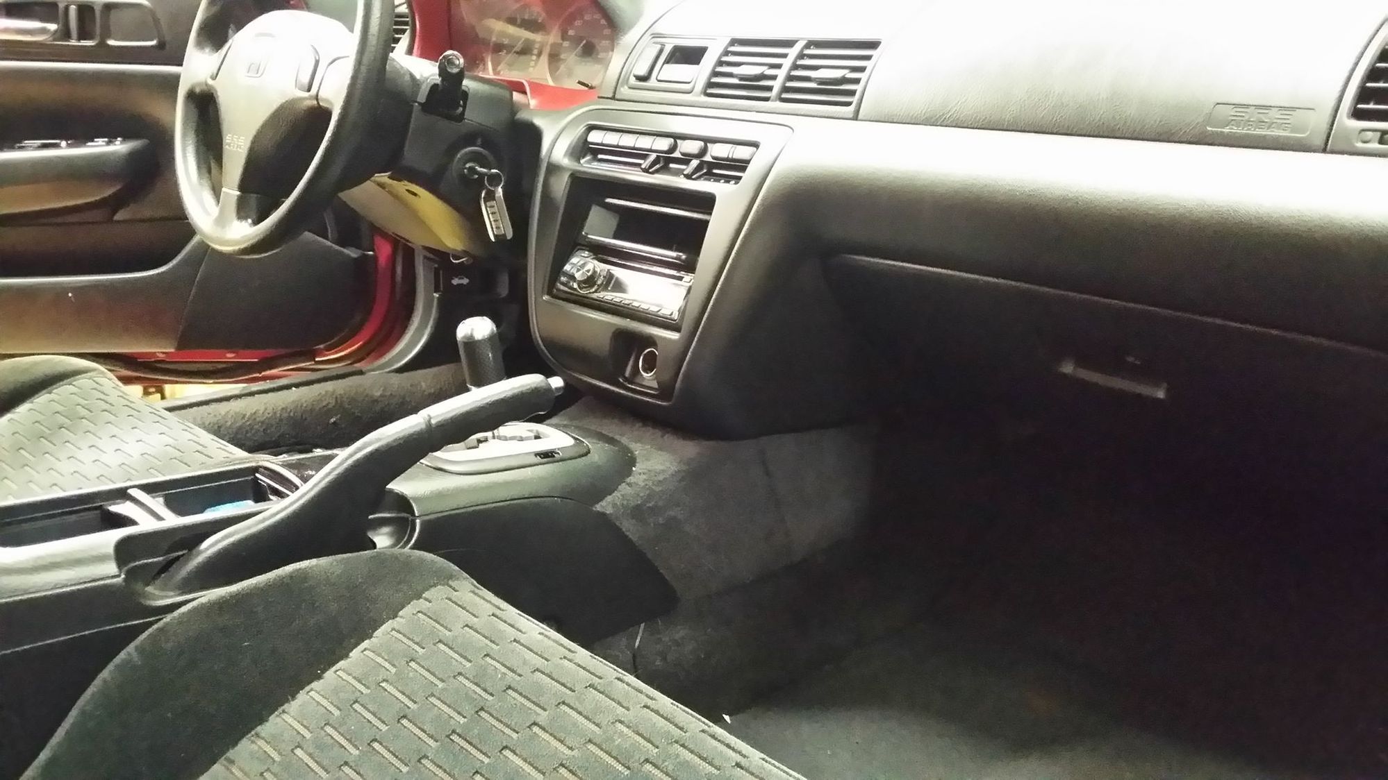

Just wanted to tell you guys about the swap i am doing, i am swapping a s2000 f20c into a 5.gen prelude and converting it to rwd also. I got the swap from the UK and have been collecting stuff for the swap.
I am using a transmission tunnel from a Subaru Legacy,
Here are some picks

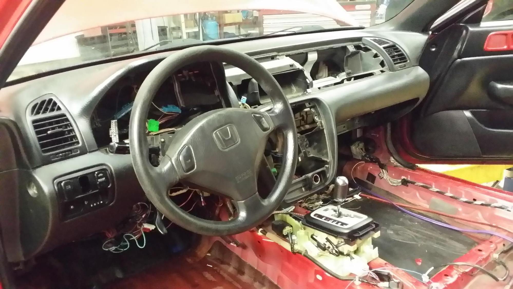

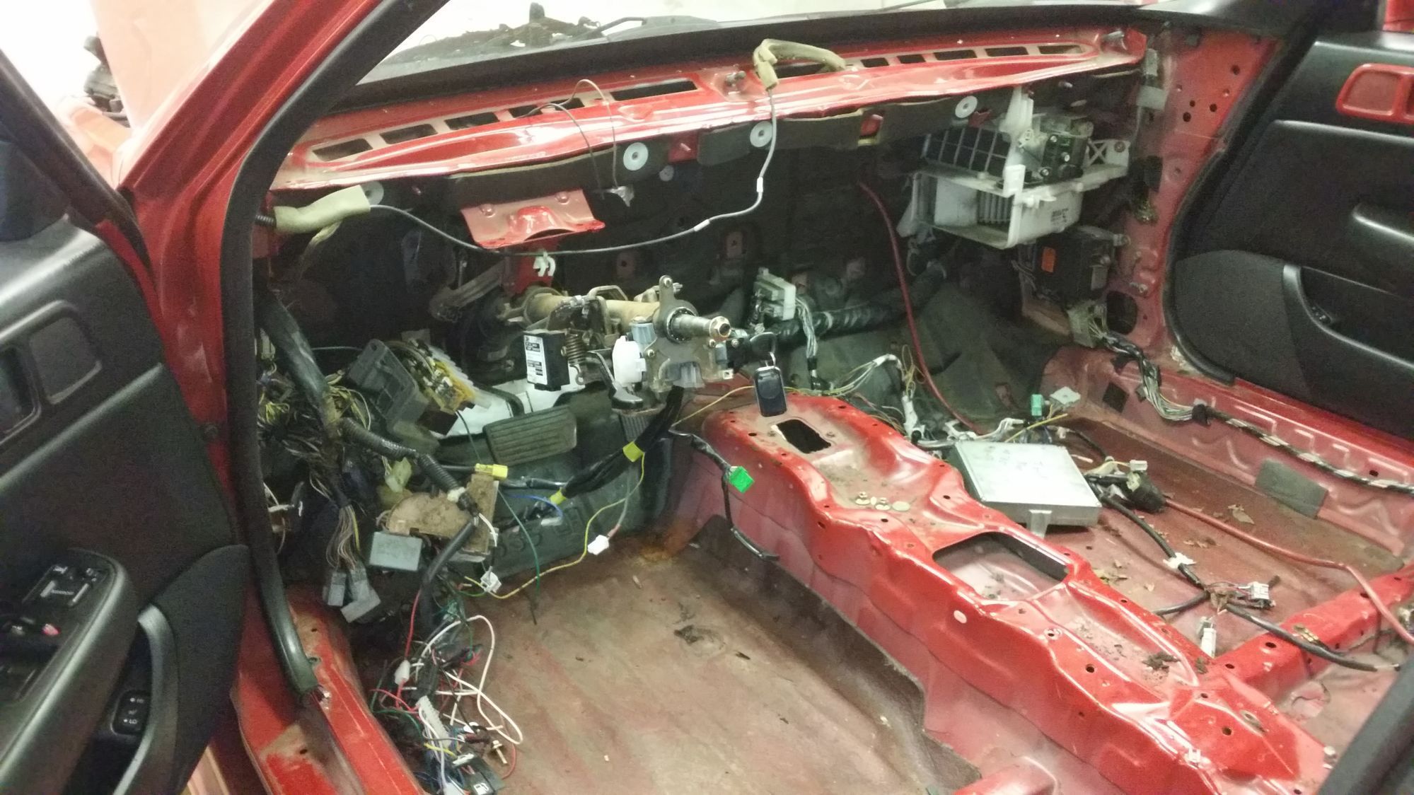

Pulling out the f20b engine
pulling the rest of the stuff from the car
Making a custom engine loom
Custom loom
Finding the center line
Cutting out the firewall
Test fitting the engine
Making a subframe for the engine
Subframe
Test fitting before weld
Looks good
