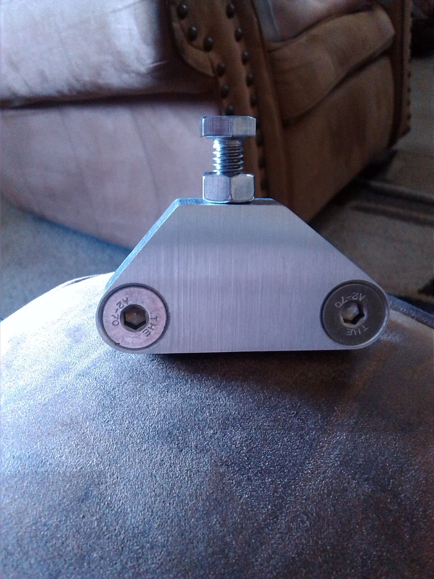

I also had an auto tensioner fail ... I couldn't remove the brass bolt in the side of the block to do manual conversion, man that sucked when it went....
Kaizenspeed is about the same price and won't fail, totally worth it IMO. I wouldn't build an engine without one today (don't know why it took so long for it to become avail.)

Thanks yohan. Im definitely gonna get that one or try to fabricate my own. Im getting ready to order a timing belt kit. It looks like I should have all parts and actually start build the first of August.

After hearing all the horror stories I got a manual tentioner. I've got everything for the rebuild except some go fast parts. A week or 2 before rebuild I'm gonna take balance shaft belt off. If vibrations aren't to bad I'm gonna order delete kit. I'm sure if I buy new OEM mounts vibrations will be bearable. Lol of coarse I didn't get ks tuned this is a poor mans build
