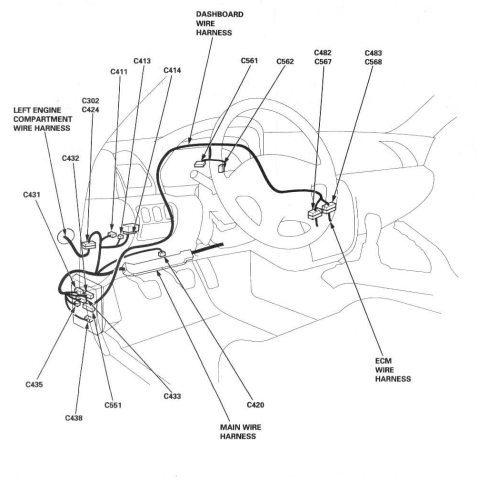

Hey, so i need help taking out or disconecting the wirring haresses(s) that connect to the driver side interior fuse panle in my 2000 prelude sh. Its in need of repair, wich i can do. I just need some pointers or suggestions on how to approach it from the easiest way i can. Please help lol

- Remove the door sill and driver kick panel cover
- The fuse fox has two screws, take them off and disconnect all connectors attached to the fuse box

How far does the harness reach towards the passenger side?
