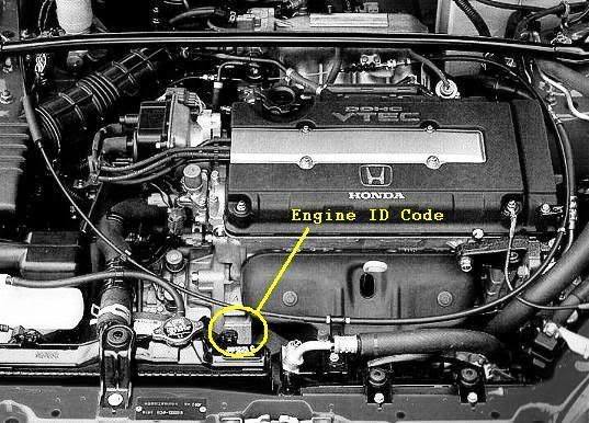

I'm assuming you mean that the engine is JDM, not the car. An easy way to find out, is to look at the stamp on the front of the block. The top row will tell you what engine you have; which will tell you what ECU you need.
