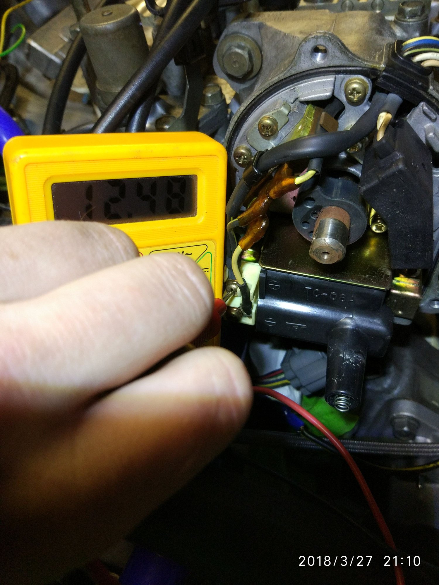

So still no spark, but have noticed something interesting on the distributor whilst replacing the rotor arm and cap, with key ignition on both + and - terminals inside the dizzy read +12V DC. Does anyone know if this is correct?
Secondly: The spark leads are reading 7-11kilo ohms resistance, This sounds high, I would of thought it should have minimal resistance i.e. 1-2ohms.
Top View
+12V on negative marked terminal
+12V

Turned out to be the coil pack had died, see my main post
https://honda-tech.com/forums/hybrid.../#post51583966
