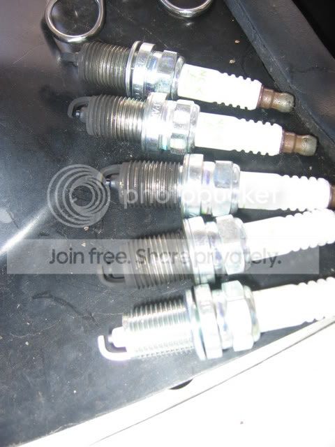

http://i47.photobucket.com/alb...2.jpg
thats a pic of the best looking one. the others are lil blacker.

well from what i can see they dont look 2 bad. maybe your ignition coil is taking a dump..

That one doesn't look that bad to me. Show another one.

trust me there are bad. that pic i showed u was the best one. the others are solid black and 2 had fuel i believe. ima change my plugs 2 morrow and ill show ya some more pics

replaced plugs fired right up. ne other ideas?
these are 1 week old

looks like a lot of carbon buildup to me. check your fuel lines, filter, rail, and injectors. maybe you could try to add fuel cleaner additive to your fuel tank.

After actually looking at the link I posted it really could be oil.
Do a plug chop before they actually stop firing so you know if they are wet then its oil, and not fuel.

they look oil fouled..
