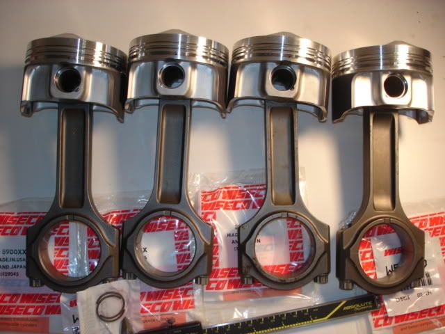

Ok before i get into this, i'm going to be adding tech to this thread as i go so be forewarned that you will likely need to read the whole thread in order to retain everything that is done.
I purchased this setup with the machine work already done. I do not have a bore gauge to determine how well everything was done but after talking to a wiseco rep, the piston to wall and the ring gap are dead on for what i am trying to achieve. I'm assembling this motor in hopes that everything was done correctly prior to me buying it.
Here is what the motor is going to consist of:
f22 crank = 50mm mains
BS kit plugs for the oil pump
Pistons installed:
sidenote......the autozone ring compressor sucks donkey *****!!!
Block:
h23 block with 89mm darton liners
89mm Wiseco pistons
Crower h23 rods
F22 crank (micropolished)
-- crank, rods and pistons have been balanced

<TABLE WIDTH="90%" CELLSPACING=0 CELLPADDING=0 ALIGN=CENTER><TR><TD>Quote, originally posted by xxmastermindxx &raquo;</TD></TR><TR><TD CLASS="quote">why ACL bearings? the vast majority of talk on here is OEM bearings. most of it, anyway.</TD></TR></TABLE>
whats wrong with them if they meet bearing clearance specifications?
OEM bearings are roughly 200 dollars for main, rod and thrust washers
i picked up these ACL's for 50 shipped. ACL bearings are made to meet the "green" clearance of Honda spec which is in the middle.
I plastigaged the mains after getting them aligned honed and each main was near the middle of honda spec.
98vtec is offline
