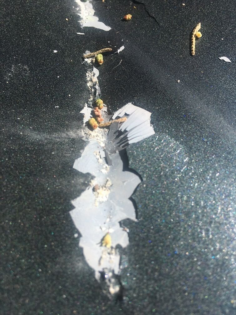

Join Date: Sep 2002
Location: Saugus, ca, USA
Posts: 496
Received 0 Likes
on
0 Posts
Re: 1997 Base EGP Flip project
Well I'm a super lucky guy lately....
I went outside to make a starbucks run this morning and I found a huge dent in my hood from a brick that fell from the 3rd story roof. It hit soo hard that my shock tower also has a dent in it. The hood was completely pierced in one spot. Hopefully insurance can sort this out and ill get a carbon hood. I'm sick of dealing with paint. lol. There must be $150 in paint on that darn hood. I was still working on wet sanding the new 2k clearcoat so it was not smooth yet. Its hard to tell in the pics but the whole drive side of the hood is warped.
I'm going to be angry if they try to stick me with some aftermarket ebay hood, I made sure that this car stuck with OEM body parts.
