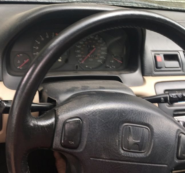

First I got the Steering wheel swapped. The Airbag looks more grey than the wheel now but I guess its not that bad, I kind of wish I did the cleaning and sealant on the wheel but not the dye. Ohh well no biggie.
Leather wheel cleaned and refinished, looks decent.

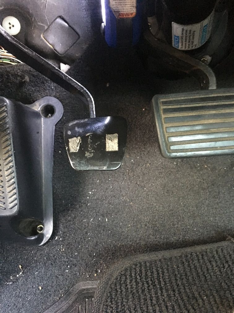

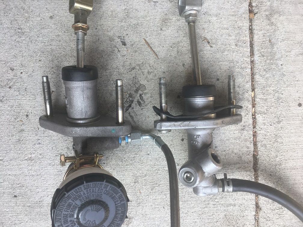

Clutch Pedal install.
-S2000 AP1 Blox Clutch Master Cyl
-2x Blox Clutch master spacers
-Accord/Prelude Master Push Rod
-5th gen prelude Clutch Pedal
-Braded line and fittings that came with the Blox Master kit

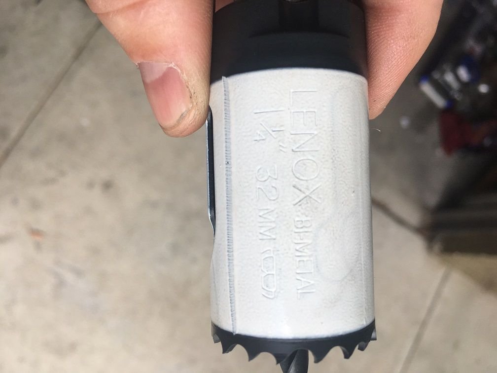

Drill bit I used
Drill bit compared with Master
S2000 AP1 Blox Master cyl
Master cyl set up poorly as I had it in the accord.
Top is S2000 and bottom is Accord/Prelude push rod
