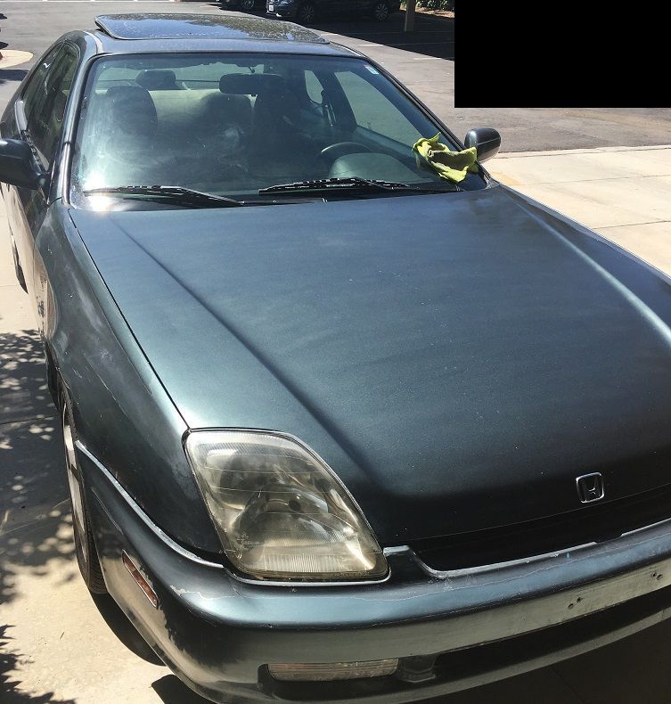

So I was surfing the old interwebs(lol Richard Rawlings). I saw a 97 Prelude locally for $500 so I sent an email expecting for it to be some kind of Scam or already Sold. I didn't expect to get a reply but sure enough I got a reply that it was available very quickly. So I figured how can I lose. The car was at a local tow yard, the condition was.. well pretty decent. The car had the classic Honda Surging idle issue and the mechanics didn't know how to fix it. I did see a few scrapes on the side of the car most likely from the tow yard and the car was filled with a bunch of trash and such. The car did start and run so I figured I would pick it up. They even towed it to my home for free. The car is an auto so that's a drawback,
I went ahead and cleaned out the car, tons and tons of trash, the car was definitely not taken care of. Over all it is pretty complete. Idle was an easy fix, cruise control vacuum lines were disconnected.
I went ahead and took it t the car wash and gave it a wet sand and cleaned the engine bay. The battery terminals are crap and it was missing the spark plug cover and valve cover harness cover. The power steering pump has been leaking... forever. I went ahead and replaced the o-ring on the high pressure line and the leak was fixed. I picked up the covers for the engine from the pick your part. The power steering belt was lose with no adjuster. The bolt was stripped so I had to buy an extractor tool. New belts were in the trunk so I replaced all of the belts, unfortunately the alt belt was rubbing on the timing cover so I had to take it apart and add a spacer to the alt for everything to line up, well and clean the years of PS fluid off and out of the alt.
Radio was missing so I installed a old one I had laying around, I needed to replace the plastic inner portion around the radio that was missing, again pick your part. One of the speaker covers was missing along with the armrest top. Again pick your part. I was able to find the Coin tray on Craigslist so I picked that up along with parts for a 5speed swap. I ordered some cheap boss replacement speakers from Amazon for about $40 for all 4 speakers, not too bad.
Registration. So registration cost me about $200 including new plates. First smog attempt was like $70 and I failed idle by 1 point. What a pain. So I picked up some of that Smog pass additive from walmart, threw that in the tank. New Cap/Rotor/Wires/plugs as well as cleaned the IACV and EGR. That kit was about $100 from ebay, I wanted the NGK plugs so the price was a little more. New oil/filter as well. Ran the car until it was empty and took it to smog again. This time it was a solid pass and $30 for the retest.
Rear Sway bar had a broken mount so another pick your part replacement part. The Original hood was sun faded all the way to the primer, the front was bashed in and both rear corners were bent due to not being aligned. I grabbed a Silver hood from pick your part as a replacement. Its apparently impossible to find body parts in EGP.
Front and rear bumper are not stellar, I did aligned the front bumper decently but someone decided it was ok to hit the front of the car in my parking lot and popped out the passenger side of the front bumper. So I went ahead and pulled the front bumper cover and replaced the bobby pins and wire that someone used to attach the bumper with 10mm bolts and rivet nuts. More permanent fix. Blinkers all work now and the car has HID headlights and ballasts. The Fog lights are not wired and there are no bulbs currently. I may move the HIDs down to the fogs and replace the stock bulbs for the headlights.
Paint... I wet sanded/polished and waxed most of the car, the front fenders have definitely spent some time in the sun, the hood was trashed and the front bumper has faded spots as well. The trunk, quarters and doors are perfect. The rear bumper still needs to be polished and waxed. I'm going to need to remove it since It sags on the passenger side, one of the tabs is broken. The rear of the roof has some sun damage, I did what I could as far as wet sanding but its just a bit too damaged to polish out. I may try to clear coat and see how it turns out. I attempted to wet sand the fenders and I could get it pretty close to perfect by removing the clear but I already burned through in a few spots so ill respray. The passenger fender has a few dents so I'm going to pull it and see if I can smooth it out, I may need to replace it. I painted the hood yesterday, I ordered paint off of amazon, ERA Paints G-83P cost me $40 for one base and one clear. The match is extremely good. I had to replace the driver door handle as well and you cant tell its been painted. I used the first can of basecoat on the hood after some through wetsanding with 800 grit. The hood had some rough spots that came smooth with sanding. The first can of paint just barely was enough for the first coat. I ordered 2 more sets of paint for $40 each. I finished the hood with 3 more coats of paint, ended up basically using 2.5 cans of paint to spray it. As far as clear coat I put on 3 coats of clear and my hands were basically worthless at the end of the 3rd coat so I stopped painting, I think that will be good enough. There is a little striping at the moment but I'm hoping after the wet sand we will be good to go. The paint matches perfectly with the fenders where they have been sanded thru the clear but it really makes the sun burned spots stand out. I'm going to go ahead and remove the fenders and respray, I may need to order some more paint. Note... if you want prepainted parts get Black/Red/White car and you can pick up a front clip with rear bumper at an importer for a ..."Decent" price.
At this point I am in to the car about $1250 in parts and supplies. Labor costs.... where is the infinity sign on the keyboard. lol

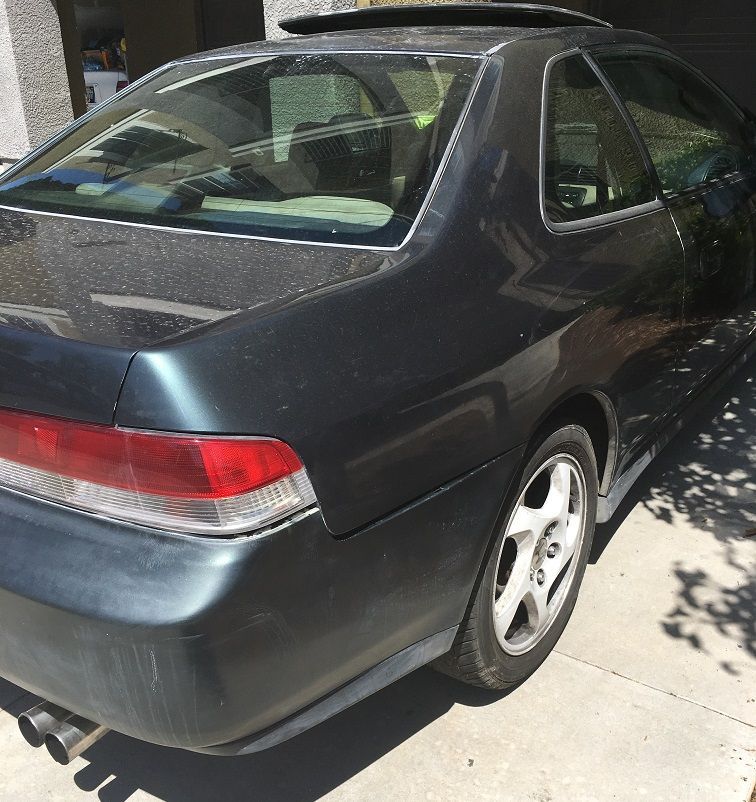

Car is Dirty but Driver side is pretty clean, Rear bumper has been wet sanded but not polished or waxed
Trunk lid is very clean. Its been wet sanded with 2000, then rubbing compound then waxed., its dirty now but I need to wash the car once I finish with the painting and waxing and such

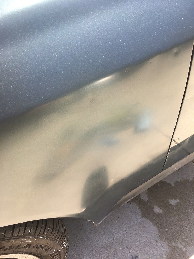

Passenger side had some scrapes from the tow yard, I did hit a few spots with paint and have yet to clear. Honestly you cant really see them.
Passenger fender, I tried to wet sand thru the clear but burned through, this fender needs to come off and be straightened still before painting.

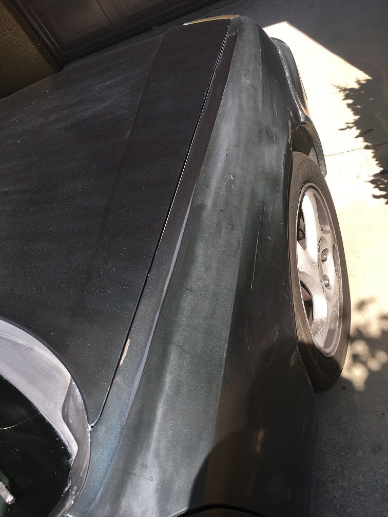

Hood came out ..."ok" but there is some striping. From a distance or straight on its ok.

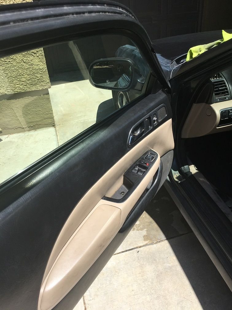

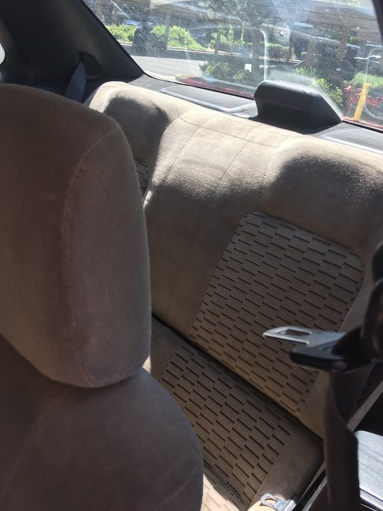

Interior is decent. Nothing exciting.

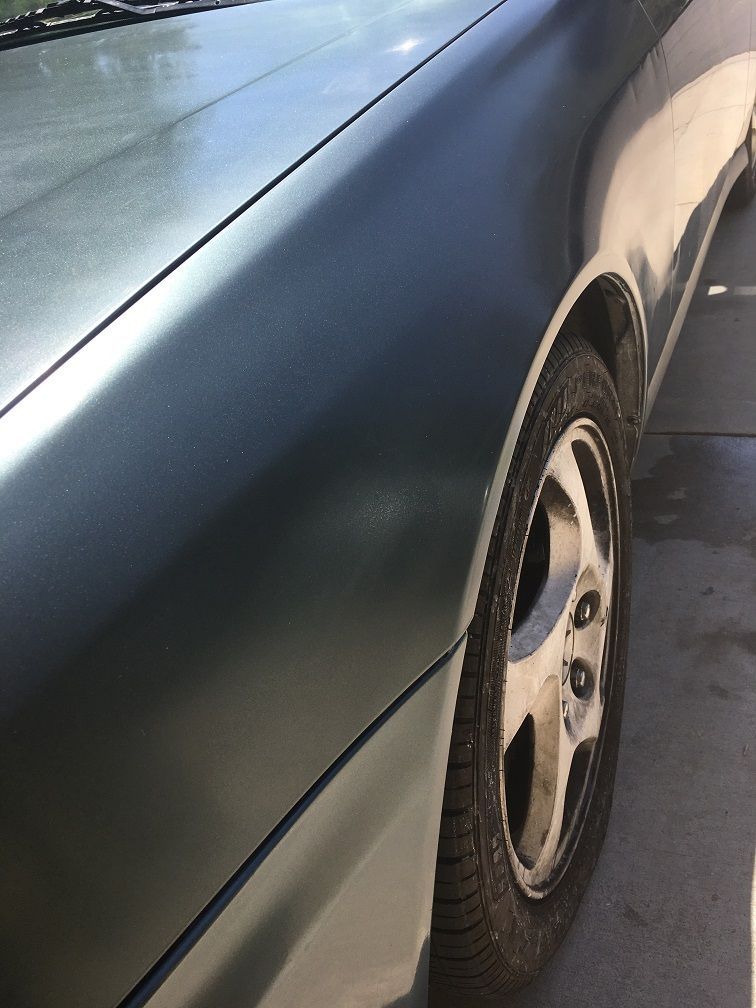

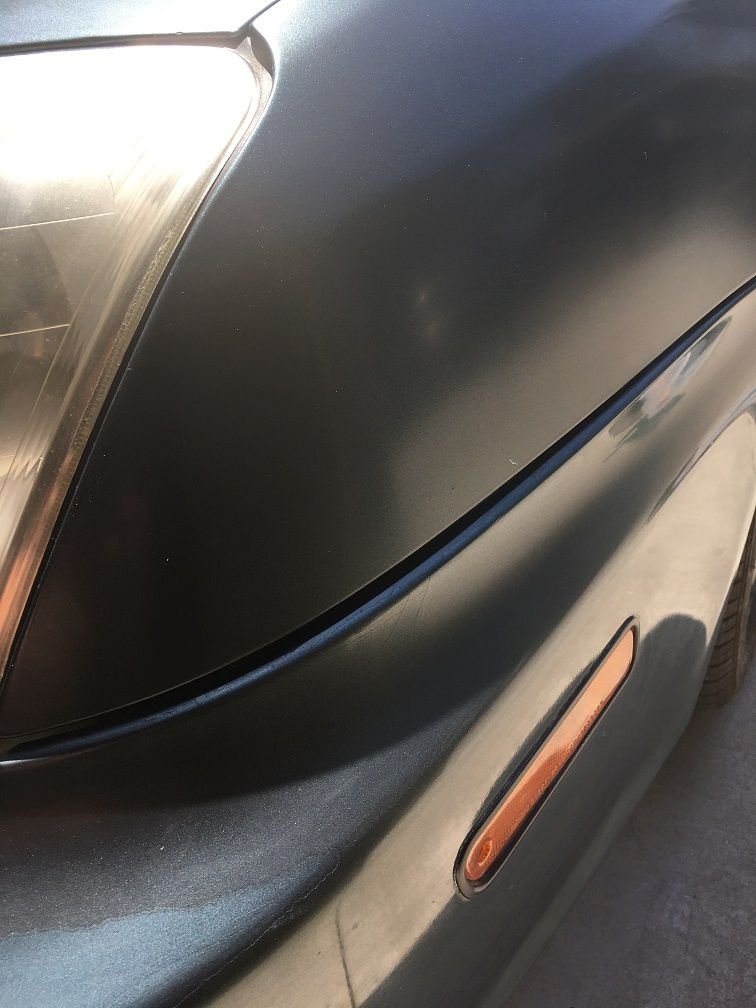

Freshly painted fender. Still has some was residue.
Looks a little dull but most of that is the light and some wax. Ill take better pics later.
I only painted the fender about 1/2 way down and faded the paint. I didn't want it to be perfect, I wanted it to look like it wasn't painted.

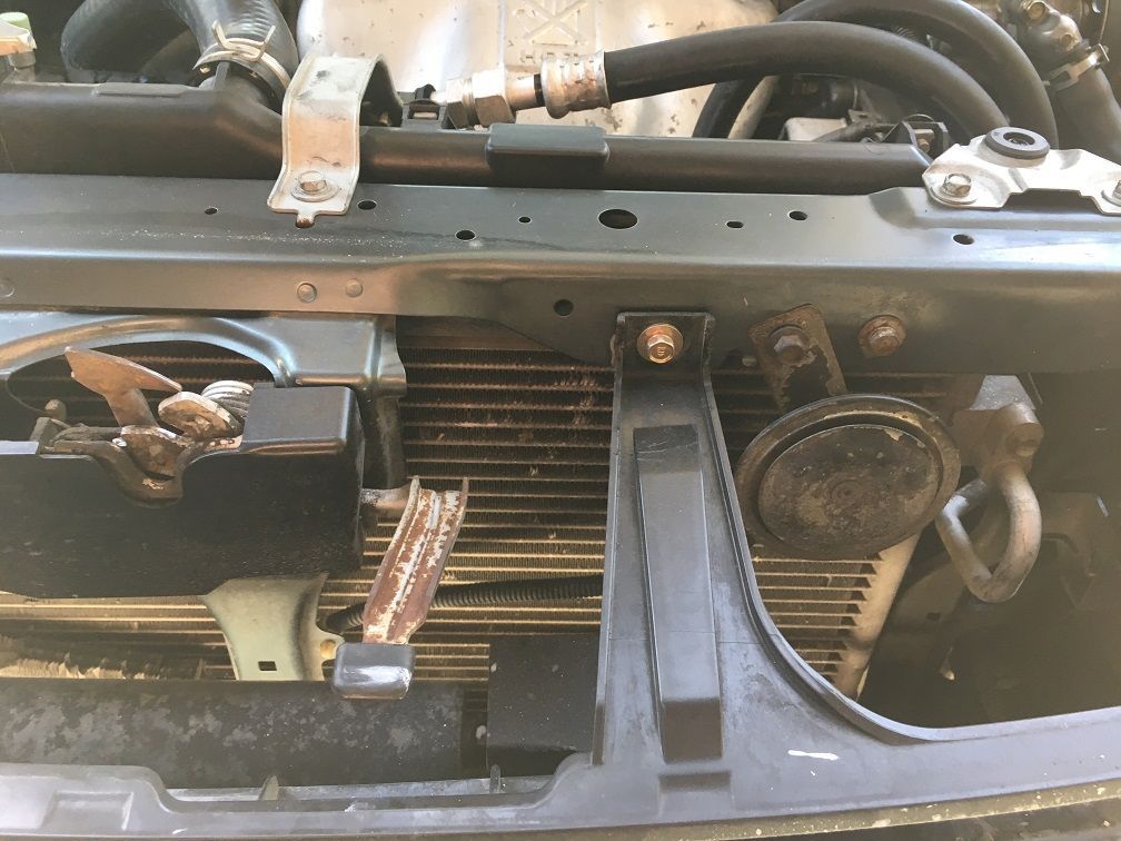

Pulled the Front bumper, Side Skirt and passenger fender to try to bang it out but I cant quite get it smooth. Ill have to find another fender to replace it with. Ill try pick your part tomorrow, they had a 98 there for a few weeks and maybe some of the parts are still available.
About 5 lbs of dirt fell off the side skirt.

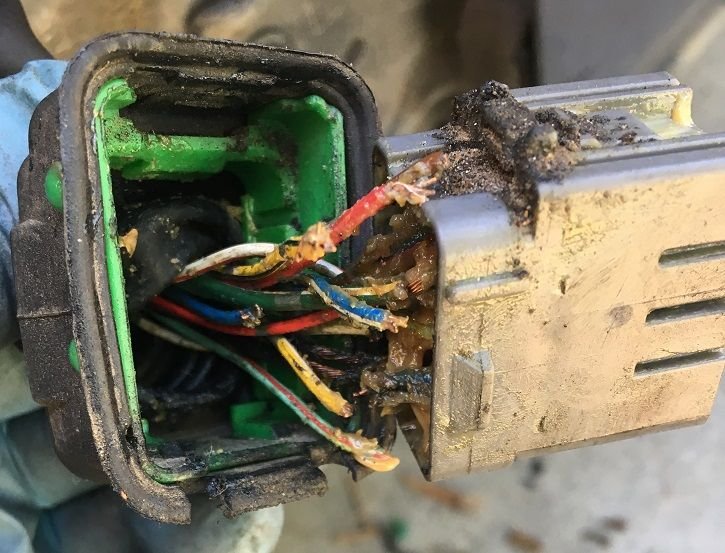

The other issue that I needed to work on was the Driver side Door electronics. The window works thankfully but pretty much nothing else does. I read that the Door wire harness tends to rip itself apart. I was going to work on it when I took off the driver fender but I ended up skipping that step and painting it still on the car. I was just outside looking at the car thinking about pulling off the door but I think it would be better to wait until the paint comes in and when I install the passenger fender I can pull the driver side to work on the wiring. Hopefully it will be obvious where the issue is. I did need to work on the driver side lock as well, when I painted and replace the driver door handle the lock stopped working. I guess something must not have sat correctly. Ill wait to do that until I'm done with the door... Darn projects stacked on projects.

Driver side door harness
Driver side harness once removed, there should be 15 wires.
Driver side harness after being repaired.

As the pics above show, I repaired the driver side door harness. Only the power windows still worked. I ended up picking up both driver and passenger side harnesses from pick your part since every single wire was damaged on mine. The new harnesses were.... better. lol. I added some heat wrap to all the wires in hopes that they will last a while. I reattached all of the wires and everything is good to go now.
The new Fender is on I just need to wet sand/buff/wax.

Damn.. there's a surprise around every corner. That harness is beyond roached, surprised anything worked in that condition hahah. Looks much better.
