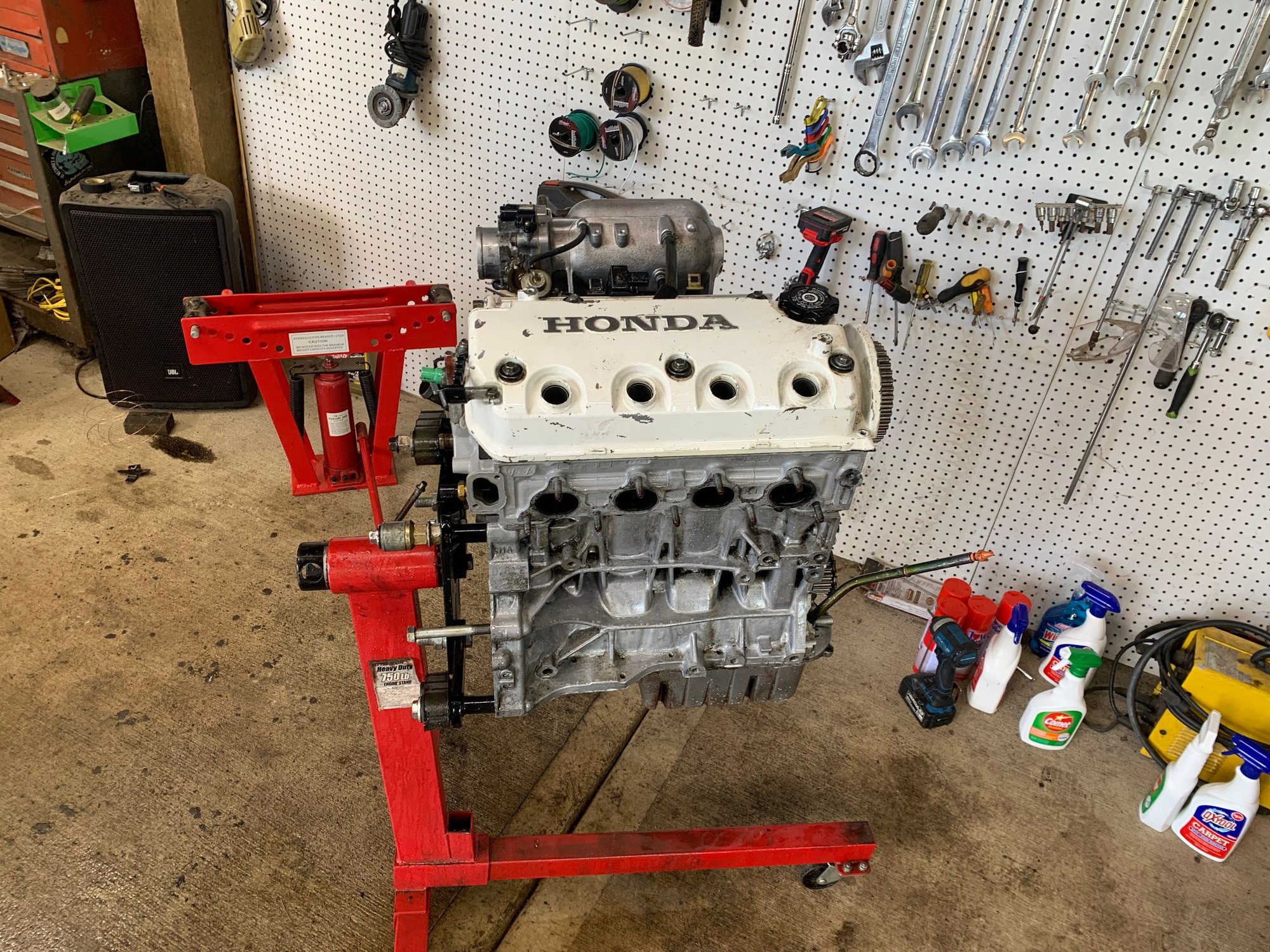

so after much much deliberation I decided to do an odd build that kind of went against the grain. I have been working on a z6 block with a d17a1 crank, rods and pistons. It will be 76mm by 94.4mm totalling 1712 cc's. I have finished porting the y8 head as well as started porting a z6 head I got for free. The block will be milled .030" to raise the compression to about 11 to 1. Redline cam and cranks down in Albany will be regrinding my z6 camshaft for me and I'm hoping they will be able to make the primary intake lobes smalll and have a large aggressive vtec lobe to help maintain fuel economy. I also got a cx Tranny for free and I will be running that to start with and swap it out for the y8 if I end up hating the long gears. I also got a neptune demon rtp today for tuning a customers car so that will be fun to mess with. I haven't tuned anything on neptune since every time I tried to download the software it wouldn't work for me or the link was not found. Hp goals are 145/120tq which I think is achievable and I would like to be able to pull 50mpg freeway with the car since I use it allot for doing mobile tuning. I've really fallen in love with the cars handeling and I'm excited to have more torque to pull through corners. I decided against the turbo setup for now because I know it's easy to get power greedy and before I know it the car will just end up another drag car due to the rediculous achievable power to weight ratios it can have. I would like to auto cross the car once the swap is in. Dropping the block off at the machine shop to get decked, bored and honed for the oversized pistons. Also started porting my y8 intake manifold and sized it for a 60mm b series throttle body.
I know all motor d series seems a bit counter productive but a fast na single cam is impressive to me. Idk why but I like the challenge of taking pretty much the turd of Honda motors and doing something fun with it.

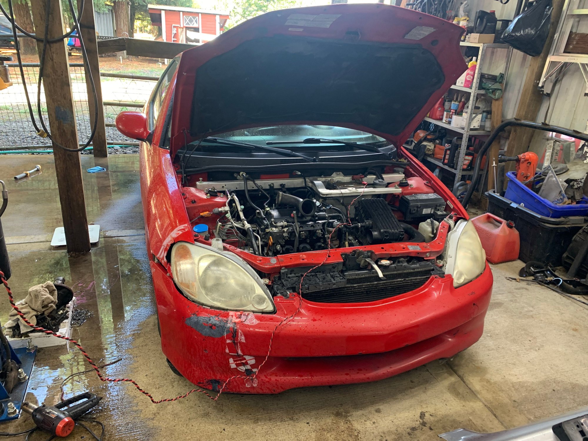

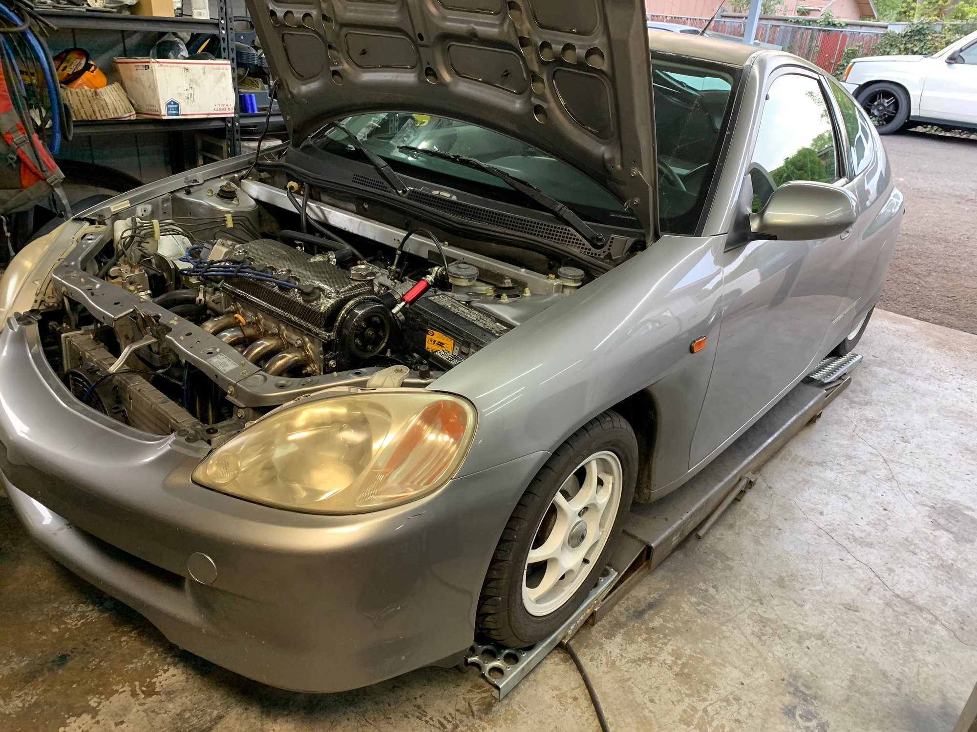

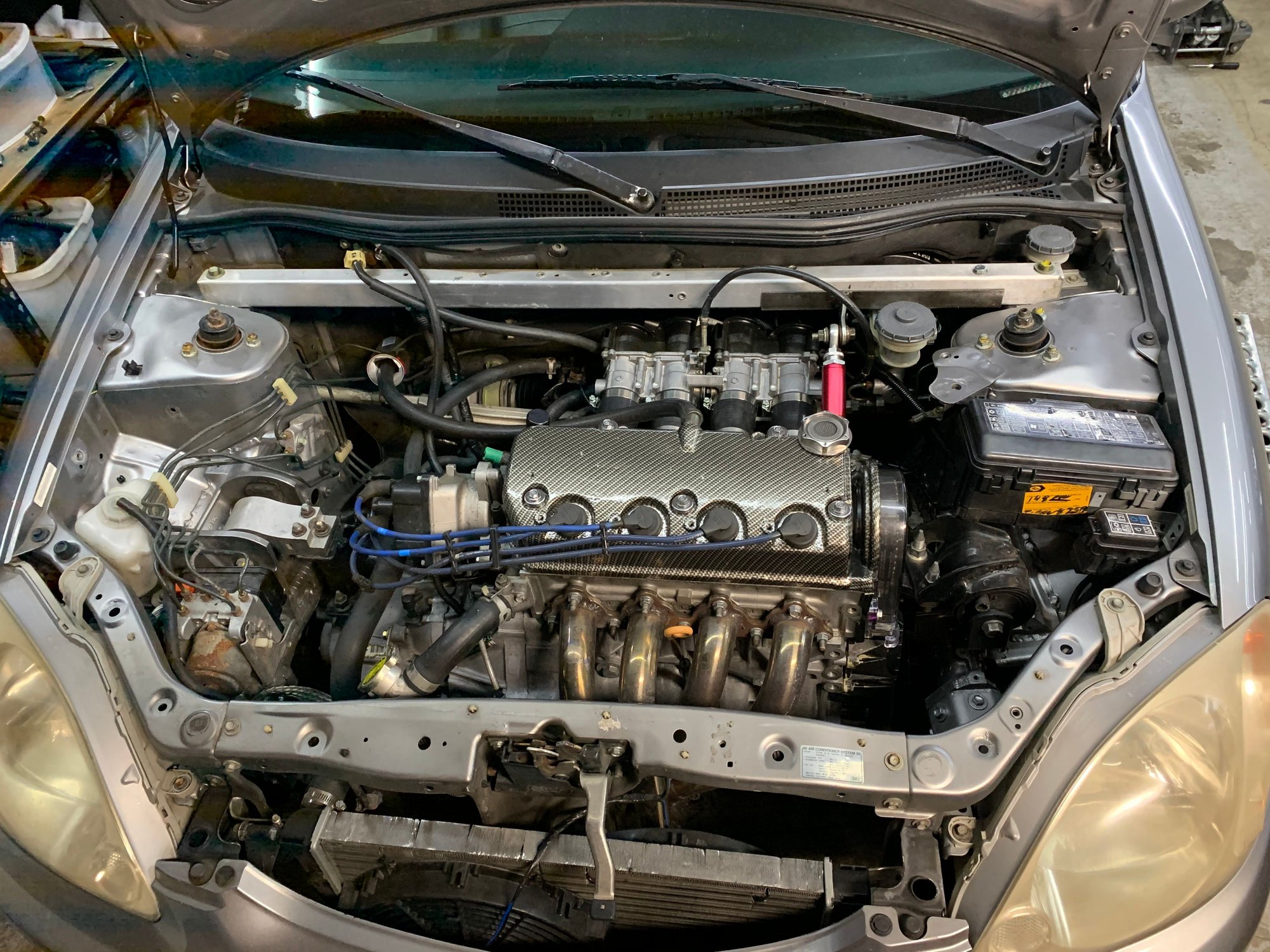

Started on my d series swap. First pic is crx hf axles next to insight axles. They are just about identical in length, share the same putter spline to the hub and should be a plug and play solution without having to change out the hubs. I'll post some detailed pics of the mounts once I get cracking on them. As for wiring it was pretty simple for the most part, I'm using a 2000 civic ex harness, the cool thing was the obd2b ecu plug a is almost identical besides pin a15 for the fuel pump relay needs to be moved to a16. There's a few connections from the stock insight harness that goes to the chassis harness, most of the wires needed were fairly easy to identify, wires like starter solenoid, ign pwr, ground, reverse lights and so on.
Old 08-08-2019, 10:34 AM
  #33
K7-1Ktrevor's Avatar
Join Date: Mar 2008
Location: Salem, Or
Posts: 5,382
Received 36 Likes on 35 Posts
Default Re: My new daily 2000 Honda Insight.
It’s up and running pretty well. Had a few issues and still have a few kinks to workout. It’s considerably faster then one of my buddies k20a3 swapped ef hatches lol.

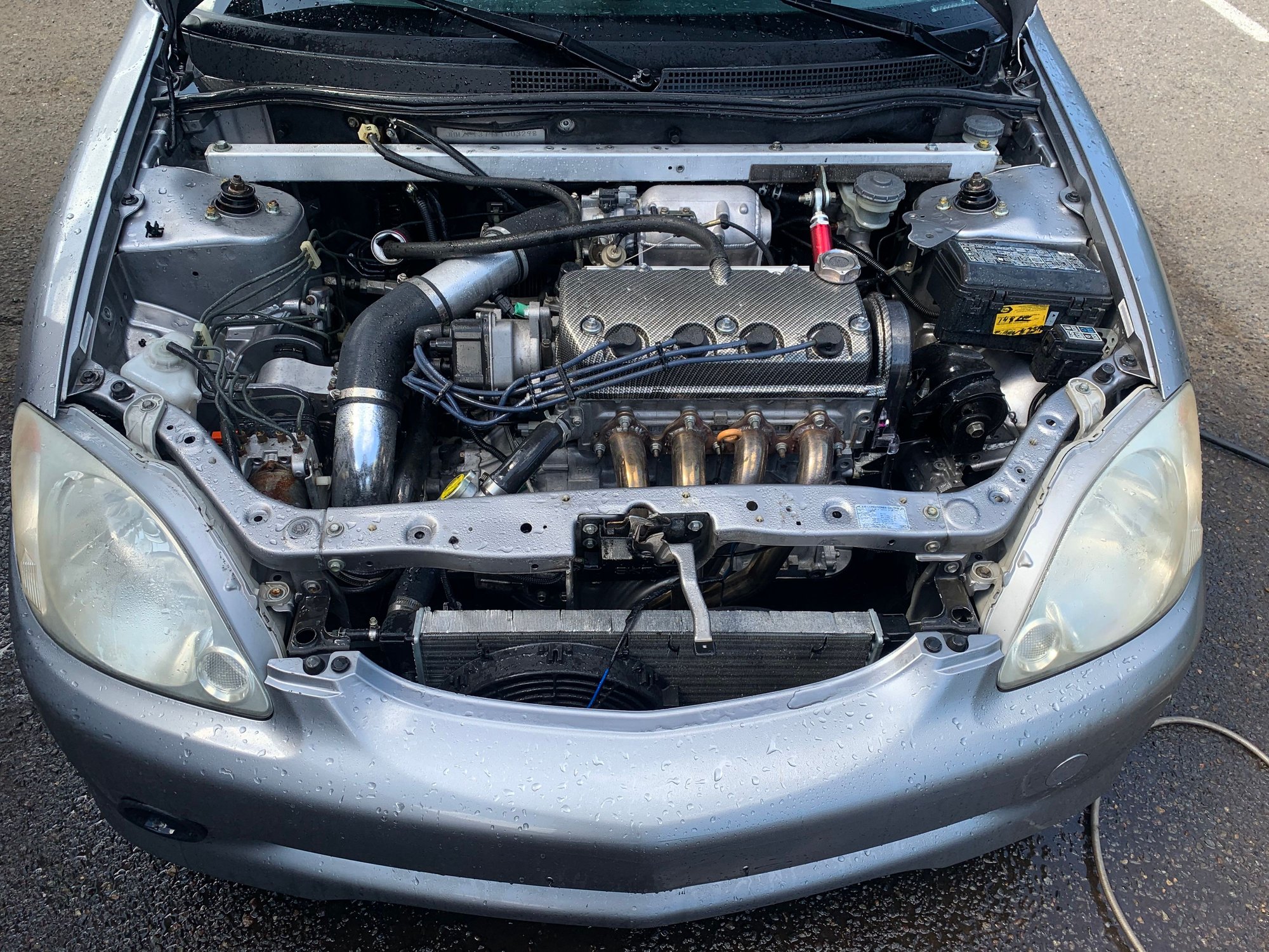

Did you ever take it to the track? I would love to see what that N/A beast could run in the quarter! I just finished my D-sight turbo setup in mine, but on a stock Z6 with 4.5psi, yours is probably still quicker, lol.
Also, what did you figure out with your axles? I ended up using axles for an 84 Civic, they are about an inch shorter on each side than the CRX HF axles.
