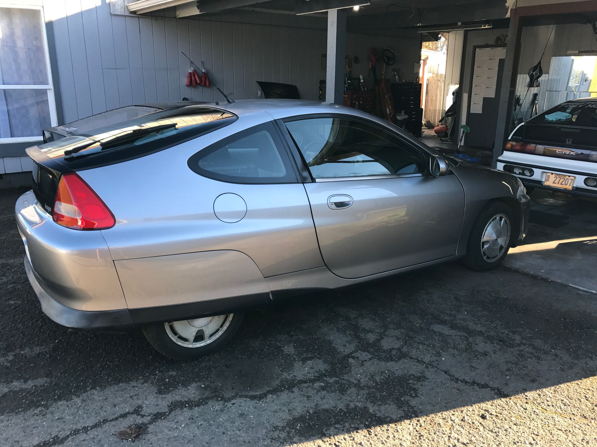

After searching for about a month I was able to come across this 2000 Honda Insight, 5 speed manual with ac and cruise control. I was able to pick it up for pretty cheap ($1400) due to a non charging ima battery. It has a 174k miles and overall is in pretty good shape. Driving my Escalade at an average of 16mpg over 20k miles this last year has killed my wallet. This car should pay for itself in savings in about 6 months. I travel all over oregon to do mobile tuning as well as I enjoy the outdoors allot, hiking, camping and just taking road trips for fun. Due to bad ima battery it was not charging the 12v battery so I found a write up online about cutting two wires for the dc-dc converter and sure enough that fixed it enough to be able to drive and charge. I plan on removing the ima battery, bcm and mcm to help reduce unnecessary weight as I just plan on using the car on the gas engine. I would love to build a lto battery pack down the road but that will depend on total price of the battery conversion. Other option would be a k20 swap with an accord 5 speed but that will be down the road as well. For now I'm enjoying the 47mpg in town in traffic in winter. I've been able to pull mid 70s on the freeway as well.
This car will remain mostly stock besides a few little things. It's getting all mb quart speakers and a single 10" powered sub. I have added a partial radiator block off for winter and was lucky that the previous owner also had purchased a few parts from Honda that were missing/ broken including one of the front splats for the driver side as well as a trunk latch assembly.
So far I've been very impressed with the handling of this car. It really is super fun to drive. It could definitely use a bit more power especially down low since the ima is no longer working but it's still enjoyable to try to pull the most mpg out of the car.

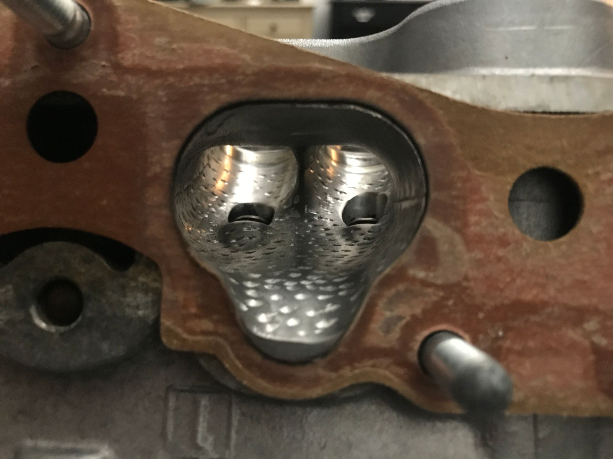

Picked up a d16a6 bottom end, d16y8 head and y8 tranny for $100 total. Been working on the head, ported the exhaust and will be polishing them to reduce any carbon build up. I also dimpled the intake ports to hope to atomize fuel better and did a little blending on the port to valve seat area. Not looking for max flow out of it just hoping to pick up what ever easy power there is to be had from some time with my tools. I plan to have the cam reground so where each right hand side valve has about half as much lift until vtec further aiding the swirl effect that the y8 ports already have. Pretty positive 45mpg in town will be easy to achieve even beating on it from time to time.

You going to send that head off for new guides and a valve job? Those seats are looking tired.
Re: My new daily 2000 Honda Insight.
I have some exhaust that came off a customers Integra that has 3 inline resonators on it I will use for the bulk of it. Also the turbo will quiet it up a good amount.
As for the head ill just relap the valves, verify that they are all sealing and do new stem seals. It's not worth the money to put new guides and seats into it. I've fixed much worse seats that that by lapping valves plenty of times.

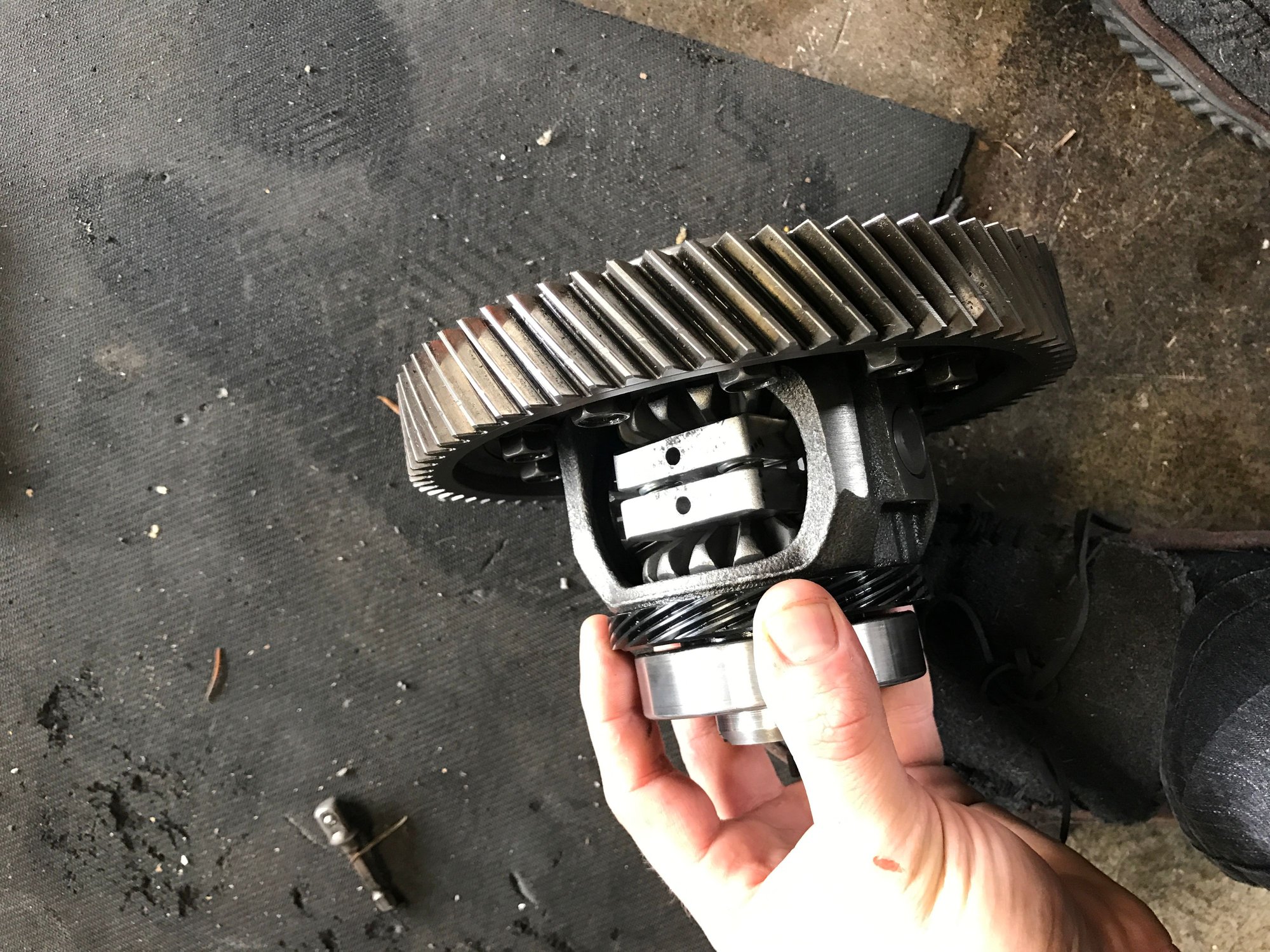

Tore my y8 transmission down to inspect it. I bought it being told the gears were all good but it made bearing noise. I found that only the input shaft bearing needs replaced which I figured right off the bat. I also installed a phantom grip lsd, first time using one so I will definitely give an unbiased review of it once the swap is in. I also steam cleaned the transmission case, it was pretty gross before, I should have taken a before pic. I decided that I wanted to keep the shorter gearing because I do a lot of in town driving and wanted the car to be more fun. I calculated out the difference in 45mpg vs 80 mpg and going from regular to premium and it looks like about an extra $10 a week, I can live with that, anything will be better then this 3 cylinder running in the somewhat limp mode you get from deleting the battery without running an audrino.

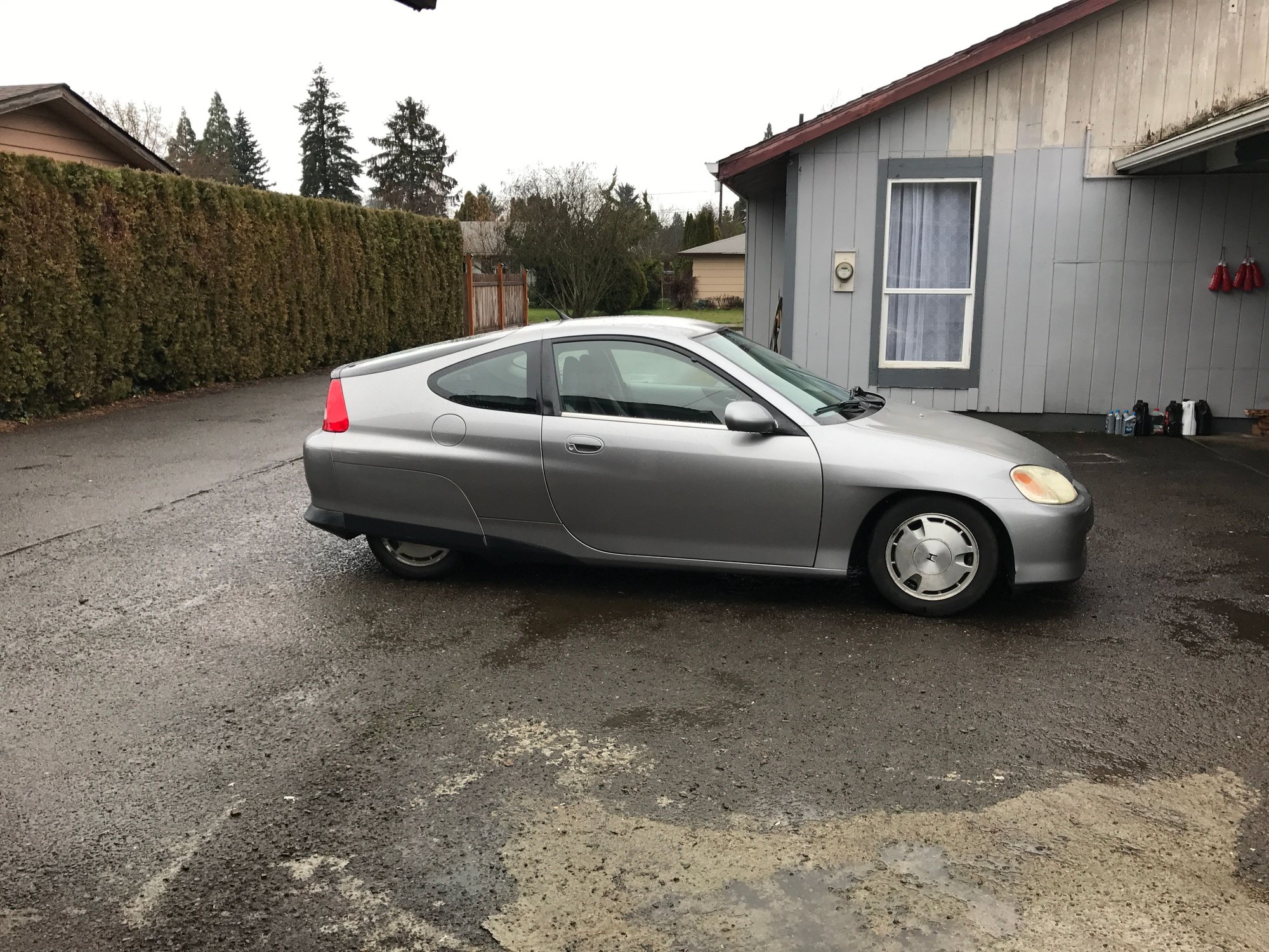

Been a bit since I've done anything to the Insight. Today I lowered it, I got a set of tien lowering springs from a newer Hyundai Genesis and ended up using the rear springs cut in half for the front and rear. Pretty happy with how it sits, the rear spring rate is a bit more then the old shocks can handle. I built some shock extenders so the rear struts are at full extension when the coil springs are just barely touching top and bottom spring perches. Unfortunately I broke the driver side outter tie rod when tightening it too much with my impact on reassembly. New one will be in tomorrow morning so no big deal. Happy it broke when I was putting it back together as it was more then likely already weak.
How much travel do you have to the bumps? And what does that front control arm angle look like?
At factory height they are just about touching the bump stop in the front and the control arm is parallel to the ground. Not ideal. I was looking at fixing the travel issue with a Koni insert but gave up going lower when the geometry was looking like a turd.
