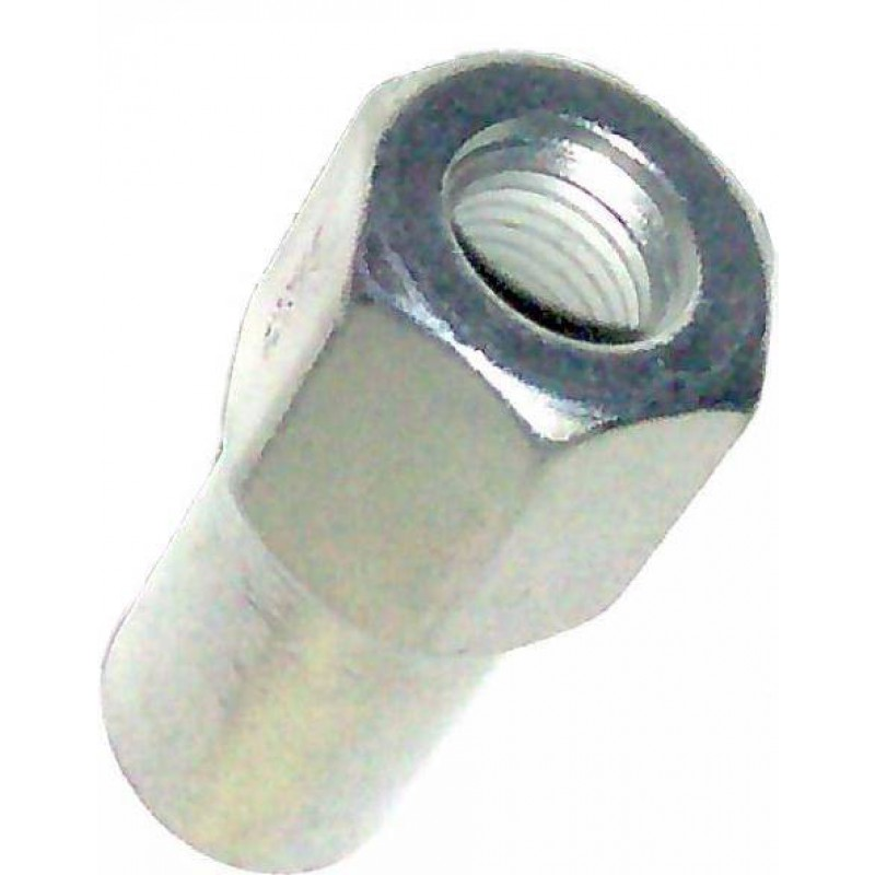

I found that the Nissan GTR exhaust studs fit perfectly and bolted the manifold on today with a dummy turbo and it fits great. Plenty of room for downpipe.

Have you thought about running longer studs so you could put a sleeve between the manifold and the nut to gain more clearance for a nut?
Or a nut with a sleeve built in.

With the GTR studs I have a good 1/2 inch extra for a sleeve. You're right about all the room, after I get it running Im thinking about making a long-tube header into the turbo if I go through with part 2........
