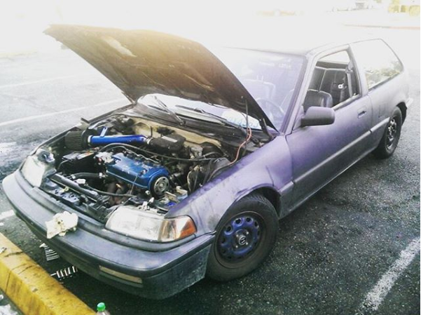

How's the sight of a D15B1 in a 2017 Civic?
It took us all of 3 hours to have the old motor out of the shell and on the floor.
Then it took all of 20 minutes the next day to have the new motor mounted and the axles in.
And boom, after two days, we had finished the swap.

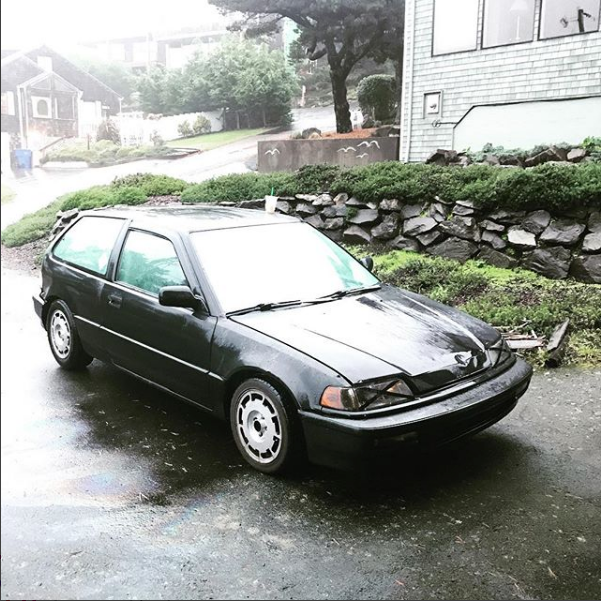

Just two days ago the GF and I made a journey from Tacoma, Washington to Lincoln City, Oregon for Thanksgiving with her parents. I now have to figure out a potential oil consumption or high RPM leak issue (as right before I left I checked all my fluids, and the oil was spot on, and then this morning when I went to go get Starbucks for the family, there was some oil on the driveway (it has been raining so, it could have been a lot, could have been a little that just spread out. It wasn't enough to make the driveway slick, I'll say that) and there was almost none on the dipstick. I did get the car up to [redacted] MPH on a long, straight, lonely road on the way to Oregon, but it didn't perform any differently after doing so.
Here she sits right now in the driveway. I actually like the way the P-slots look without the center caps more.
