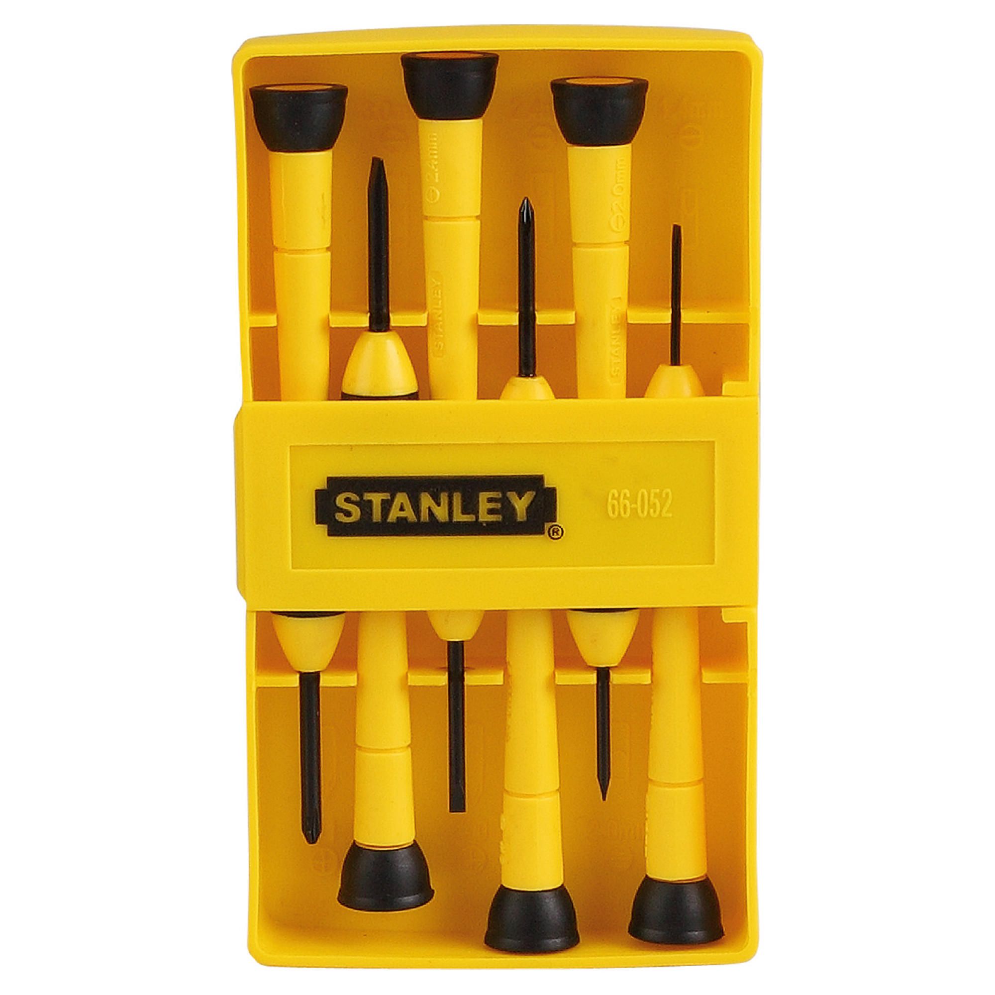

No probs, i use the small flat head that comes in these stanley screw driver sets. Makes it a piece of cake:
I'm sure there's other ways to release the pin clips but this one worked well for me.
