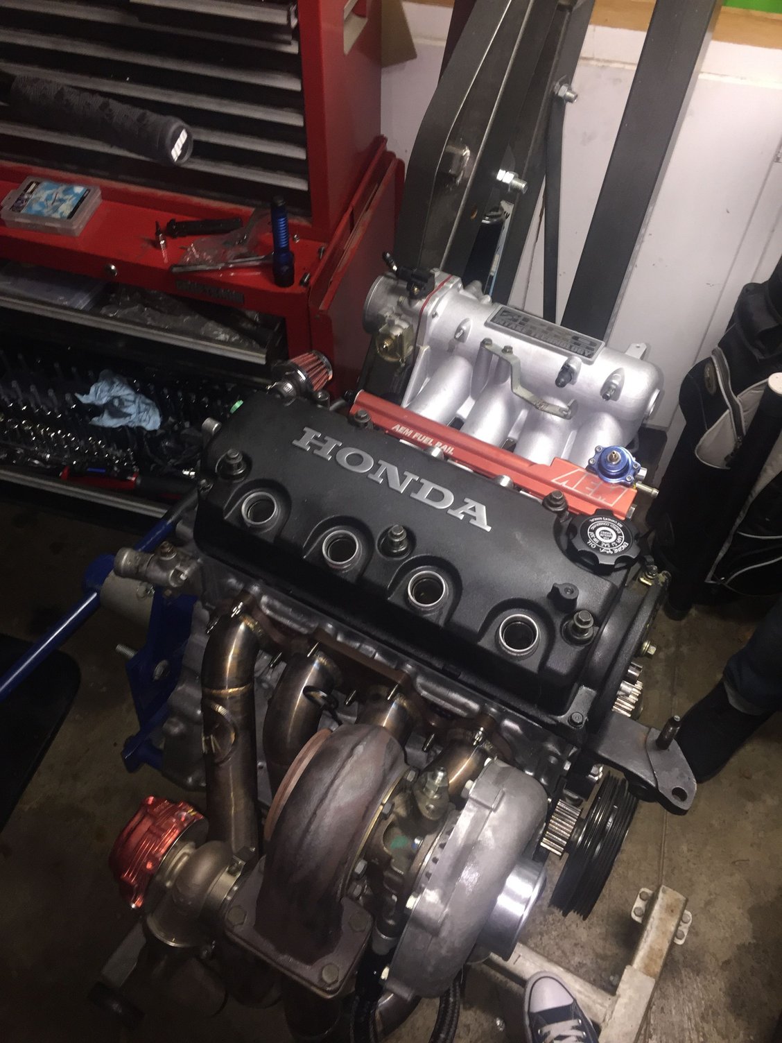

Back from the dead with an update. New block is done and built by Ngoc at synergy auto works. Here we have 10.5:1 compression srp pistons on eagle rods. I had the head ported by a buddy of mine and then took it to Felix at Apm to do a valve job and throw new seals in it. Just waiting on motor mounts now and back in the car we go.

Spent the day putting this thing back together. Set up is 75.5mm vitara pistons on a set of fj rods head will go on tomorrow

The long block is back together now. I wanted to change out the cam gear so I’m waiting to get one ordered before I put it back in the car.

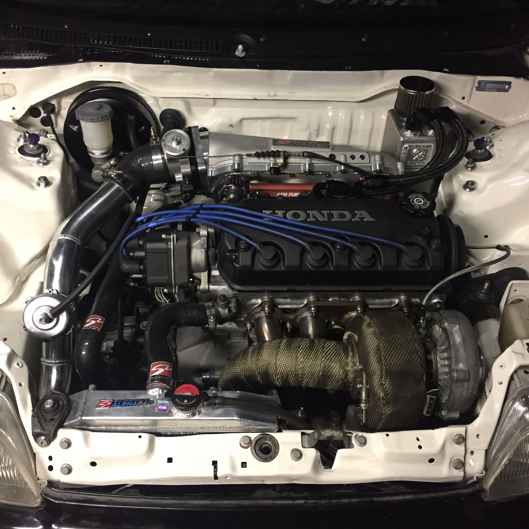

Here’s my issues I’m running into. I can’t seem to get anything to fit in this area. I guess that’s why you don’t see these manifolds on a rhd chassis
Old 01-19-2018, 06:57 PM
  #116
boibuddha's Avatar
Join Date: Feb 2015
Posts: 42
Default Re: SNOWWHITE V2 build thread
Couldn't you get around this with a 3 inch 45 degree silicone elbow?
You may have to bend the brake lines a little bit to prevent rubbing, but it doesn't look like a show stopper.

That is currently what i have and it still does not clear. Ended up redoing the front brake line with a banjo bolt and actually machining down the adapter plate and it barley clears

Had a buddy of mine machine down the throttle body adapter to crest as much room as possible
Old 02-06-2018, 04:41 PM
  #122
dwils's Avatar
Join Date: Sep 2010
Posts: 271
Received 19 Likes on 12 Posts
And this is what we came up with. There is probably a couple centimeters between the coupler and the banjo bolt. We are not sure how well it will hold up but we are going to try and see
