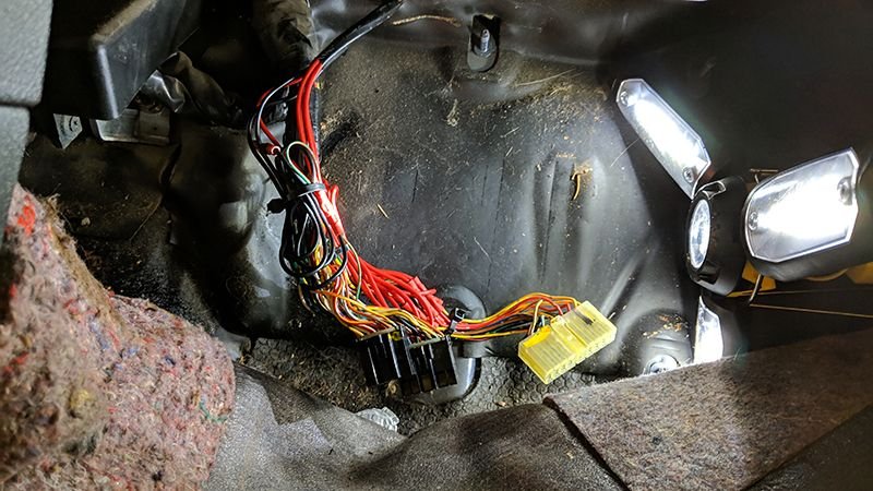

Got the pedal assembly installed last night. I completely spaced that you have to pull the dash to do it, so I got the whole pedal assy unbolted (minus the top bolt) then realized you have to remove the dash. ha ha Here are some pics though. Also got my new shift **** and obd1 jumper harness in too.
What a mess - ha ha
Dash is out
New pedal assembly is in
Dash is back in
Shot under the dash of the new pedals cause you guys have never seen this before
All that's left - remove auto shifter and put in manual shift linkage
My new shiny ****
OBD1 Jumper Harness

Not that pulling the dash is super hard, but for future reference, you can swap pedal clusters without pulling the dash. To get to the last "hidden" bolt, you just have to drop the steering column and pull out a piece of duct work. You have to flex said piece of duct work, but it's thin and soft enough to bend out of the way to get it off the fresh air / flapper box and the heater control unit. You can also get rid of the blue shift interlock box under the driver's seat - the PM6 ECU won't communicate with it any longer. Good progress - it looks just like the interior of mine...same color.

I was wondering what that box was under the seat. My old ex didn't have it so was curious. Going to see if I can shampoo the carpets and clean up the interior some now. Glad I pulled the dash though - made it easier to put the new pedal assembly back in and hook up the cables.
That blue box is what triggers the ignition interlock that prevents you from pulling the key out of the ignition if the auto shift lever isn't in park.

Yeah, I'm going to be jumping the wires for Park and the Clutch switch. And then using a P06 chipped ecu. I've got a moates ostrich and data logger so I can fine tune my daily driving after the mpfi conversion.

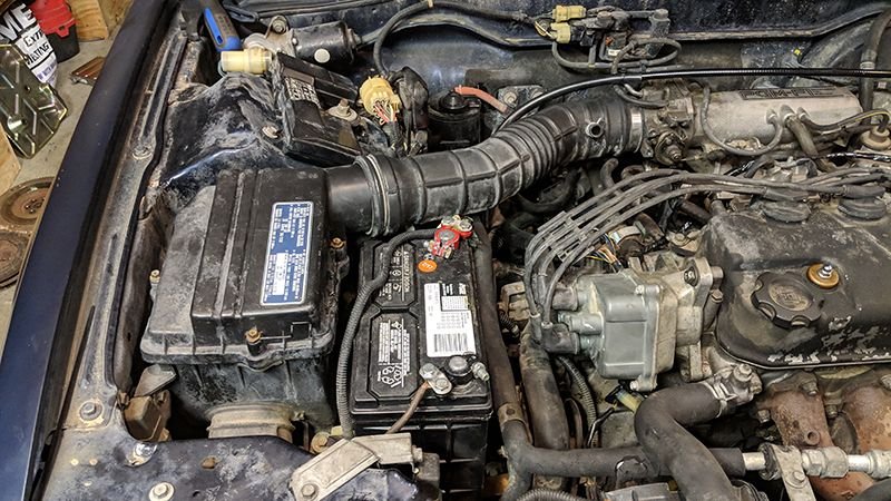

Pretty much have the sedan back and running now. Got a lot done over the weekend. Cleaned up the interior, modified the factory air box to work with the mpfi intake manifold (see pictures), got the DA drivers seat in, fill trans with fluid, installed starter, fired up and got everything idling and running good after mpfi and obd1 conversion. Somehow I got B10 and B12 backwards for the CYP sensor. Not sure how I did that, but easy fix. No check engine light now. Idles at 750rpm almost on the dot. Only things I have to take car of now is the rear engine mount has a ton of play, so I'll be ordering a new one and putting that in even though I hate working on the rear mount - the shifter movement is more annoying. Enjoy the pics!!
Before cleaning
After cleaning
How the air box was before modding
Where I cut the air box
How it fits now
A little tight on the back, but manageable
Before I put everything back in - carpet is still dirty, but will tackle that later.
Engine bay all put back together.
Interior all put together.

Looks good. I did the same thing to my stock air box - had to use the flexible intake tube from an EG, but it fits and looks great IMO.
