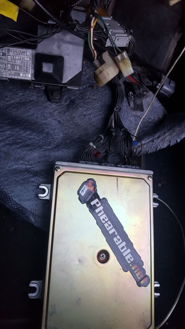

Hey I'm having trouble trying to start my car after doing my swap. I'm thinking it has something to do with the wiring but I'm not sure how to go about it. I'm going to list some specs and what I have found out so far. Later on I will also post some pictures of my set-up/wiring.
-1990 civic si (b-series)
-0bd0-obd1 rywire harness
-when turning the key the main relay clicks but I cant hear the fuel pump priming. (brand new walbro gss341 fuel pump)
-starter is good checked by jumpstarting the starter and the engine turns over
-the day I brought my car to the house (tow truck) while the battery was connected I took off the ecu, the next day the battery had been drained was 12.6V next day was 5.8V. (not sue what it means)
-checked for continuity on the fuses from the engine bay fuse box and the wires that get tapped to the old harness.
-checked all my 3 grounding points
Any ideas will be helpful, thanks in advance.

Still trying to figure out what is happening I'm getting really frustrated can anyone help? I took off the rywire harness and made my own harness, I'll post a picture of the wiring diagram I used. I already figured out why the fuel pump wasn't priming. So at the moment the car cranks but doesn't want to start, I'm getting spark and fuel. I'm getting codes 6 and 21 but they should not stop the car from starting right? Also another thing I'm not sure is if the base map downloaded correctly to the ecu I'm not very familiar with using the Hondata Software. When I plug in the usb to the laptop it sais that the file is in the ecu but it doesn't show me any of the parameters Ill post picture of what I am talking about. I don't have a spare obd1 ecu btw.
