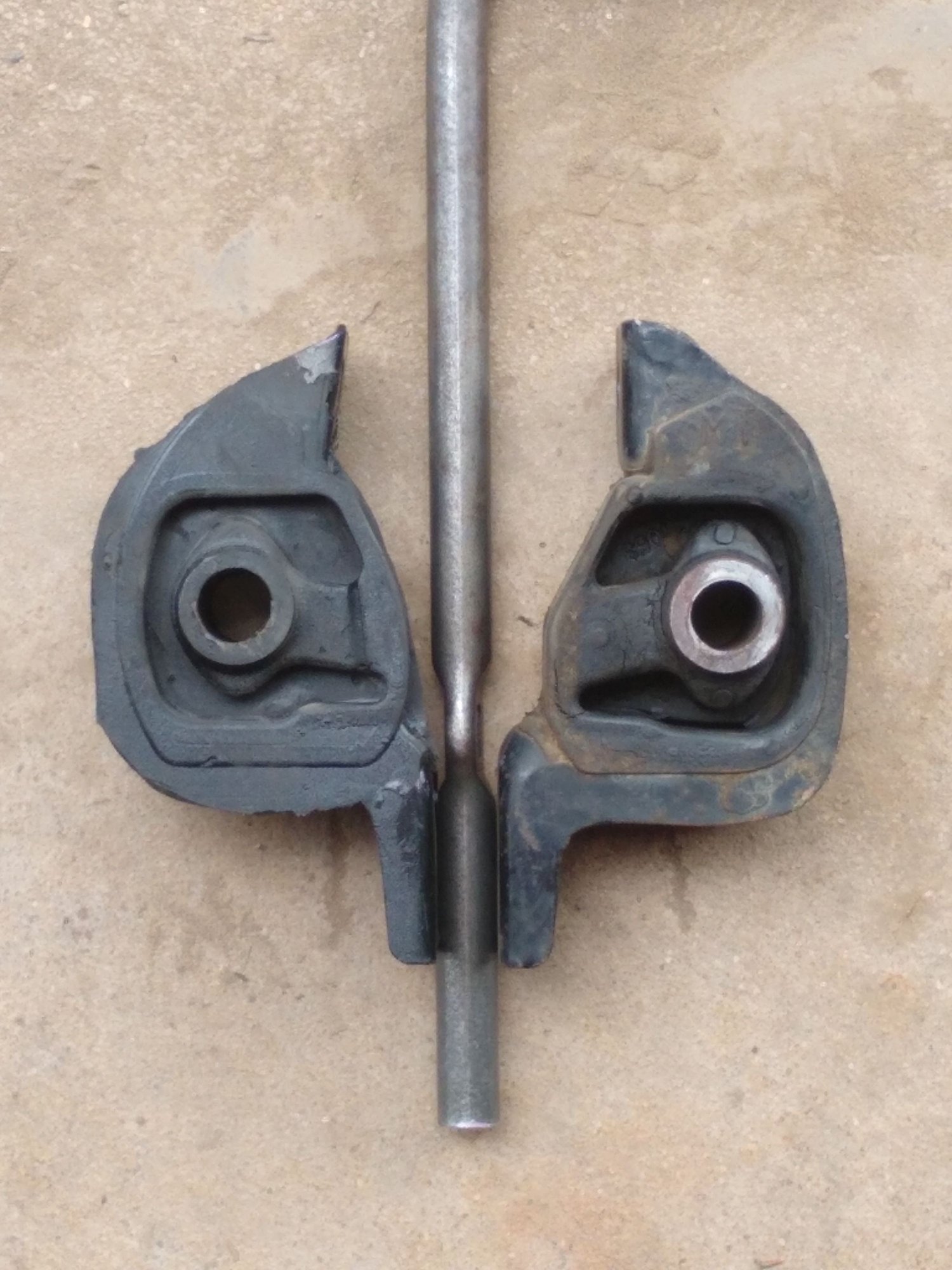

Right side = OEM (with a poly insert to keep it together).
Left side = DEA A6545
The upper tab on the DEA one is definitely off position-wise and in terms of the angle.
This isn't intentional is it? The one pictured is the 2nd one I ordered because I the first one was fucked up and had to return it, but that one also had the angled and weirdly positioned tab.
Would the bolts reshape the little ******?

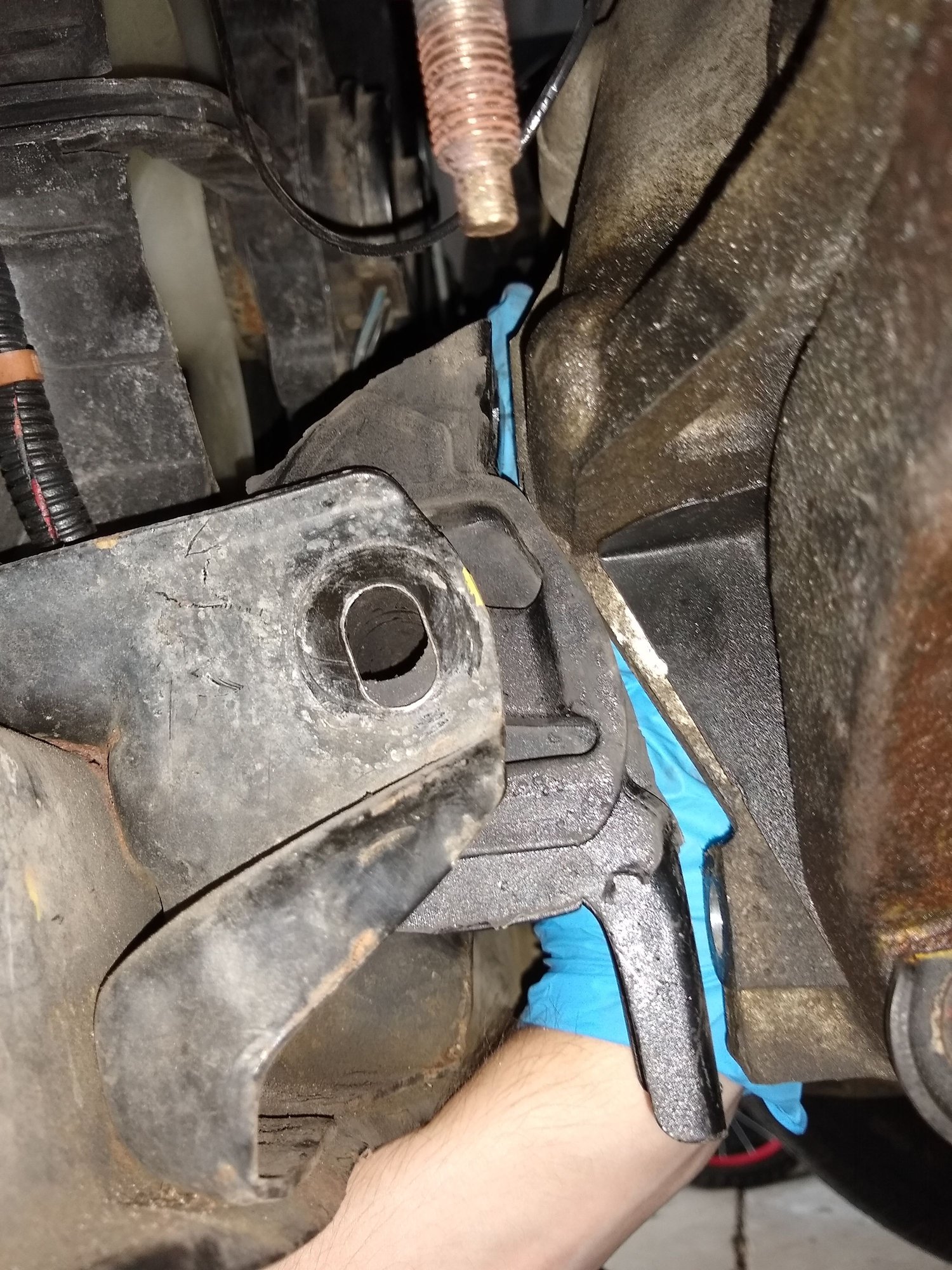

Edit: the metal outside interferes with the MT.
I don't wanna add washers... Nor do I want to grind or shave the mount.
Anyone else been in this situation before?
Bolt holes are lined up in this picture:

Looks like you got a mount for the AT. I ran into this a long time ago; if the parts shop/site you bought from shows compatibility for AT and MT with the same part, they're wrong. Good luck - I eventually gave up and bought Energy inserts.

I didn't get a good pic, but it's much more torn up than the image suggests. It's being held together basically by the poly inserts the previous owner put in.
Since the job is so simple and mounts are relatively cheap, I thought I'd give it a shot in replacing it instead of relying on the bandaid fix the poly inserts give.

st put washers to even out the space.
