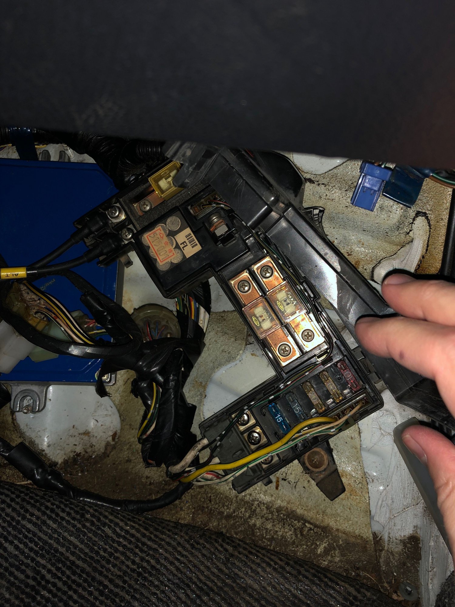

I bought my car with the swap already done, so I can't comment on the actual process of HOW the person did it, i.e. crimping, sodering etc.. On my car it seems like they only lengthened the headlights and perhaps signal wires.. That said I can speak to my specific experience with the fuse-box in the passenger compartment. My car has a RyWire budget tuck harness. My engine compartment fuse-box is located on the passenger side foot well (LHD Car) with a few bolts into the body for grounding and to keep in in place. All the wires going to it also helps position it and keep it from moving.

Relocating the fuse box isn't a big deal as you point out, but I found that I really didn't want my battery in the hatch, so I put it back under the hood, but now I had to find a way to get power to the fuse box. The solution I ended up doing was to run rywire power leads that are properly sized from the fusebox to the alternator and starter. Then I ran simple battery cables from a chassis ground and from positive on the battery to the starter. Also I had to add grounding cables as my PO didn't believe in good grounding..
So overall if I were to start over, I'm not sure I would really do a tucked harness and thus relocated fusebox. I'm more of a function over form person. The form is nice and it looks great, but it seems like more points of failure and more complexity.

Thanks for your feedback. Can you take a pic of the fuse box location? Sounds like a winning spot.

Got a few giant pics of my engine bay fuse box mounted in my passenger side footwell. Hope this helps.
