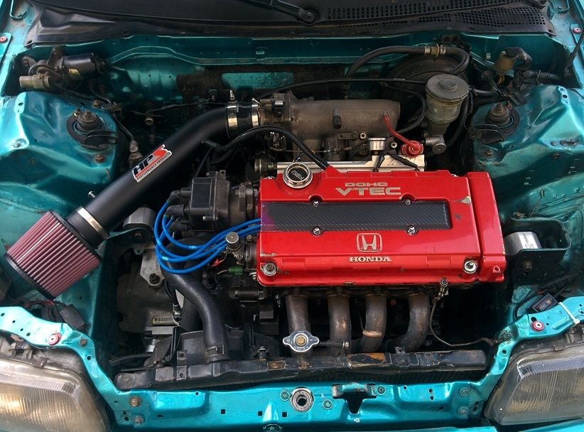

Hey All,
So starting to put some ideas together for my new street/track toy. Mainly looking for handling not so much straight line speed but want to make sure the engine stays healthy and reliable.
You will see in my signature the current bolts etc the car is running and from the picture below you can see what I have to work with.
Stage 1 Plan: Get rid of the junk
The car has some chipped ECU that I want to replace ASAP and get a Hondata and retune. Before hitting the dyno as you can see from the picture, the radiator is a piece of **** and the headers are beat to hell on the bottom.

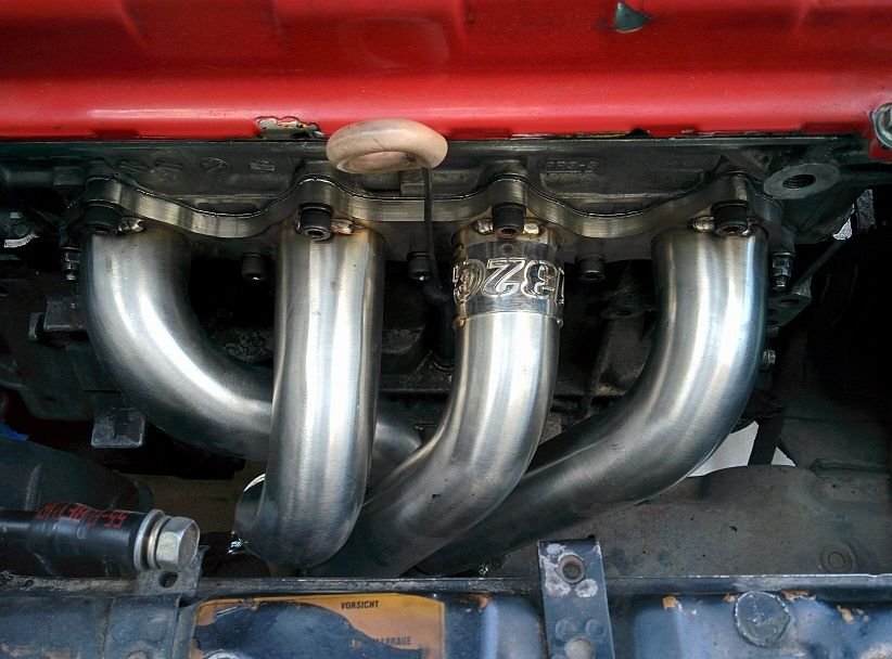

Since the car is back to being reliable again decided it was time to install the headers.
Is open header at the moment but have a Muffler ready to go on and have organized a local shop to fill in the gaps with 2.5 inch. (Hopefully this week)
I also managed to get my Air Duct/Light installed, doesn't really fit the style of the car atm but I haven't really touched any body/aesthetics yet.
And also finally dropped the hammer on some new wheels, tire's hopefully arrive this week.
Sltipstream 15x7 +40
Tires coming are BF Goodridge Sport Comp 2s 195/55/r15

I got the tires mounted and took for a spin around the mountains.
Sorry for quality of pics my camera is potato.
Unfortunately didn't get time to complete the exhaust so still running just headers atm. Way too loud but will get that sorted in the next few days.
