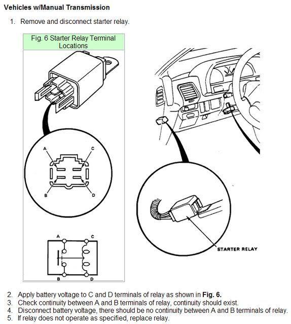

From what you described, the clutch switch is not working. Not sure if it will solve all of your problem, but it needs to be remedied.
It isn't ECU dependant at all.
The switch runs in line with the starter relay. If you don't push the clutch, then there isn't a ground feeding to the starter relay.
(If your car was originally an automatic, then it would have the neutral safety switch built into the gear selector that pretty much does the same thing.)
And then the starter relay...
