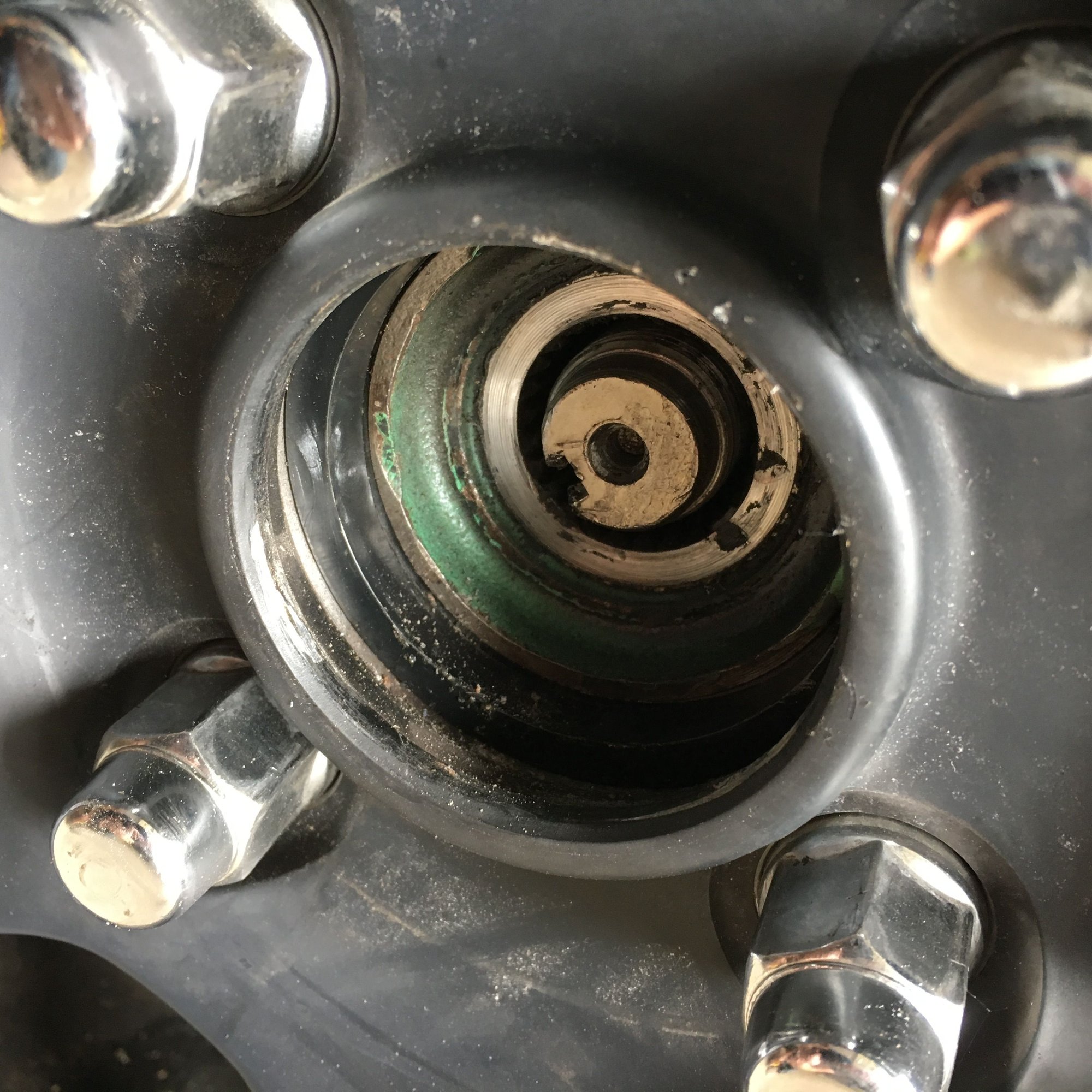

Measured my axles today the way the video says to. They are definitely a little long (these being 90-93 axles)
Roughly 1/8" long drivers side and 3/8" passenger side. Most of the shudder I feel is from the passenger side.
I am definitely ordering a set of 86-89's and will compare them. I've heard the inner splines are different somehow, so it may be necessary to swap the inner joint with the 90-93's. I'll post up once I get em.
Passenger
Driver
Passenger
Driver
