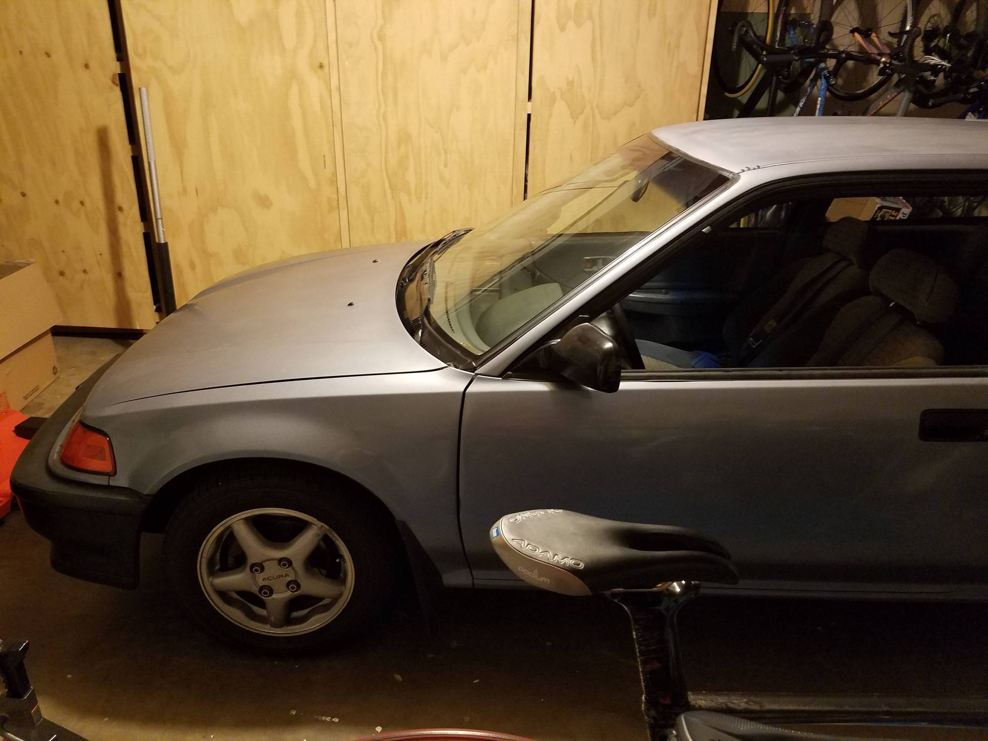

I started looking around Craigslist, and stumbled on this '90 EF Hatch with a BAR'ed B18 swap, so I went to test drive it. Now, I may have jumped the shark a bit, and probably overpaid a bit as well, but I was just stoked to be driving a very raw and lively hatch. The car was $2k, with a salvaged title (previous owner said it was from someone hitting the door in a parking lot), and the ad said firm so I didn't really haggle. Previous owner showed me the recent alignment numbers, and smog numbers, and it all looked good. The interior and exterior were not in perfect condition, but it seemed to drive pretty well. I looked at it on a rainy evening, which in retrospect was probably not the best idea. But after the test drive I decided to buy it and drove it home the same evening. Once I had it in the daylight and had a chance to commute a bit in it, it definitely showed a few flaws that I may have missed
Drove it to work the next day
Back in the garage

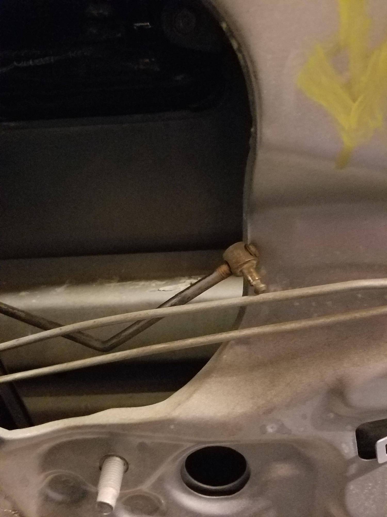

First problem with it - the door latch stopped working just after I got it home.
There's my problem, this guy won't stay in his bushing
Popped out the old bushing, it looked pretty worn
Ordered a new one for $2 + shipping
Popped the sucker back in there... but it was adjusted too low and wouldn't open the door. And the new bushing was doing its job really well. So I had to take out the handle entirely to unscrew the thing on the end of the rod a bit. Whoops. Works great now though!

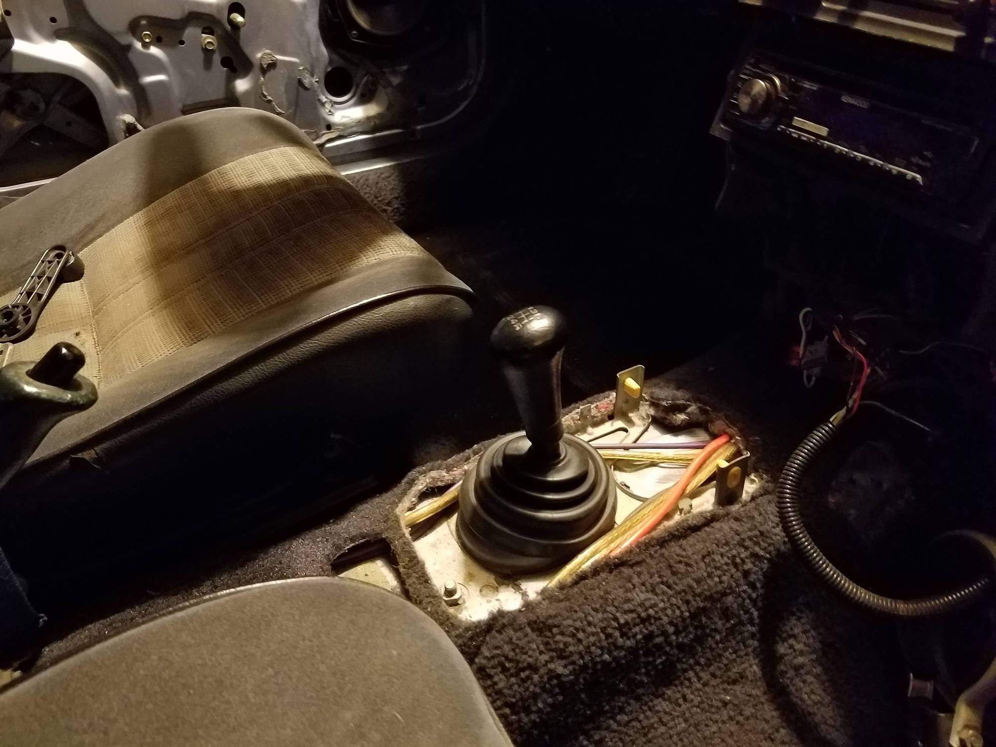

In the process, started to try to pull out wires to clean them up a bit. Shift/brake cover removed...
Another angle. Pulled the panel radio/climate control cover panel. Going to try to clean up that wiring a bit as well. Car came with a tach that didn't work, so I removed the screws, but still need to trace the wires and disconnect them.
Back in the garage

some pretty strange items on that car like the rear brace and headrests and the front seats, but a good start for sure. keep us updated
and where is the rest of your shifter?? haha
