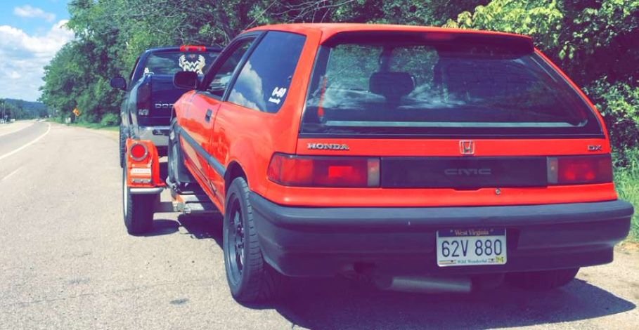

Super clean shell you are starting with, nice wheels too. Looks like a fun project.
