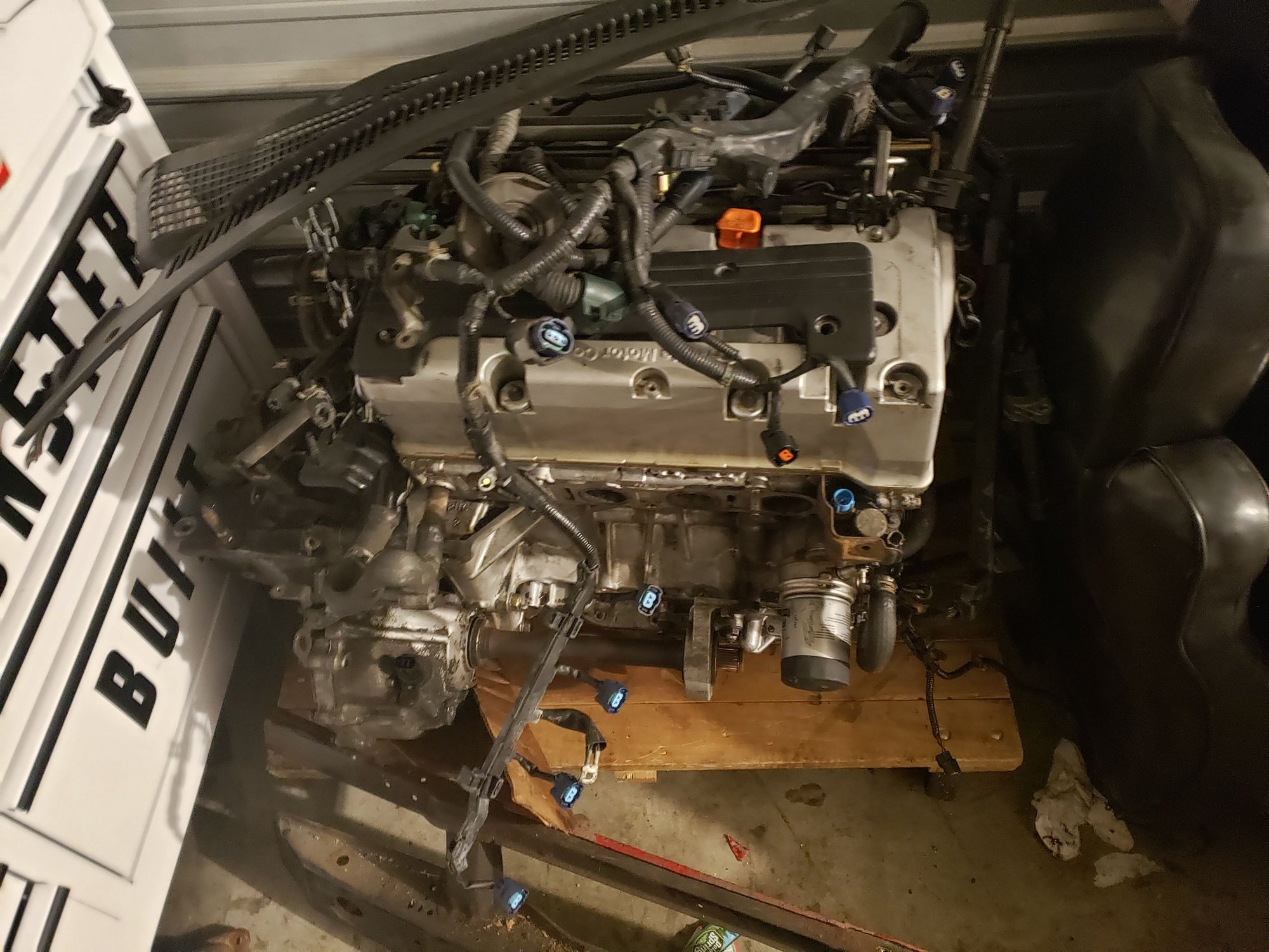

Bought a k20a2 swap!, some k tuned race header, hush performance hydro to cable kit, hybrid racing shifter box and plate,

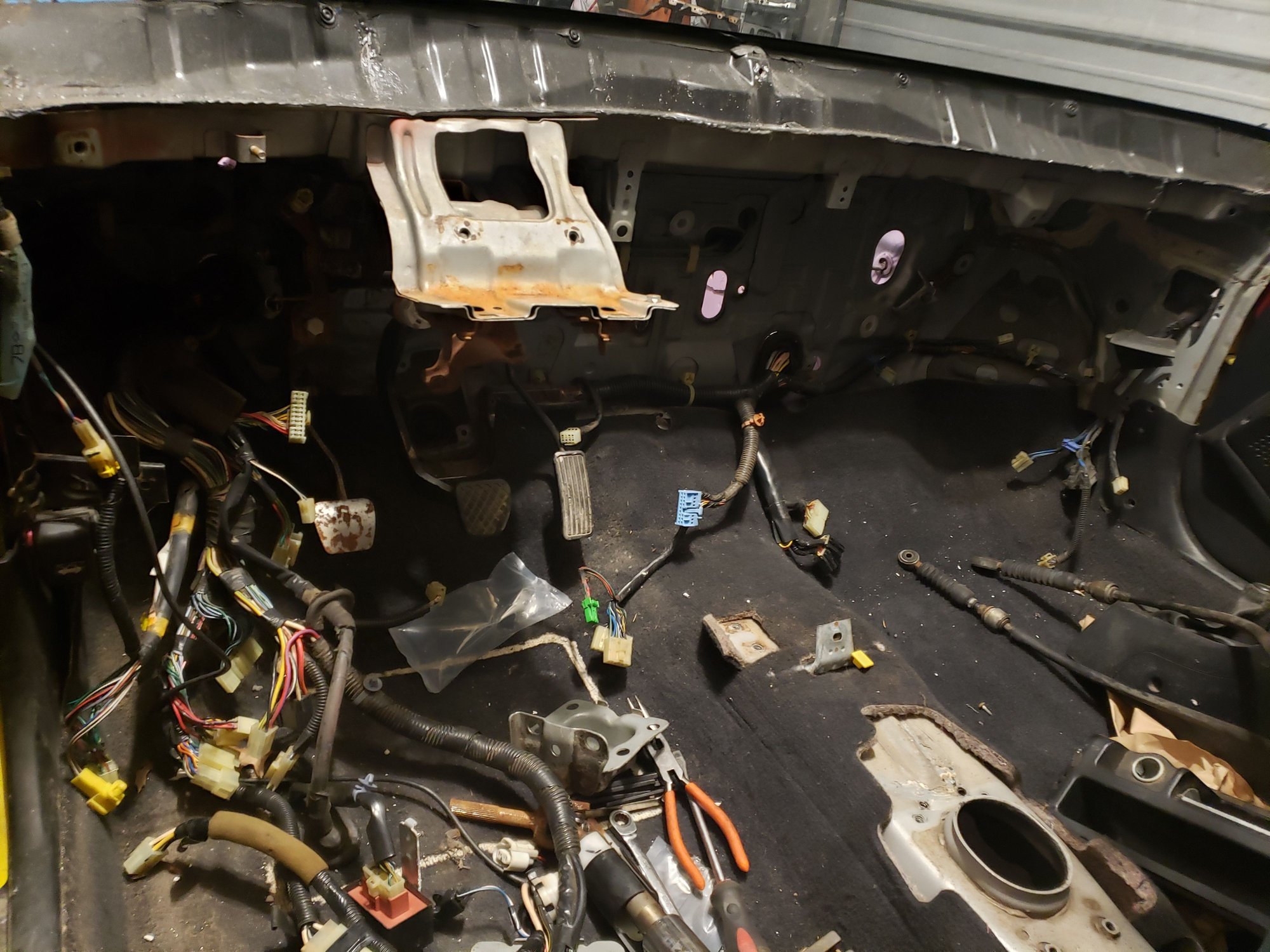

Relocated my brake proportional valve to the firewall, used a Riv nut to get it bolted on nicely,
Trusty riv nut tool, not sure what I would have done without it,

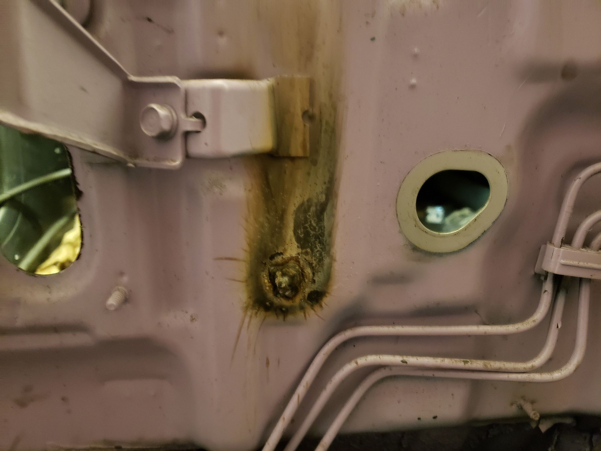

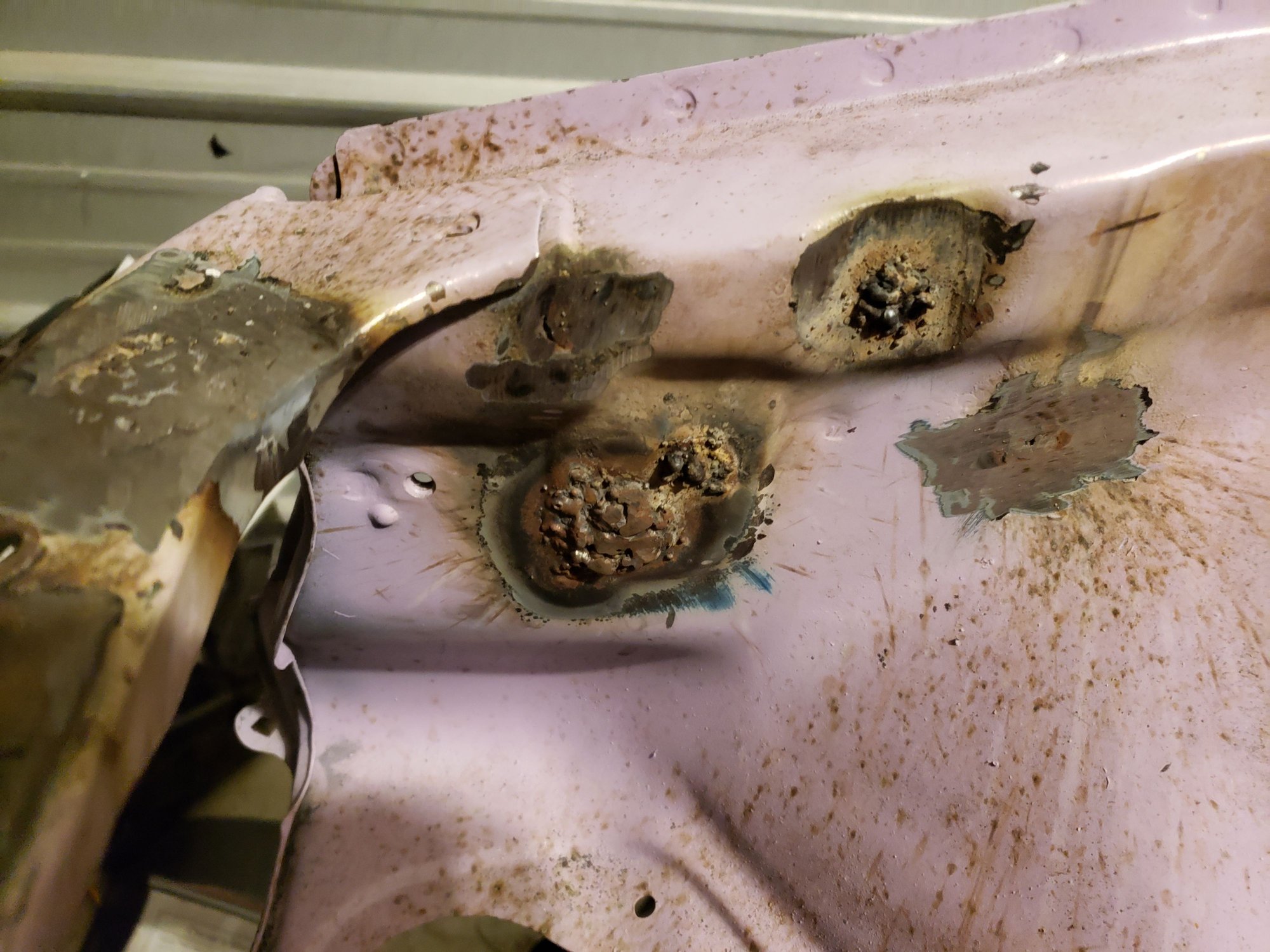

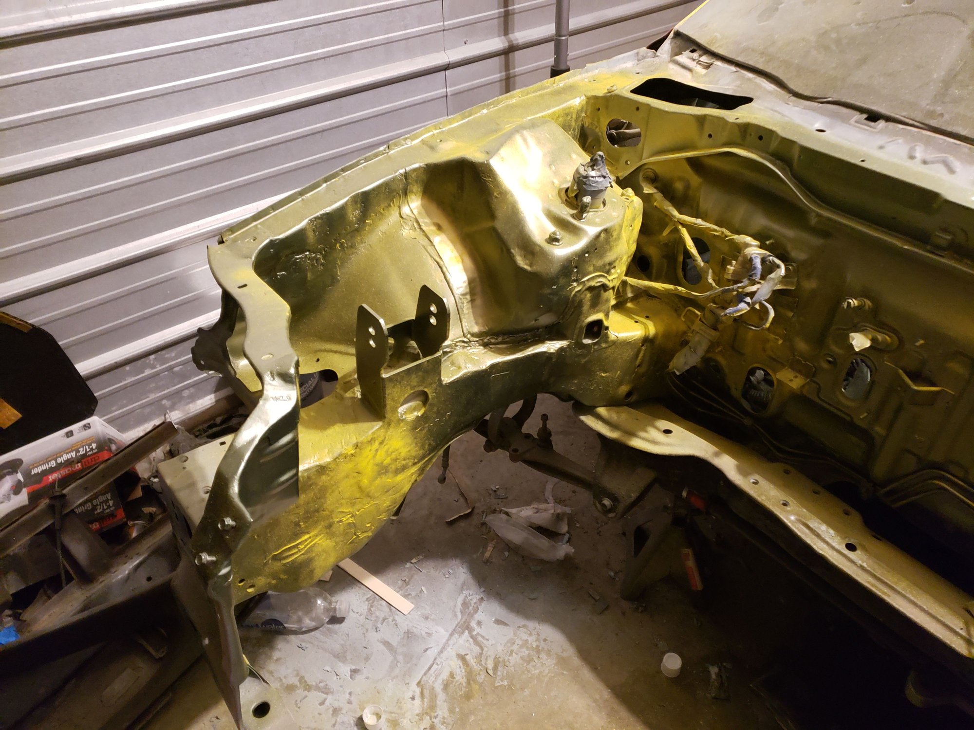

Last owner tried to do a "shaved bay" but didn't clean any of the welds, so I cleaned them all up.
Everything with yellow paint was the \"shaved bay" after gringing it i used the yellow paint to stop any rust that may pop up until i pai t the bay.

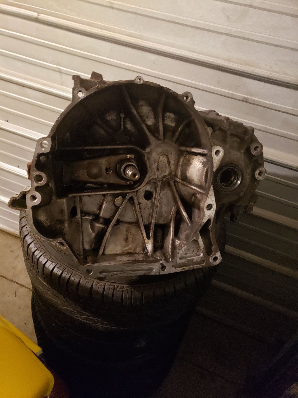

Welp I was stupid and I never bothered checking the condition of my transmission before I put it in. When I put the half shaft in I heard a crazy noise when I spun it in the trans, thank God I bought it from a legit place that offers warranty on these things ! So swap was yanked back out and tomorrow I'll exchange the trans

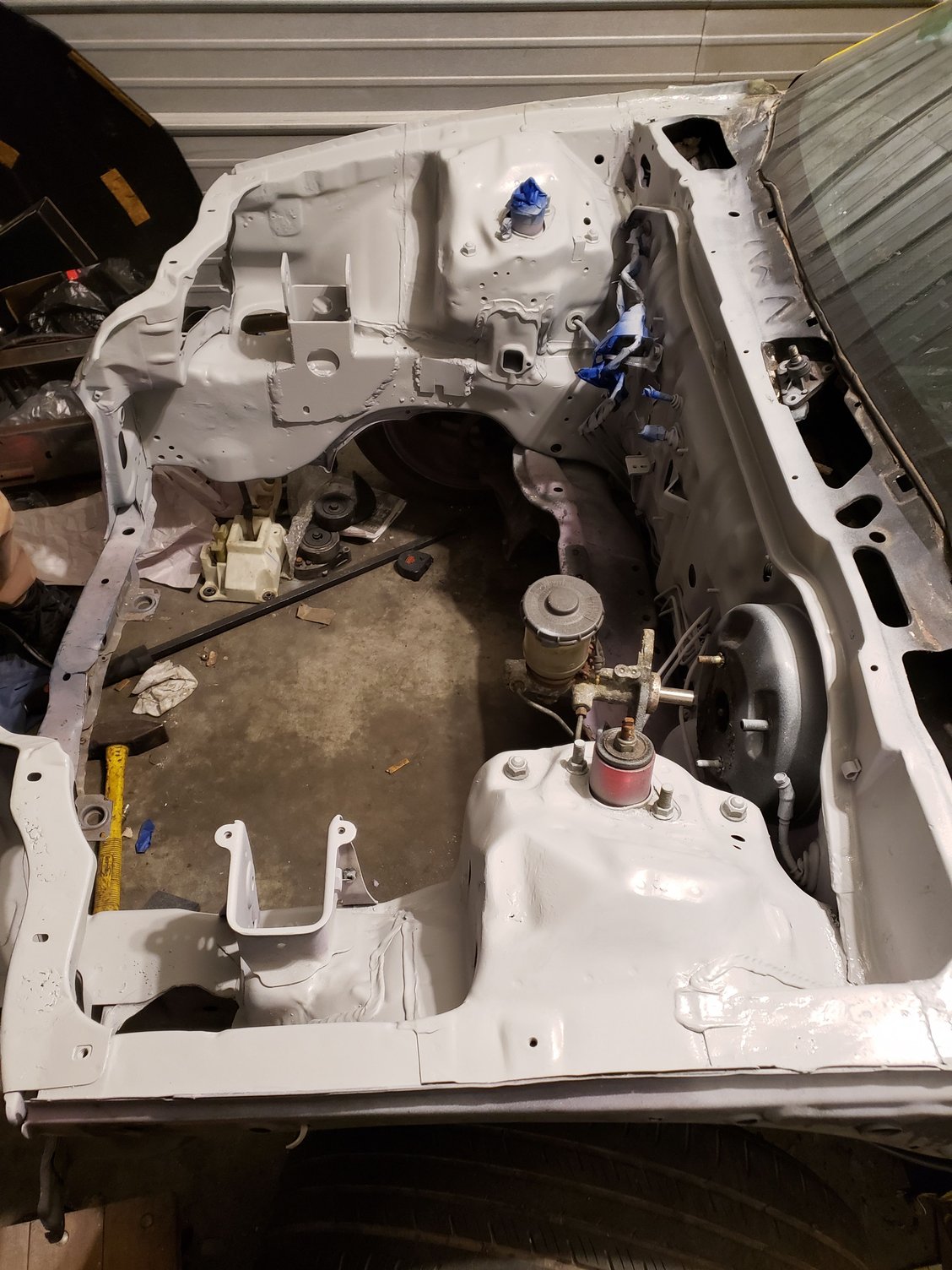

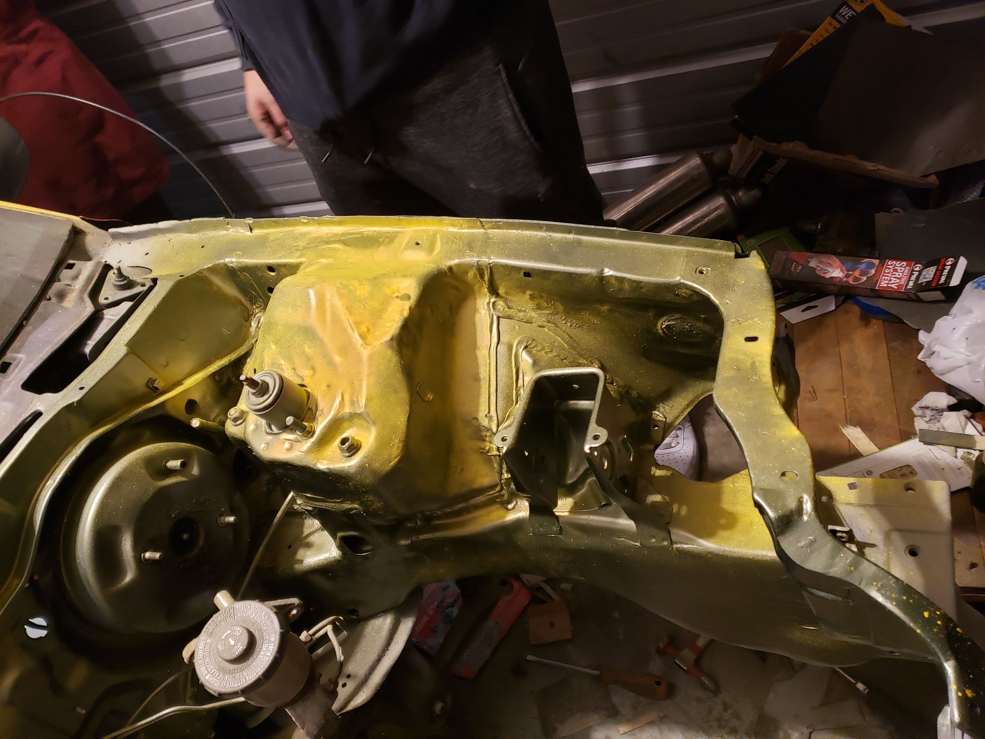

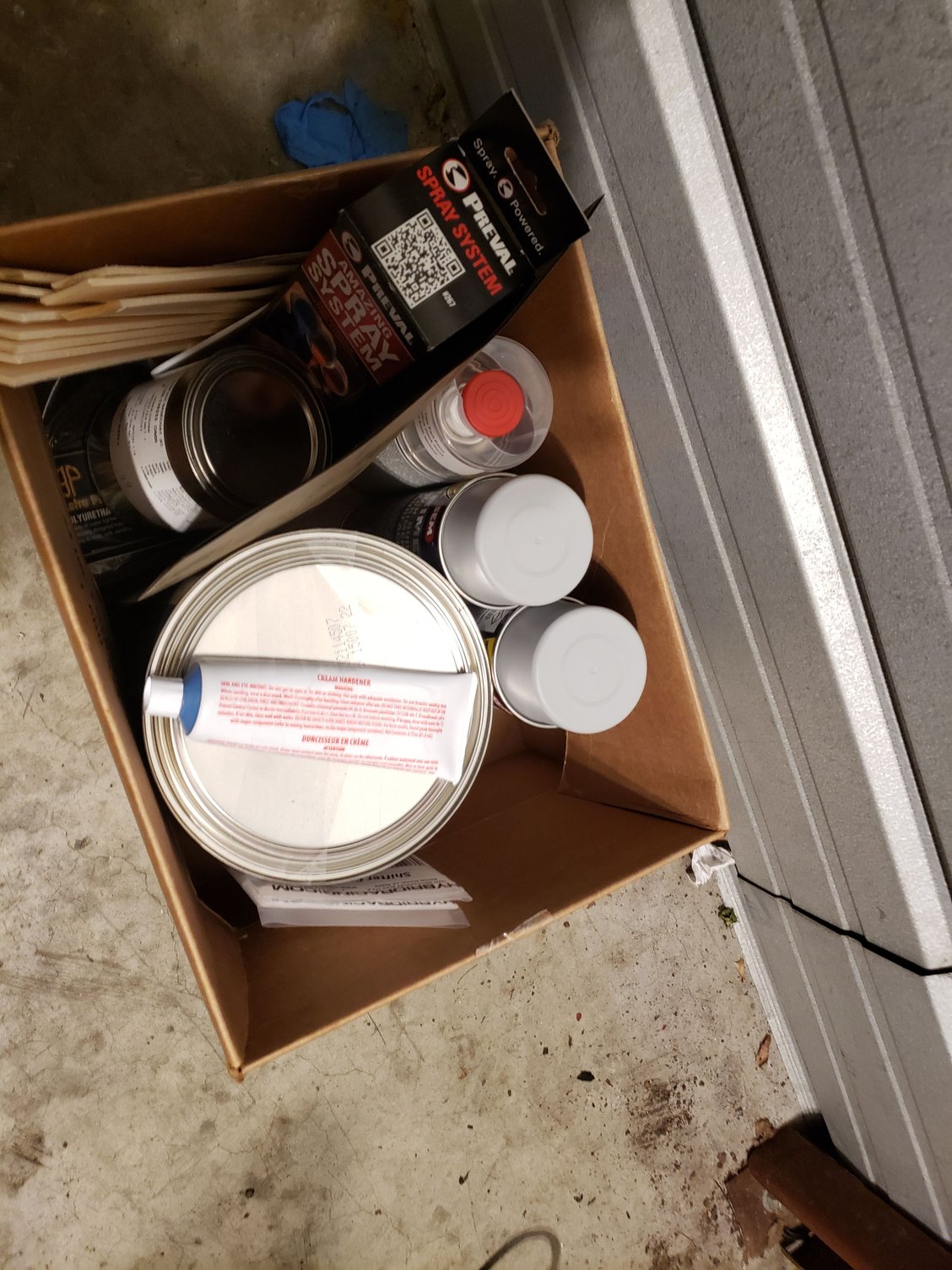

Alright ! New trans is here and it seems to be mint compared to my last one ! (Differential turned out to be bad), so I got the great idea since my swap is out it's a sign from the gods to do my bay, and attempt to make it a **** ton cleaner than it was. So I sanded the hell out of it and threw a coat of high build primer on it. Also I picked out the color of the bay/car, i think its going to be an amazing color for a crx
New type S trans !
Supplies to get this bay in proper order
My brothers a clearly better painter than i am so i let him have at it
Final result of primer before i sand and apply bondo and some more primer to get her ready for paint
Incase anyone likes the color this is the color im using
This will be her final color !
being as how I don't have a compressor we will be using this to paint my entire bay.

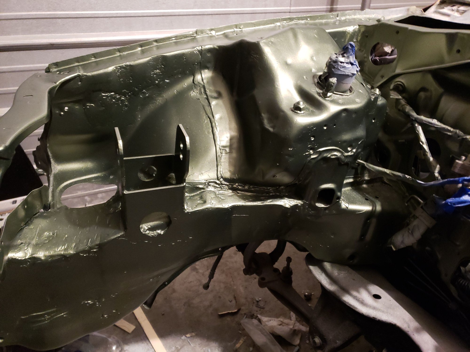

Alright guys, I tried to take enough picture if this process, we applied a rather large amount of bondo and sanded it.... for hours..... it didn't come out the greatest in the world but fair warning we aren't body guys or painters and I refuse to pay someone for something I think I can do myself so I tried my best and I think the fi al result is actually quite nice,
Crappy bondo
More crappy bondo
Primered it some more once i shaved down the 10 pounds of bondo to attempt to give it a nice look.
Paints mixed up and ready to spray
The first coat of the green
The final result of green, actually looks rather nice even tho you cant see any of the pearls .
I ordered this peal so i could legit slap it on and give it a unique look.
Yellow slap
Yellow slap #2
This clear coat was absolutely worth the $30
And i cleared right over the yellow that i slapped on the green and i couldnt be happier with the final result, maybe ill toss another coat of clear tomorrow once it settles a bit

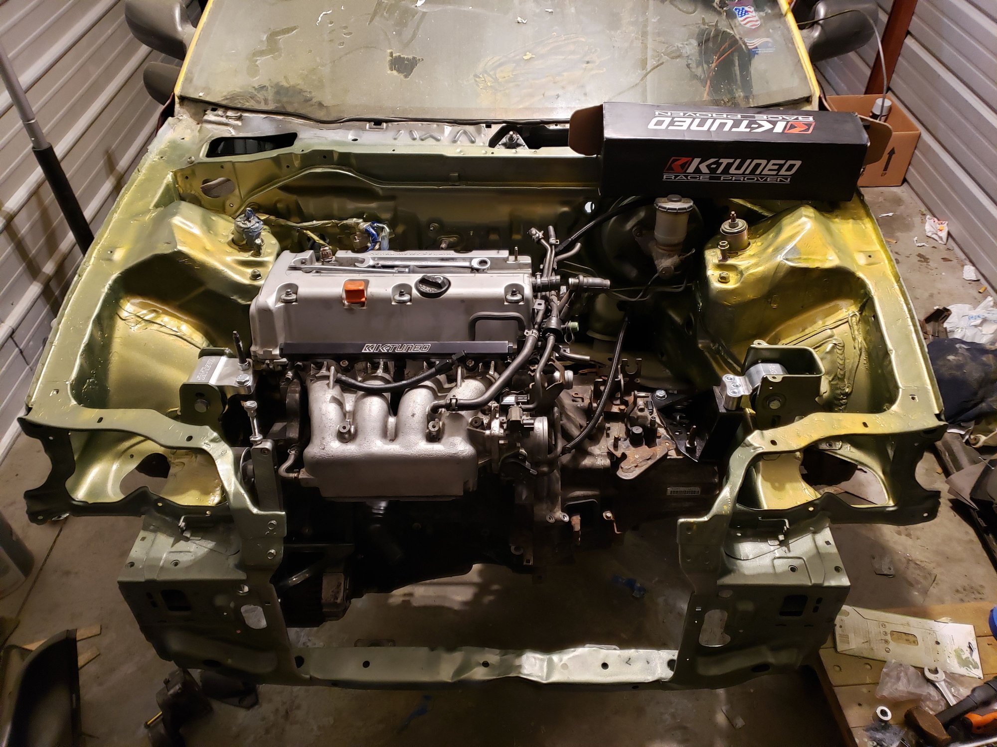

Got my fuel rail in today and decided to put the swap back in the car for the last time.

No offense bro, I understand that you're not a body guy and wanted to give it a try but I think the guy is implying that the bay really needs a lot more work. I mean it's your car and that is cool but it probably would have been worth it to just pay someone to tackle the body work and paint.

He’ll get a second chance when all that unsanded bondo cracks and falls off.

I don't quite understand why weld a bunch of holes closed in the bay, then not grind them down or finish shaving any of them? It just appears half done.
The green-yellow is an odd combo, but it's your car.
Old 11-30-2018, 08:28 AM
monsterbuiltk24's Avatar
Join Date: Oct 2018
Location: Paterson Nj
Posts: 21
Default Re: 1988 crx k20 build thread
last guy welded them 🤷*♂️ and maybe but I like it

bondo was sanded. And if it breaks off then it'll be a learning experience, I'd rather say I did everything on my car instead of paying to have it done, but we all aren't the same I suppose.
