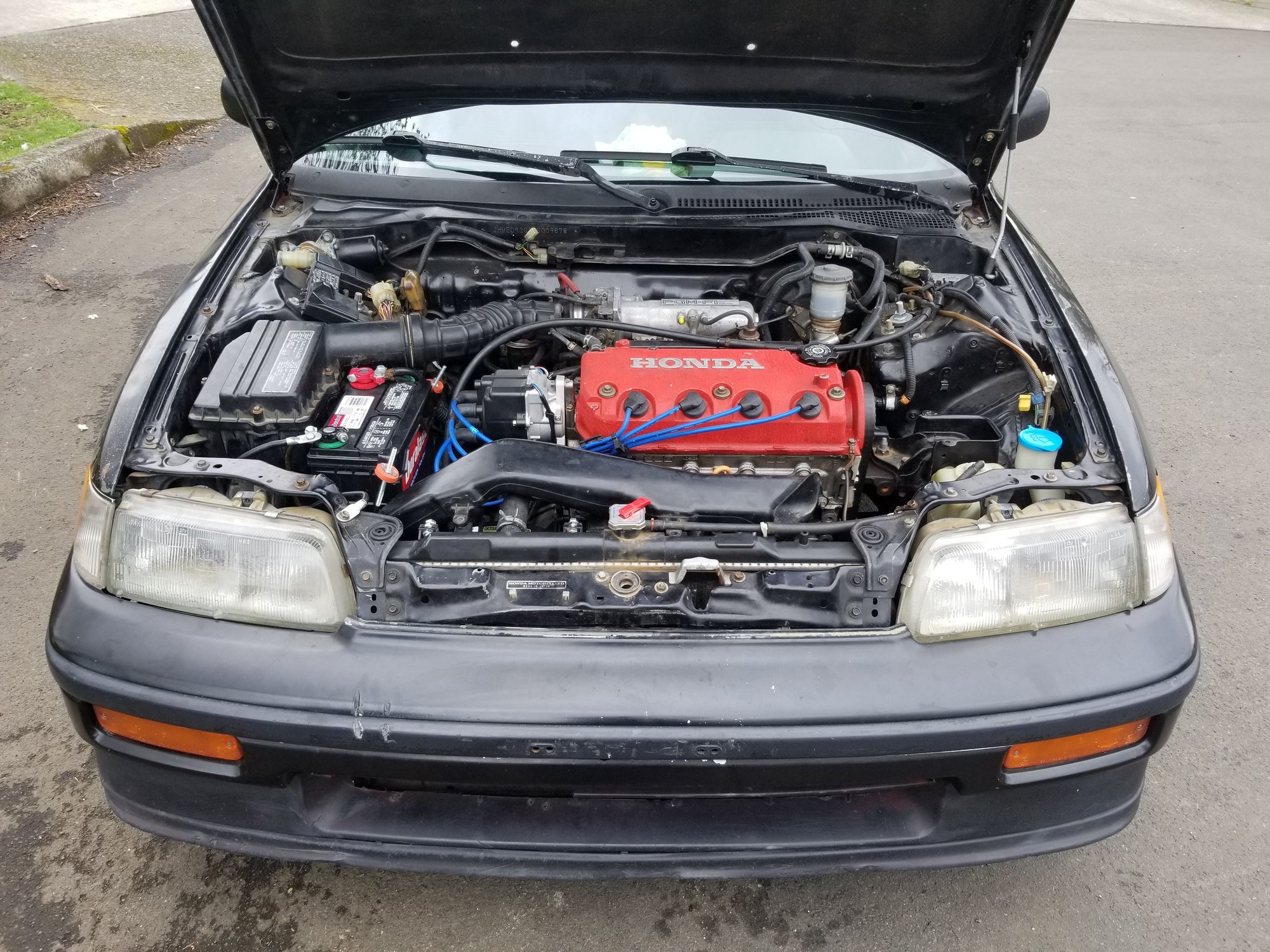

I havent posted in a while but I'll try to make this easy for you guys. I have a 1988 crx si with a y8 mini me running on obd0. my problem is that my crx's idling is currently at about 950 when warm. In the picture (not my car) iv circled two parts I know are missing from my car currently. I can not track down what they are called, I'm hoping it will fix my idling issue. When ever I turn on my headlights on my idling drops about 50 maybe 100, seems normal. When I put my highbeams on it drops to 500 but It doesnt shut off. It maybe raises a little to 550-600 but not much more. I'm planning on replacing a old ground from the head to the chassis but I'm thinking it's doing this because of the missing parts. I just put in a brand new alternator a few days ago and a battery with in the last 7months. The car has no issues starting or holding its idling, it simply drops way to much. Sorry for any unneeded info I'm just trying to give as much detail as needed to get me the best answers. Also I notice there is a vacuum line that goes off of the canister on the firewall, I was hoping to know what that is supposed to connect to. Iv got this car so close to running good. Got it though deq, planning to change to disc brakes all around, and obd1 eventually.

Firewall one is a purge solenoid/map sensor. Did you do a charcoal canister delete? If so the purge solenoid is no longer necessary.
A newer throttle body should relocate the MAP sensor onto the throttle body.
The other looks like the FITV which keeps the throttle body from sticking by coolant flowing through it.

so this is what I have going on, I'm not really worried about the canister anymore (I may replace it later) but this is what I'm seeing that I'm missing. It's a part that bolts to the throttle body but I dont think it's the map. The other picture I have has the map on the firewall like mine but also includes the part that's bolted to the throttle body with a vaccum line going to it from where I have the yellow plug.

Heres a photo of the whole engine bay just because I'm kinda proud of all the new stuff I know iv put on, that it didnt have a few months ago. I notice there is a wire that is cut that goes from my harness to my radiator area near the front passenger side. Any idea what that may be? I dont understand why the person before me took off so many stock parts that ultimately make the car run better. From my understanding lots of things that are or were taken off work perfectly fine even with the y8 cylnder head.

Fast Idle Thermo Valve
I think that is what the yellow cap vacuum line goes too.

Got the car running , new 60amp fuse and I'm back on track. After looking around iv discovered that the yellow capped line goes to a dashpot that helps with sudden releasing of the throttle. I can not find them online at all does anybody have one they are willing to part with?

That intake manifold is from a D16A6, not a Y8.
(Hopefully you were looking the A6 part)
Part number is 16111-PP4-E00
Did a quick search and all the Honda dealerships show it as discontinued
If you can't find one used, this Acura page appears to have on in stock.
https://www.acurapartswarehouse.com/oem/acura~diaphragm~assy~dashpot~16111-pp4-e00.htmlhttps://www.acurapartswarehouse.com/oem/acura~diaphragm~assy~dashpot~16111-pp4-e00.html

Thank you ! . I'll be replacing that asap. This may be hard to track down with out a picture (ill get one when I can) but is anybody aware of a similar dash pot looking part on the front near the radiator? It plugs in electronically but the wire was cut. Is that just more evap stuff? I honestly feel like the person before me asked "what's everything I can get rid of that wont make my car not run". Now here I am going how do I get all this back to how it should be.
