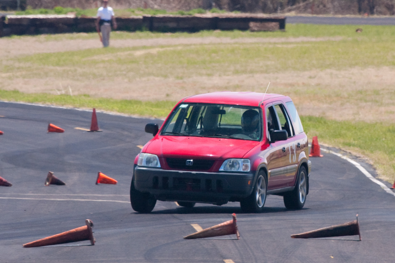

pic: showa/omni
Old 04-13-2009, 05:46 PM
Slebidia's Avatar
Join Date: Jun 2002
Location: OKC, OK
Posts: 107
Default Re: crv with civic coilovers
2001 CR-V
CR-V Konis
CRX Ground Controls with 8 inch 500f 550r
Addco rear sway
16 inch RSX wheels with 225 Azenis

kool thatnk you for the pics. im def going for this. the gc coilovrs are coming to me for free so why not.
